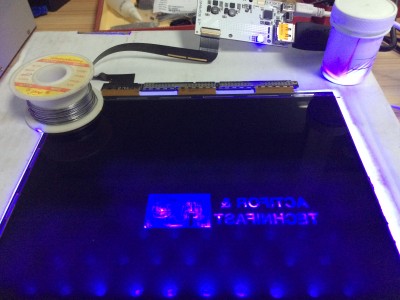

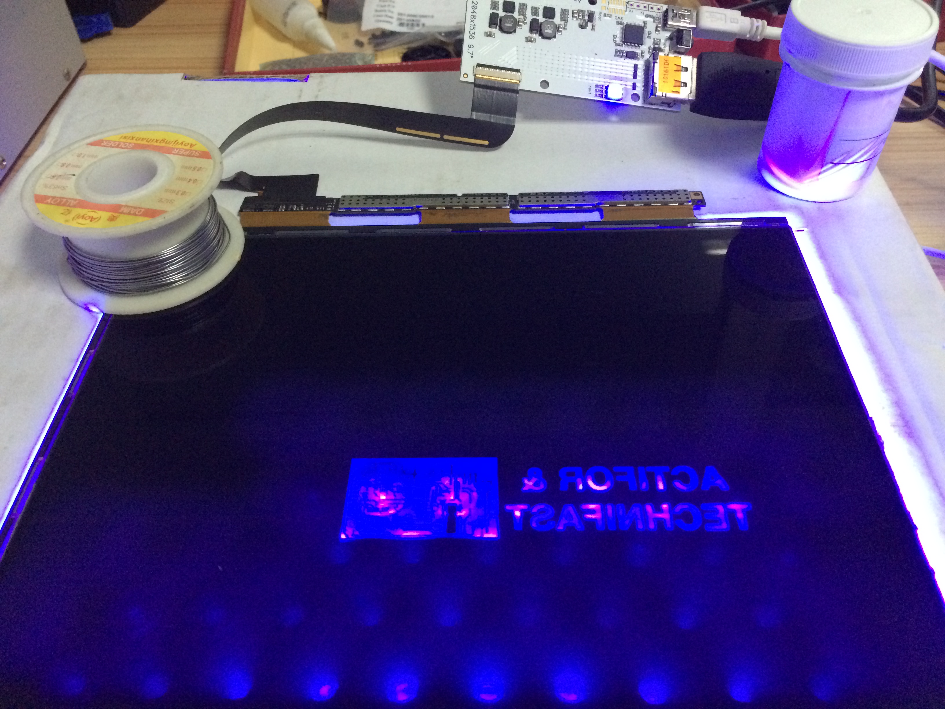

here's a photo of the ipad 3 lcd and control board , my LED board isn't finished yet, only about 32 running ( 1/3rd ) .
- LEDs are 405-407nm 3W , with PC lens about 20˚ angle.
- mounted on a 200x180x50 aluminium radiator
- control board is from abusemark.
My actual problem is the resin, I got only sone transparent UV adhesive , normally designed to work with UV ( 365-385nm). I could get some positive results but with a really long exposure (about 3-4 minutes) , I waiting to receive some SubG+ to conduct more tests .
The LCD need a really good cooling or it will get black (and probably damaged) , got a 120mm fan 140CFM running on the side cooling both LED radiator and LCD panel.

I'm surprised you are getting an even cure with your leds spaced so far apart.  My original array was set up like yours with 15 degree lenses which would cure in between the spaces but would take a lot longer because of it.  My second attempt has the leds stacked on top of each other, but that means I can't use off the shelf metal core pcb's, and that present so many other issues to deal with...  Anyways, curious what your cure times will be when you get your resin with your current set up, I might be doing something wrong.  Please let us know if you could.

Yeah youre going to run into issues if you dont have very uniform even lighting. But good progress!! I tried over a dozen lens types and angles to find the right ones.
