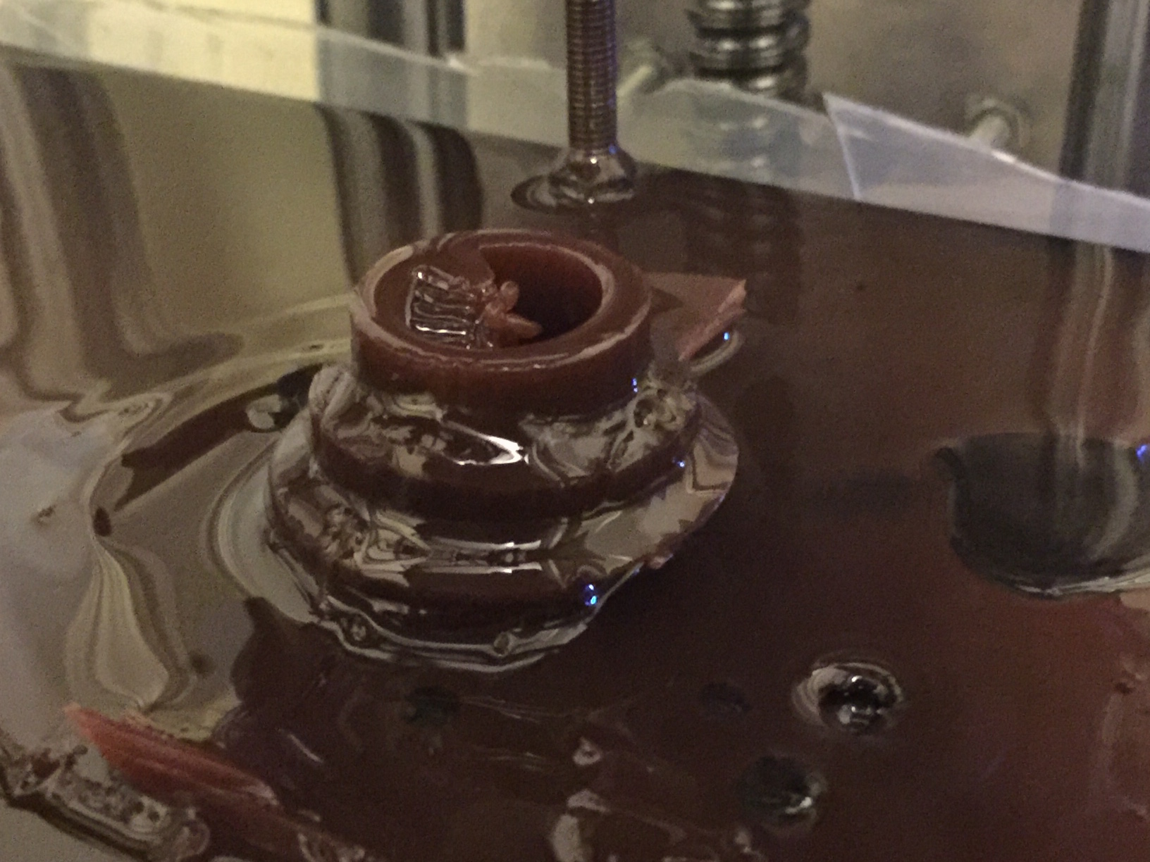

						LaserShark what i have got working.
Re: LaserShark what i have got working.
Can you post a short video or two? I'd love to see this in action. My Galvo setup is currently broken.
