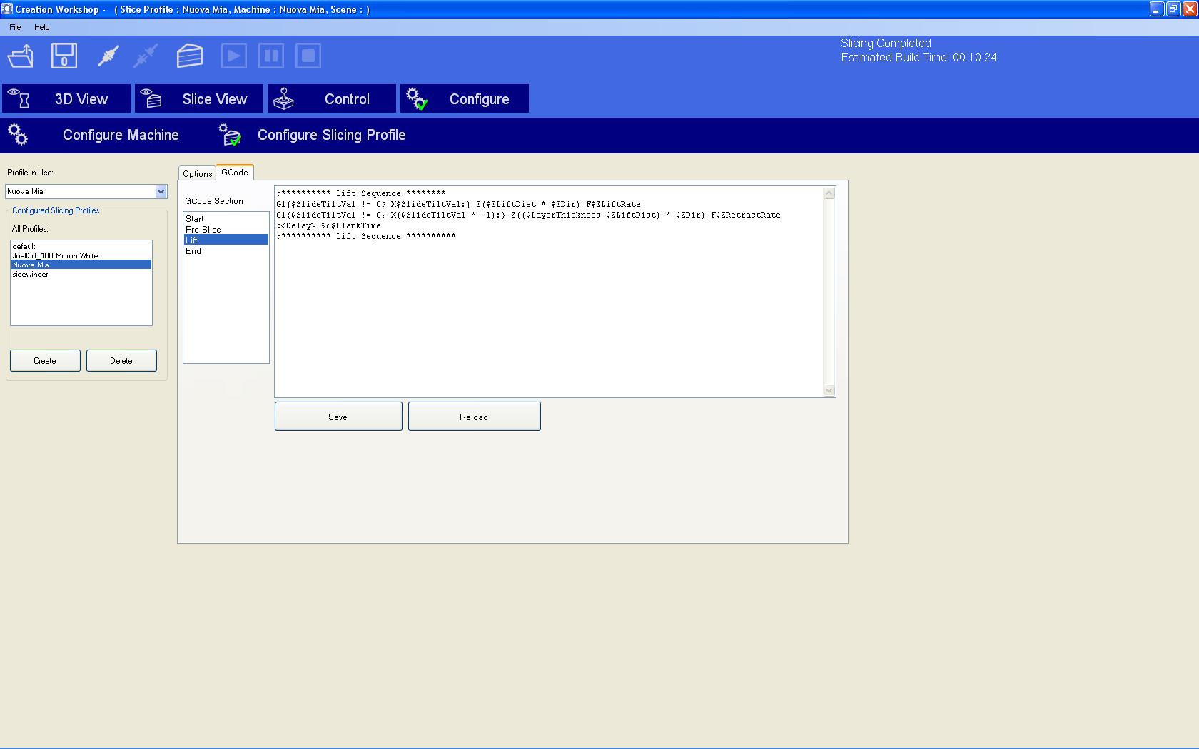

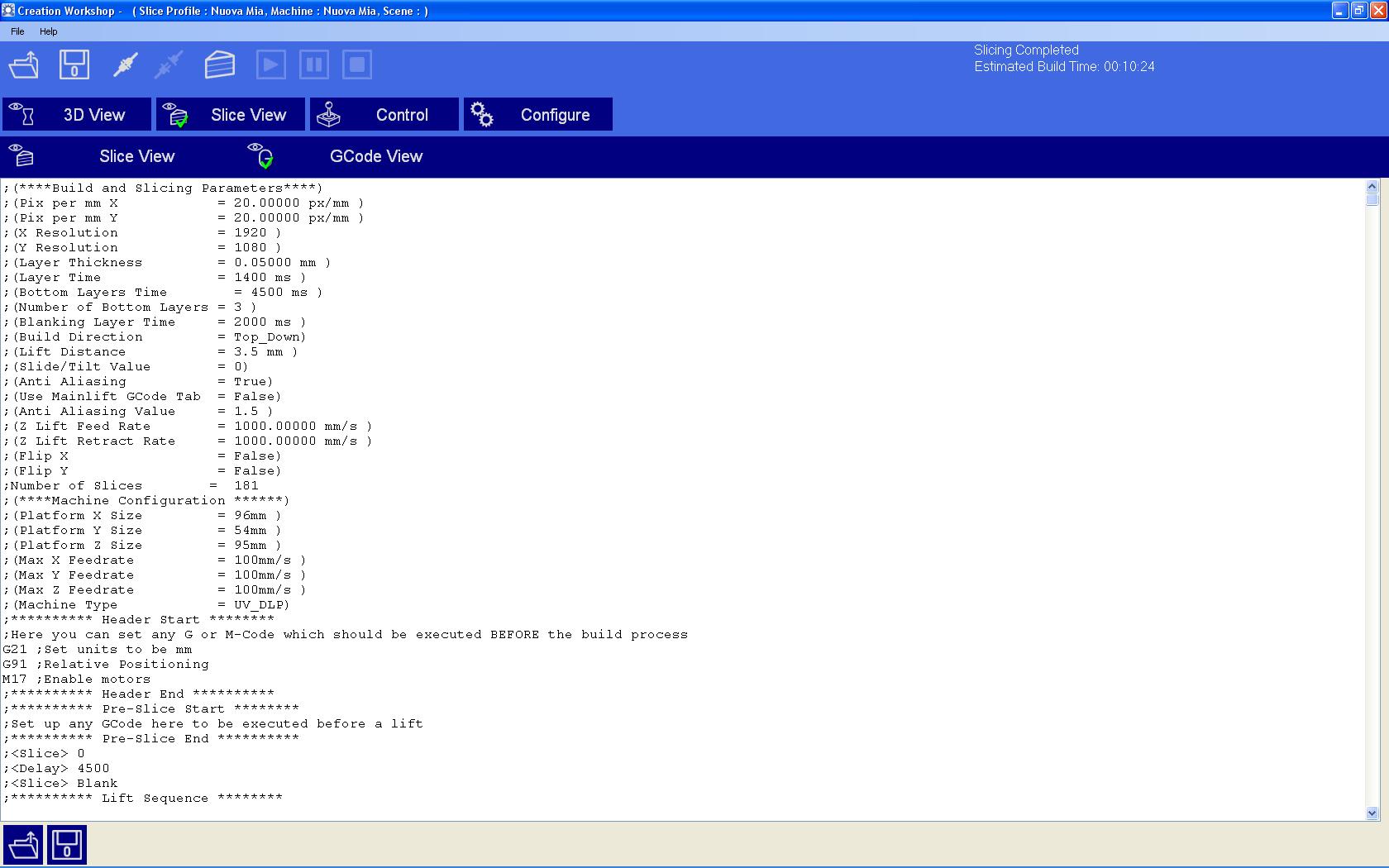

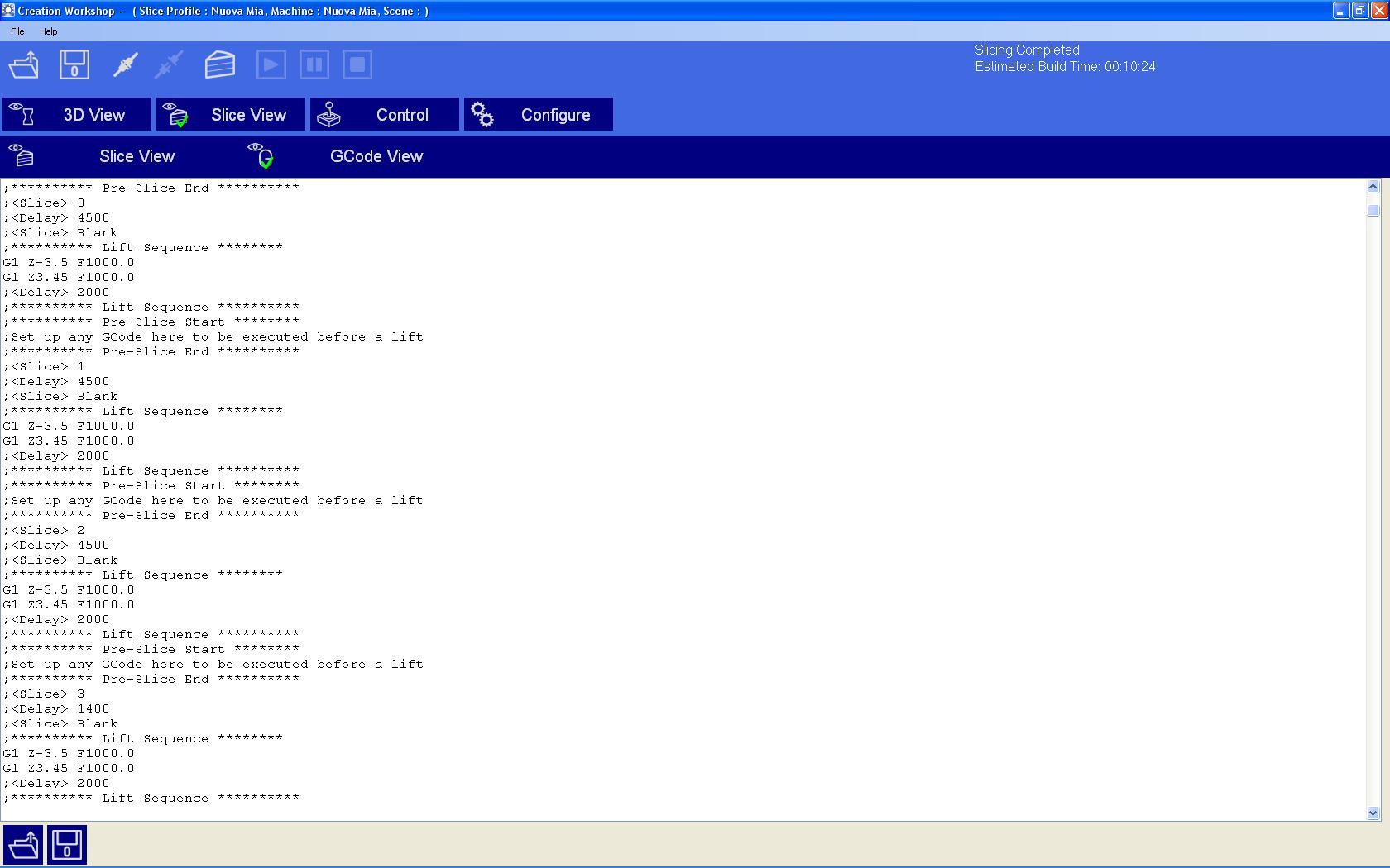

Hi, I'm trying to use C.W. for a DLP in Top Down configuration with Arduino Uno R.3 and grbl. The problem that makes the program is that the lift comes back always at the same position in all slices less the value that I have given in my case mm. 0.05 for each slice, and the problem is the same also with C.W.10.0.0.41 and 10.0.036 also with the samples inside the programs. I should to know how it is possible to modificate the GCode . In attachment some screenshots. Thanks.

hi CAP257RM,
you can modify the gcode by pressing the save button(in the bottom of the screen ) in the gcode_view,
alter the gcode file in a text editor..
and load the file via the load file button at the bottom

Hi hp, I don't want to to save the GCode I need that the program makes it when I do the Slicing.

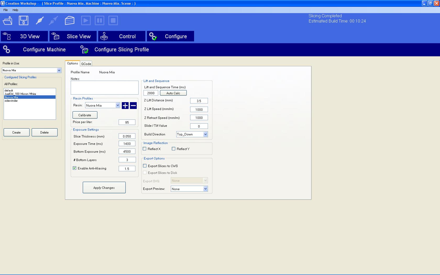

Does the new .54 CW fix the feedrate for the Uncia?

Hi physi3d, I think that the way to fix the feedrate is in the pannel of Configure Slicing Profile>Options>Z Lift Speed and Z retract speed.
