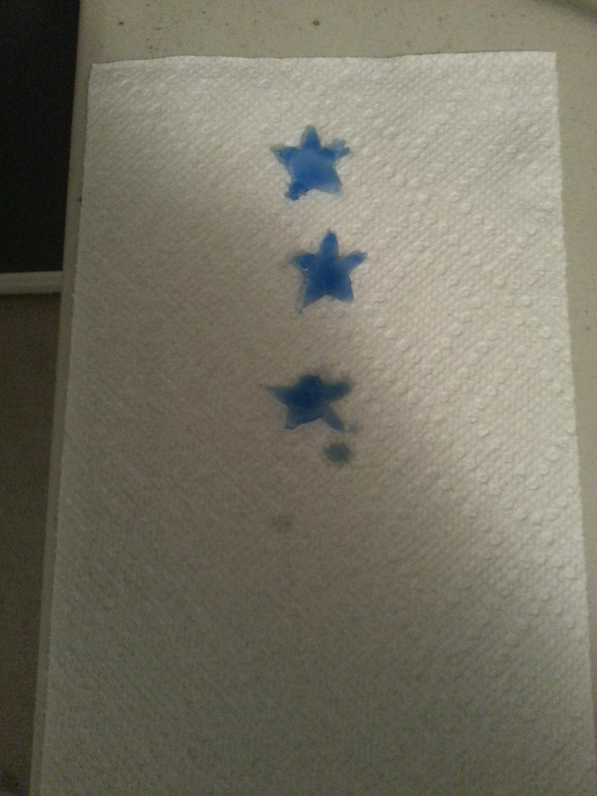

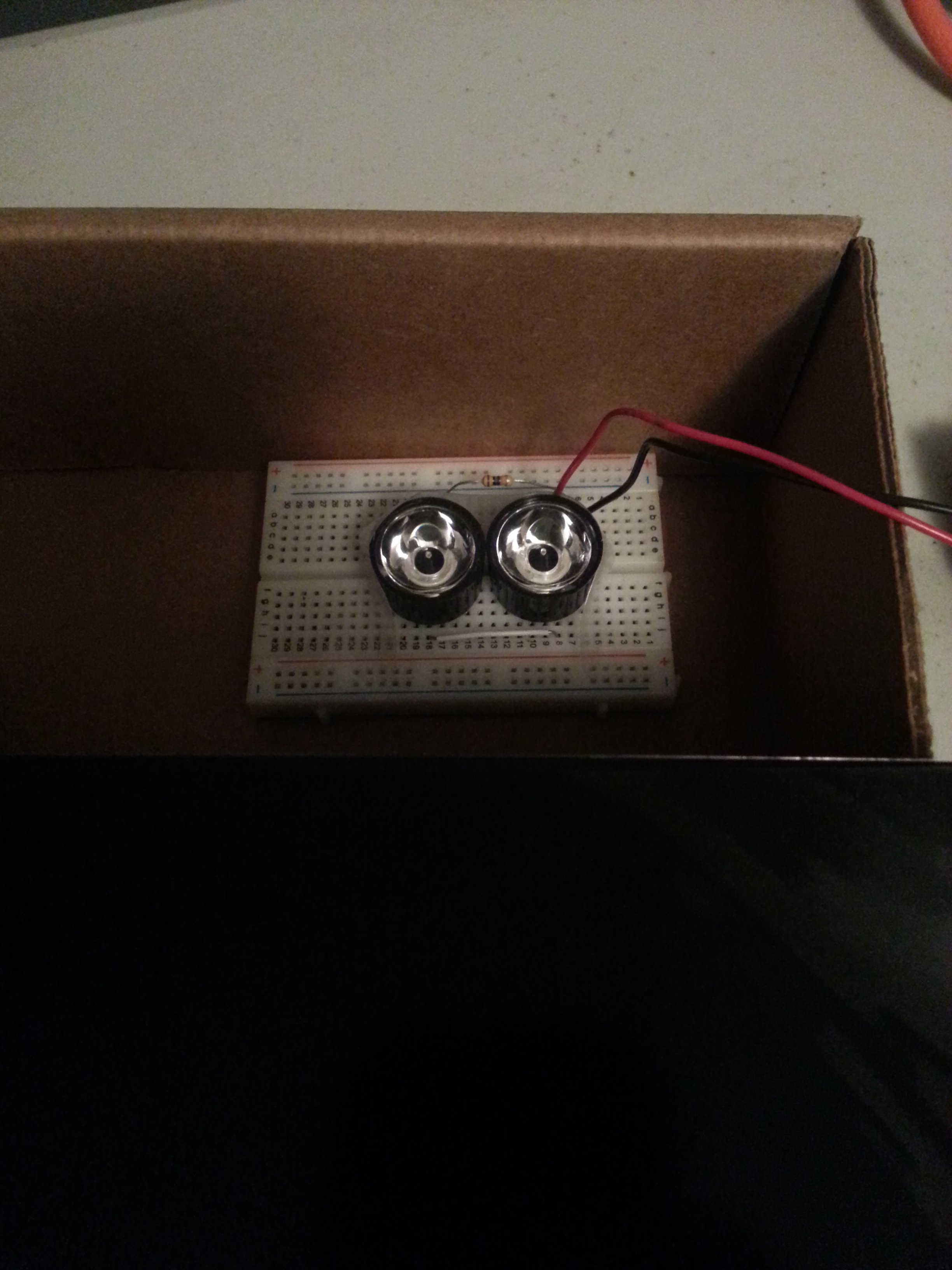

I've gotten curing through a colored LCD with 2 x 3W 405nm LED's with 5 degree collimating lenses. It did take a minute or so to cure however.

Youre using the wrong lenses, 5 Degree have a very dark center, I can see it in your pictures. Also, 20w leds are not enough for a whole LCD.
