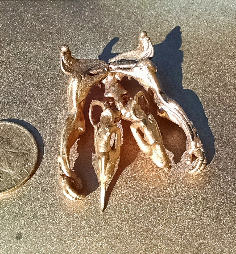

Spent last week tweaking and testing some more.. One feature that I think could help cut down print time alot would be an adaptive z reset height (go down more on layers with bigger surface area for proper resin coverage, less on layers with small surface areas ie support columns)
Test prints:
