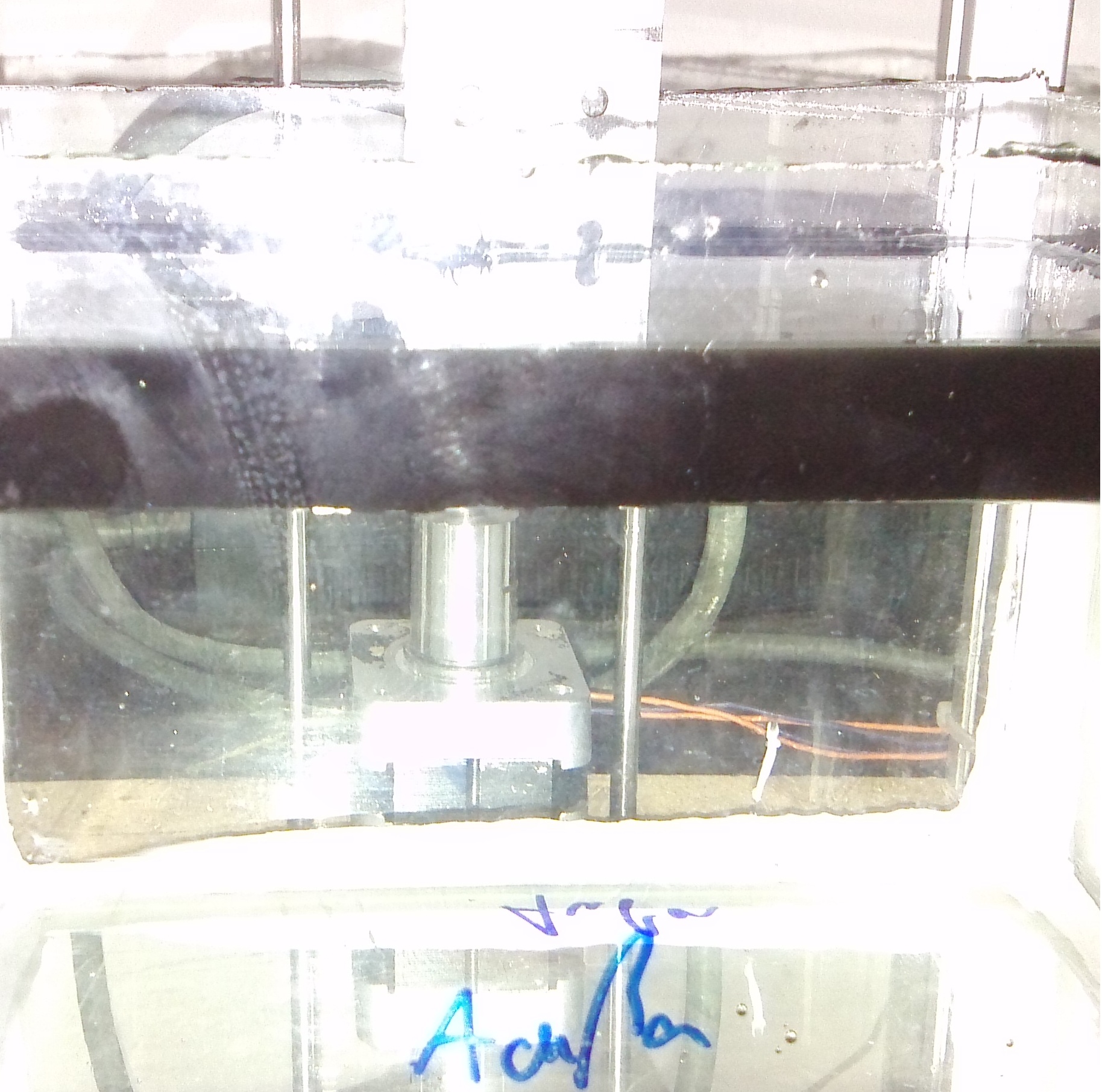

Hey,
i've tested a little bit and now i've got a solution for resin floating.
The resin and the solution stays stable for 3 weeks now and there are any reactions.
I've got no problems until now and i was able to save nearly 150$ for resin.

how does the water affect the stability of the resin while printing? I would imagine the resin sloshes around more on top of the water? like if you were to bump the table in the middle of printing a layer would it affect the layer thickness due to the resin moving from waves or ripples in the water?

According to Josh at MakerJuice their  resin has a density of 1.1g per cubic meter or 1.1 g/m3. Water has a density of 1g/m3 how ever salt saturated water or brine has a density of 1.2g/m3. Glycerine is also in that range with 1.26g/m3. Hope this helps, if I can figure it out I should have a sample machine built by the end of April. This method would also have to address the vertical deviation from the platform and projector staying still and the surface of the resin moving.
