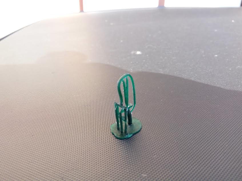

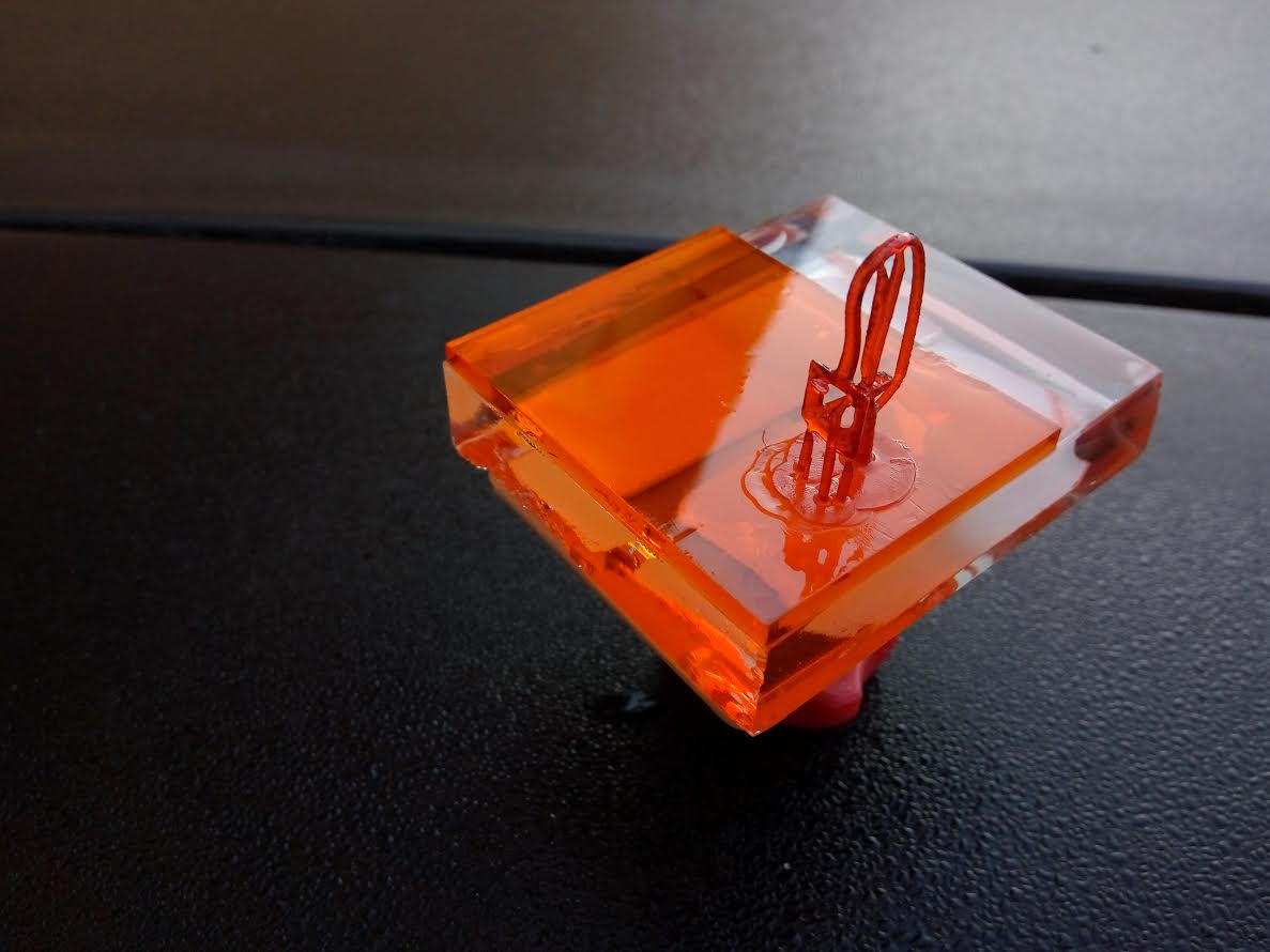

the print are very good next is to make case for it
20w uv laser 0.05 dot
speed 200mm/s i will go 400 wen i make better shell
it works and is good cheap
For one model 25u i have 50min z lift and 1.20h print total 2.3h per print i like it.
Try any dlp and sla resin all work the same.
