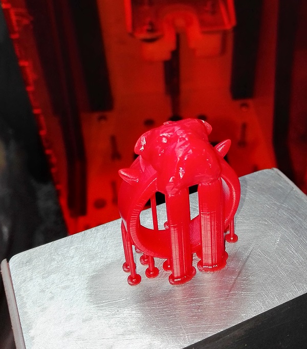

I want to tell you my experience with the LIttleRP and FLexVat . After several attempts, I have conceded good results with the following settings :
Resolution X=83,83 ; y=46,62; z=100 ( finetuning is neccessary with CW)
and for Makerjuice SUB SF 37 Micron Layer with 3850ms / 8000ms
using a ACER P1500 Projector
Greetings Kai ( a Goldsmith from Germany)

These look excellent!
I've just started to use my LittleRP for jewellery making too. So far my prints and calibration are way off! My ring appeared squashed!! Perhaps you might have some tips for me to get things going properly?
How exactly do you adjust resolution in CW?
Sorry, completely new to this! But thanks in advance
