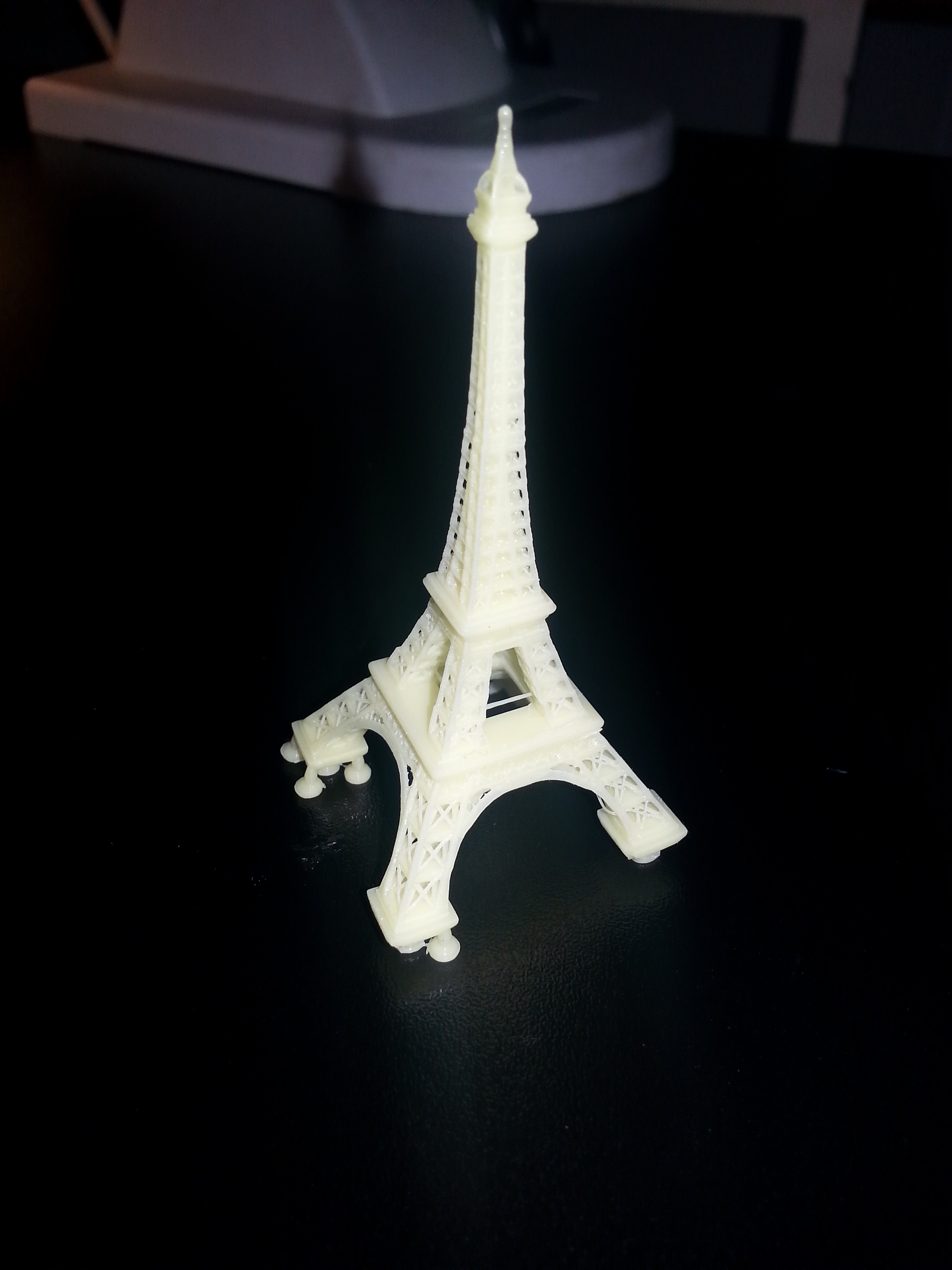

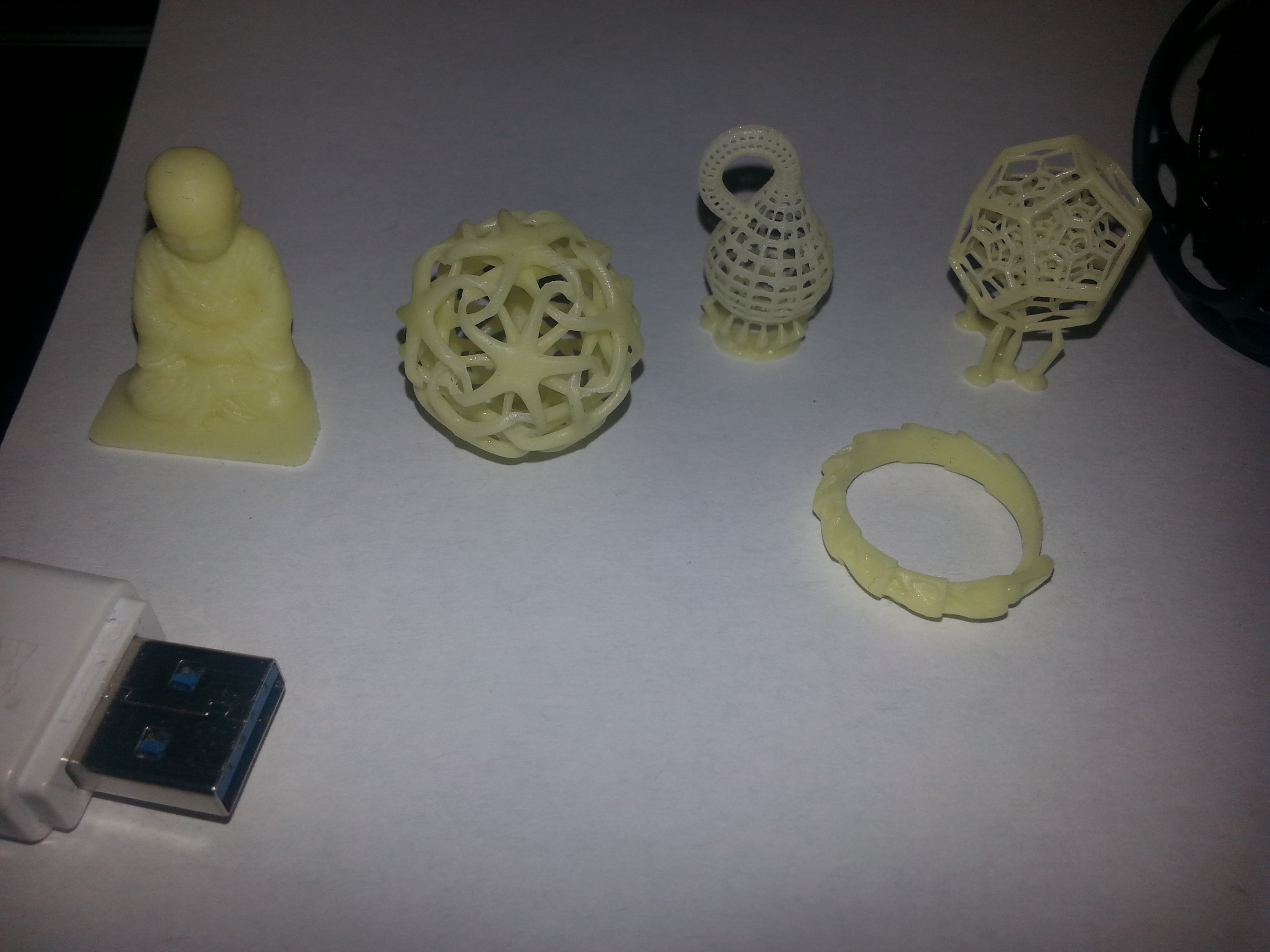

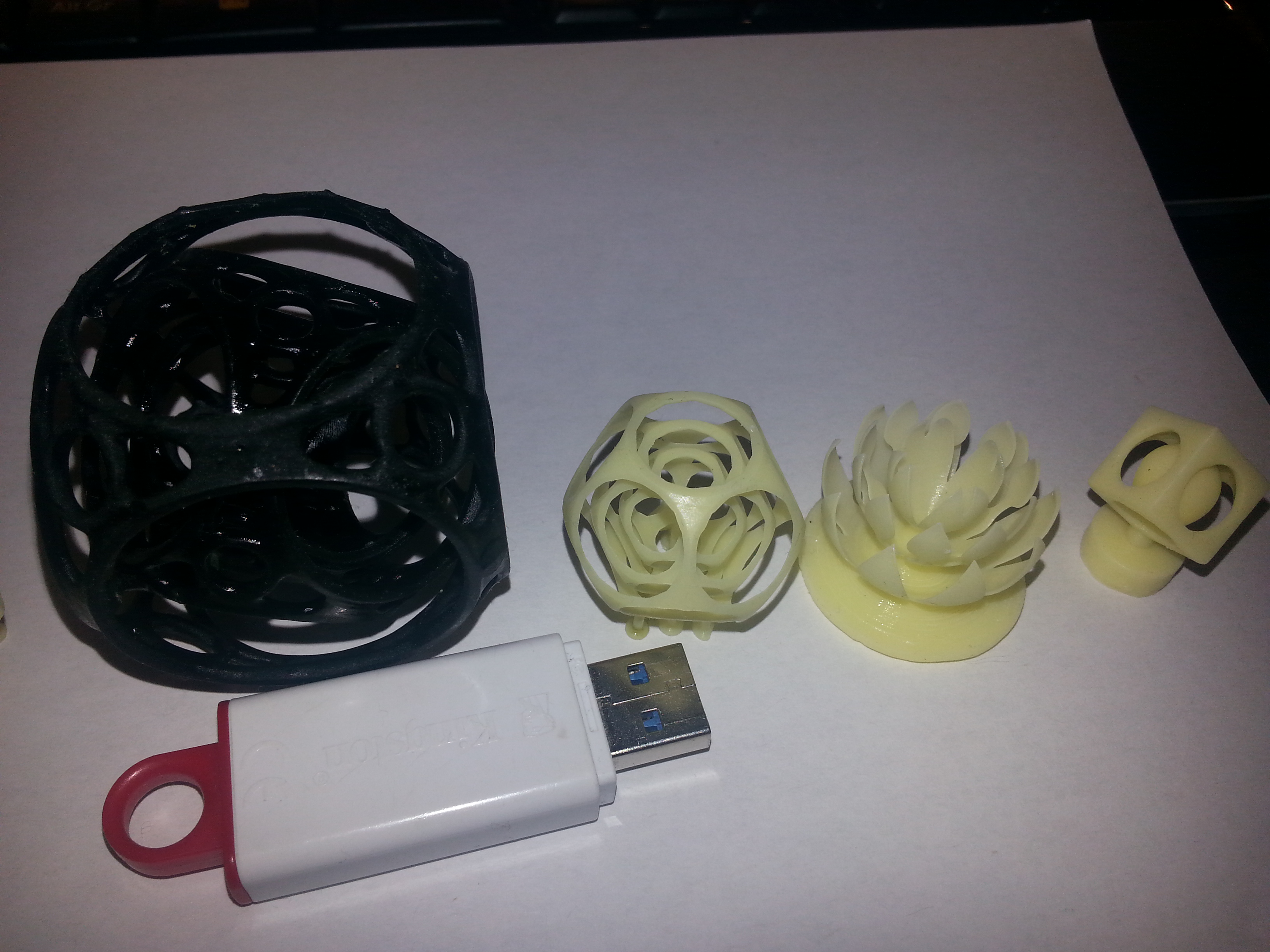

Hello everyone!
These are my first creations with my new self-made sprinter; I'm quite satisfied with that.
XY= 65um
Z=50um
projector: ACER H6510BD
resin: SPOT-LV (white) and FTD-SB (black)
The only problem so far is that I couldn't manage to totally eliminate the leaking phenomenon on the bottom surfaces; I guess it's a limit of this technology.
