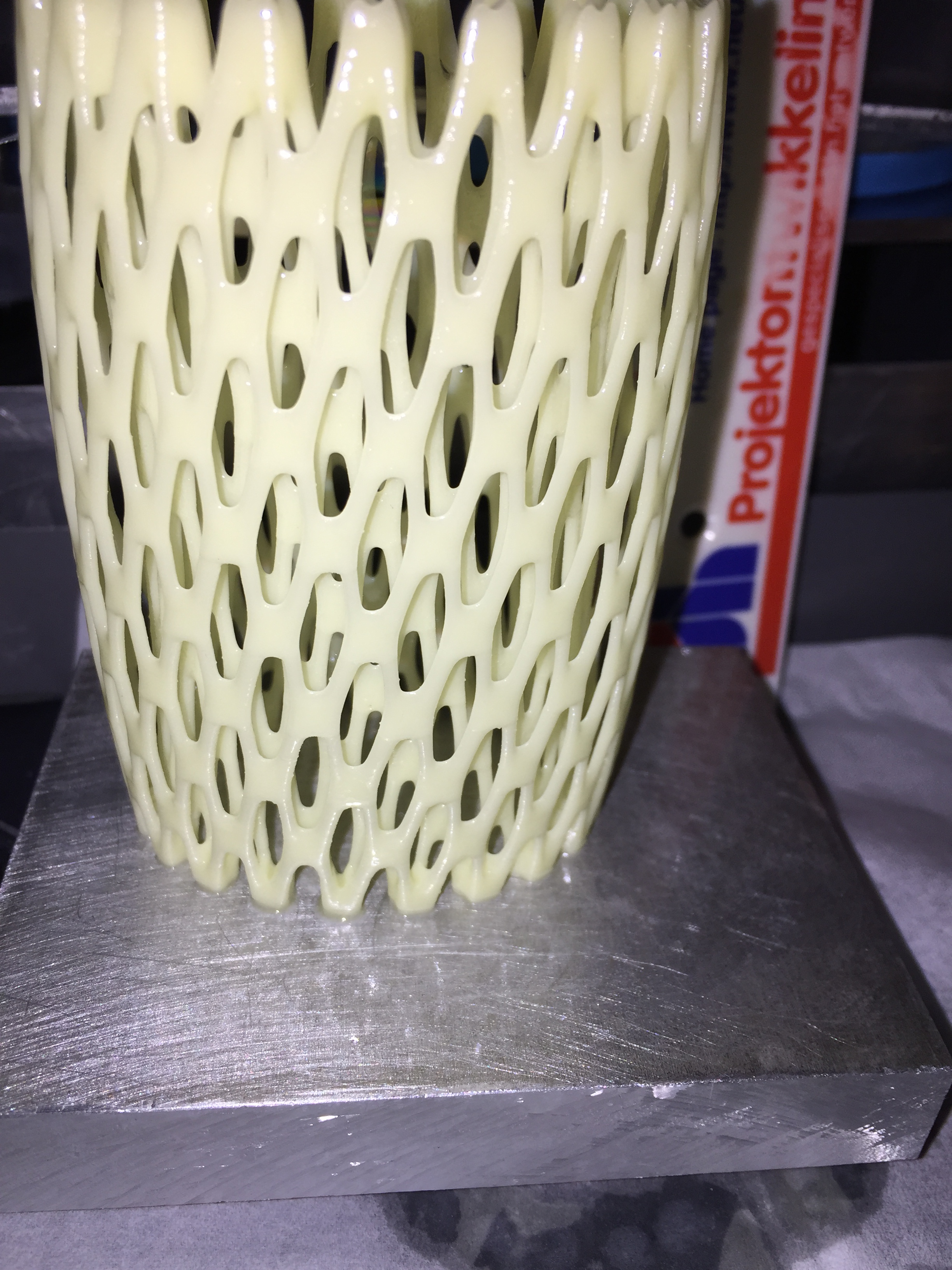

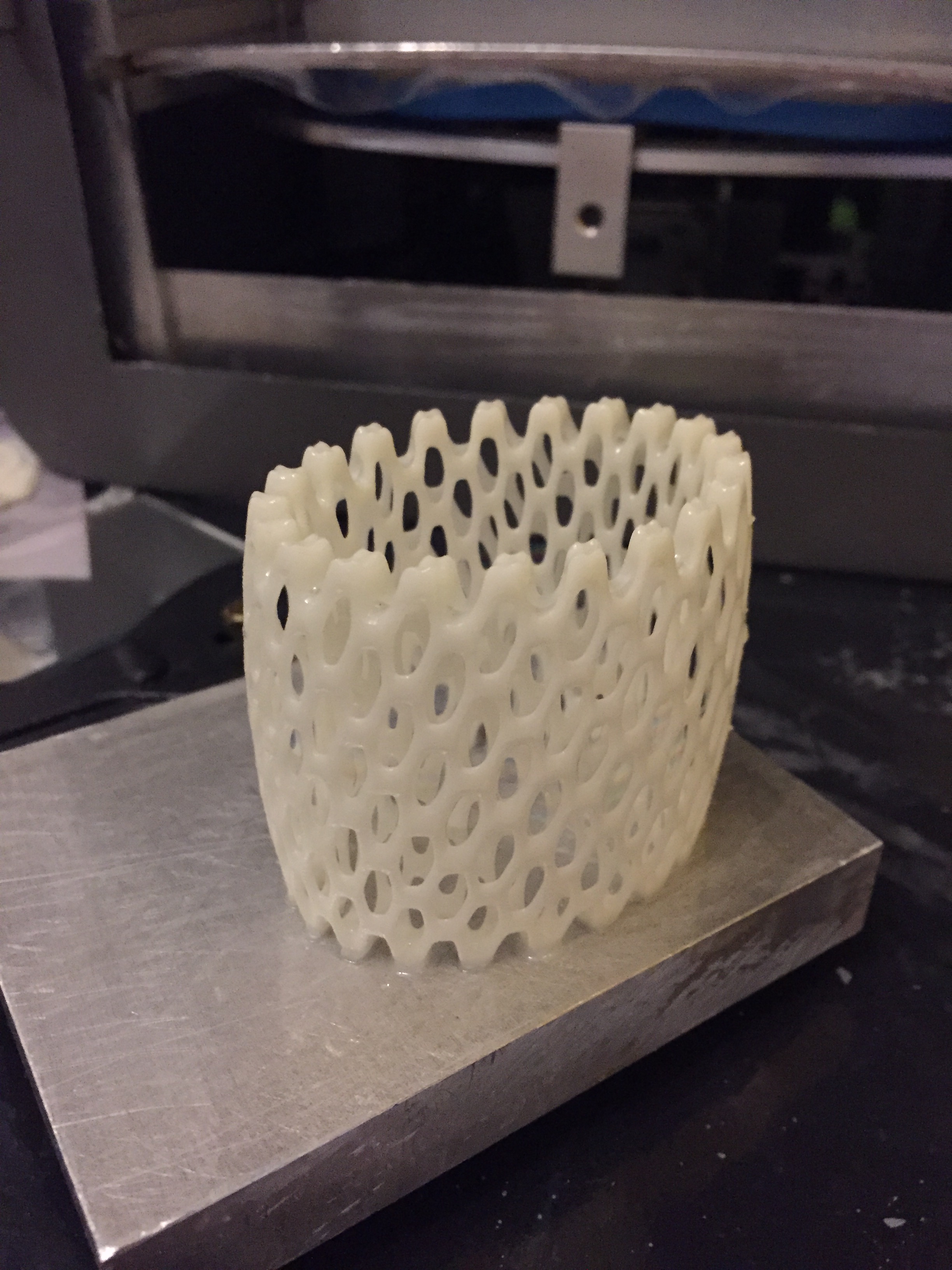

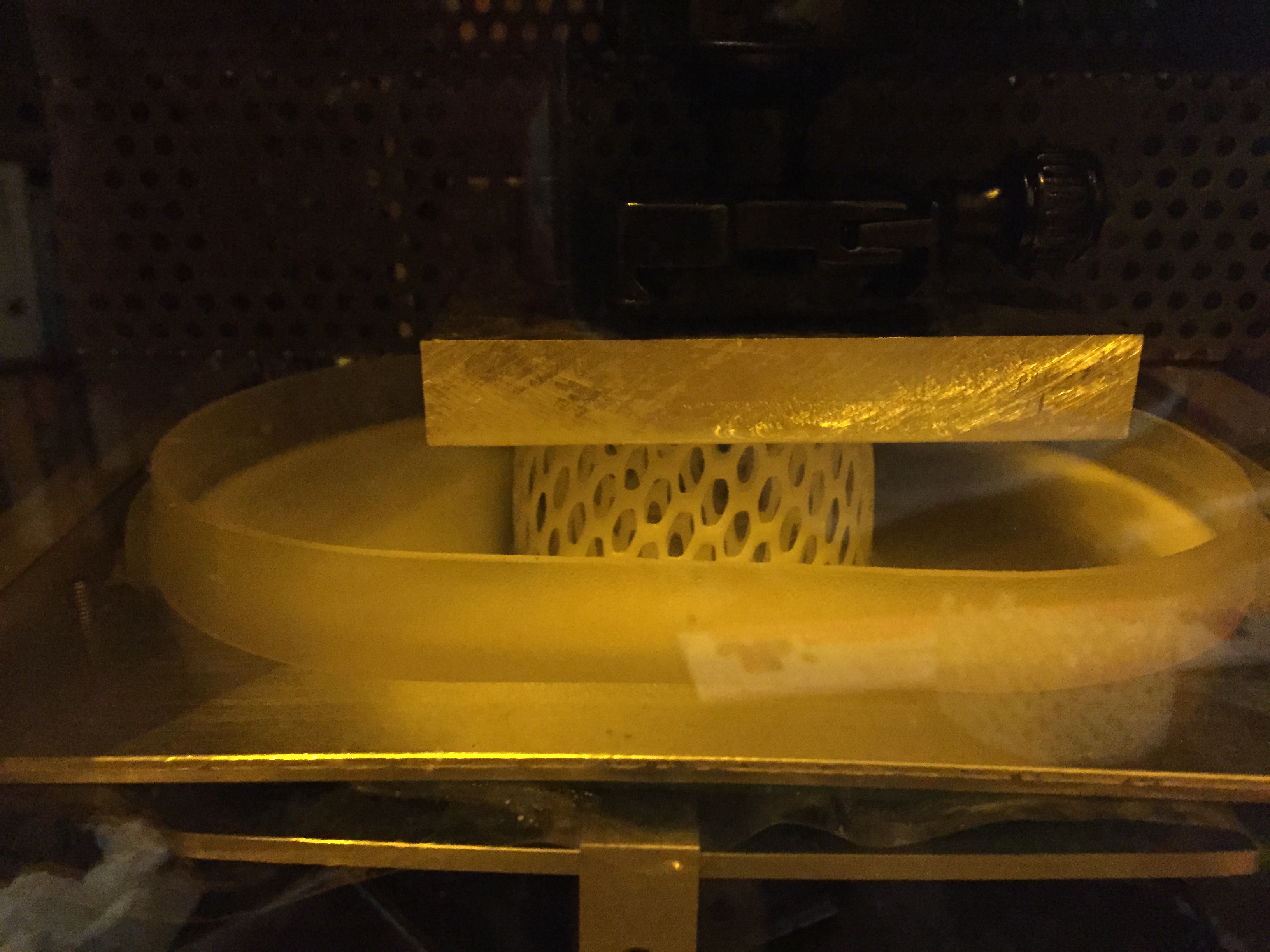

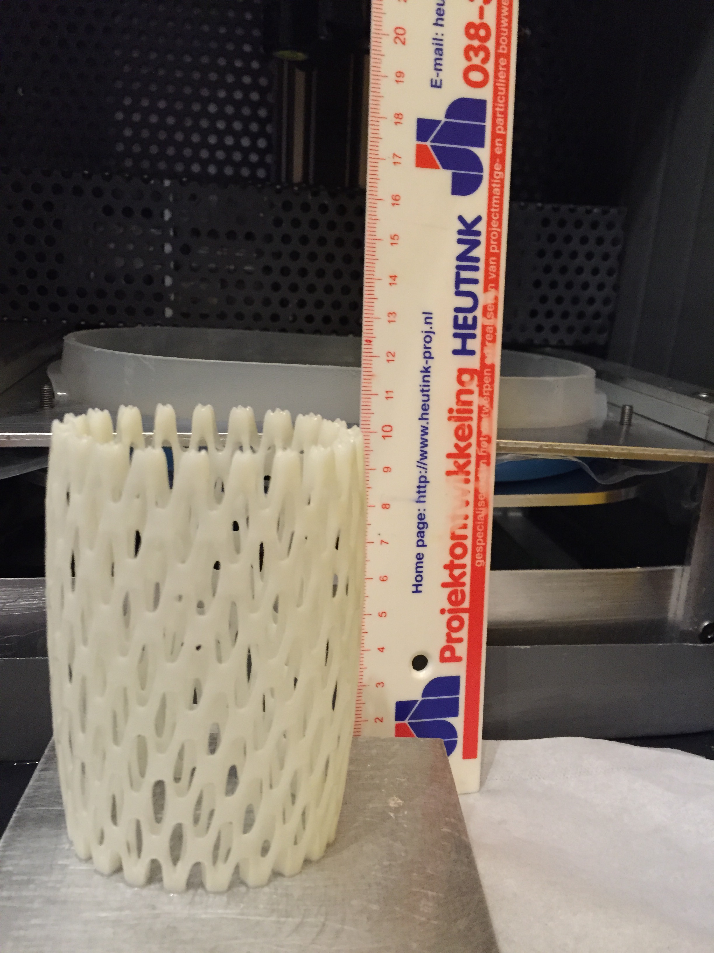

a very think walled print on the go.
and here is the thingiverse link :
layer height: 70 micron
exposure time 2 sec per layer
4mm lift at 150 spull - 650 push
resin used - Makerjuice SF white
Printer in action
https://www.dropbox.com/s/3ewasy5dfwjvg ... 6.mov?dl=0

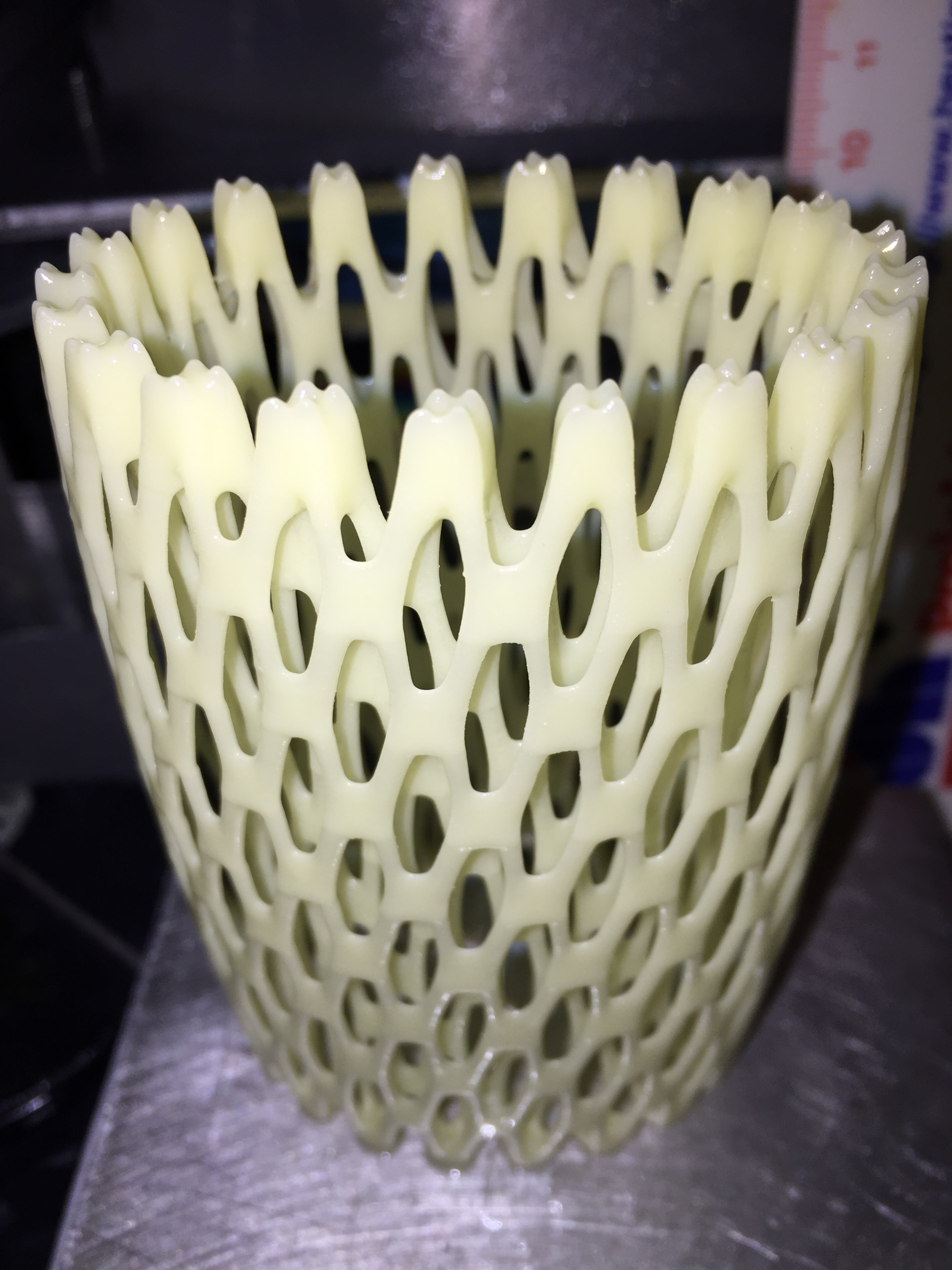

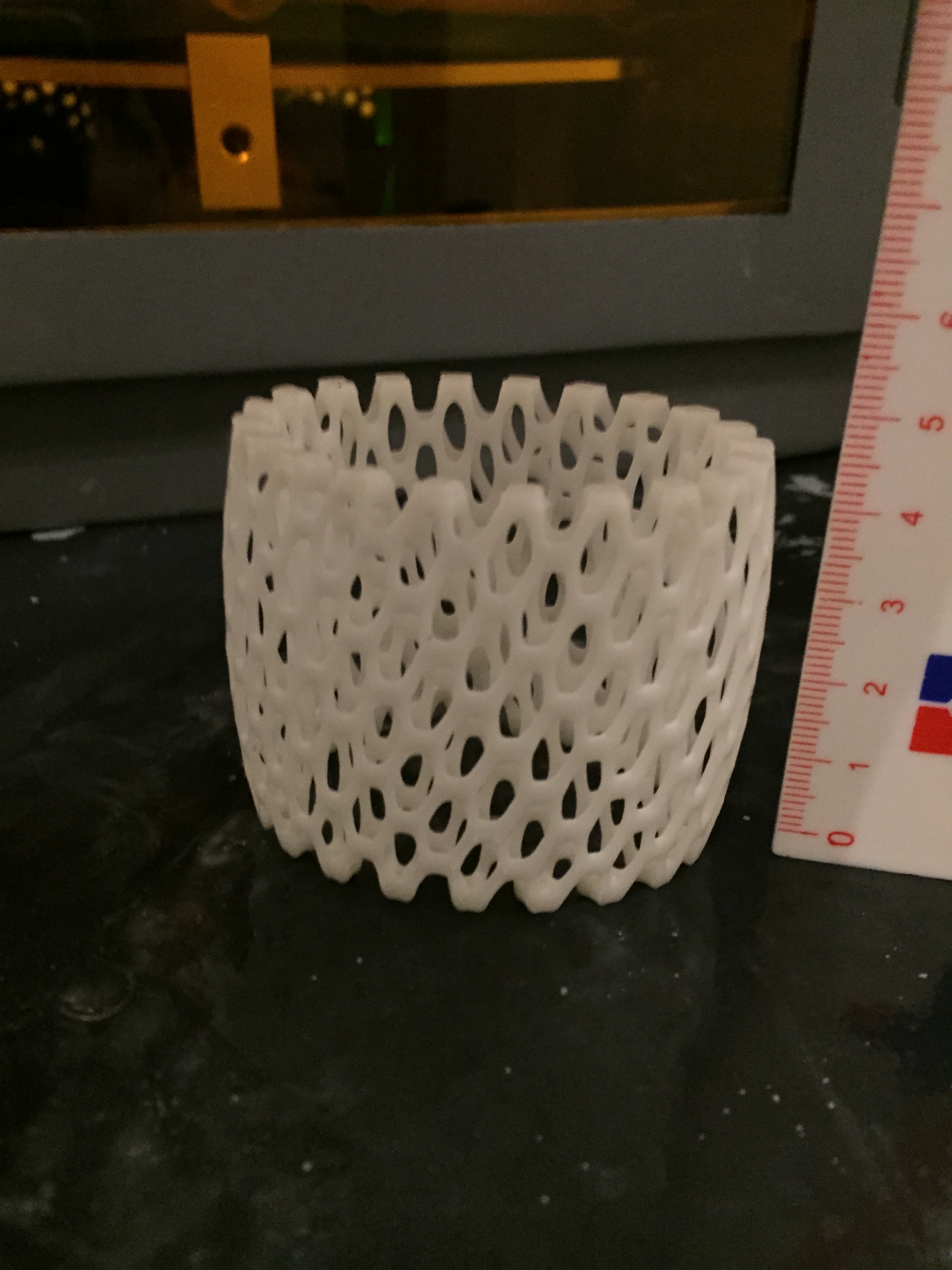

end result

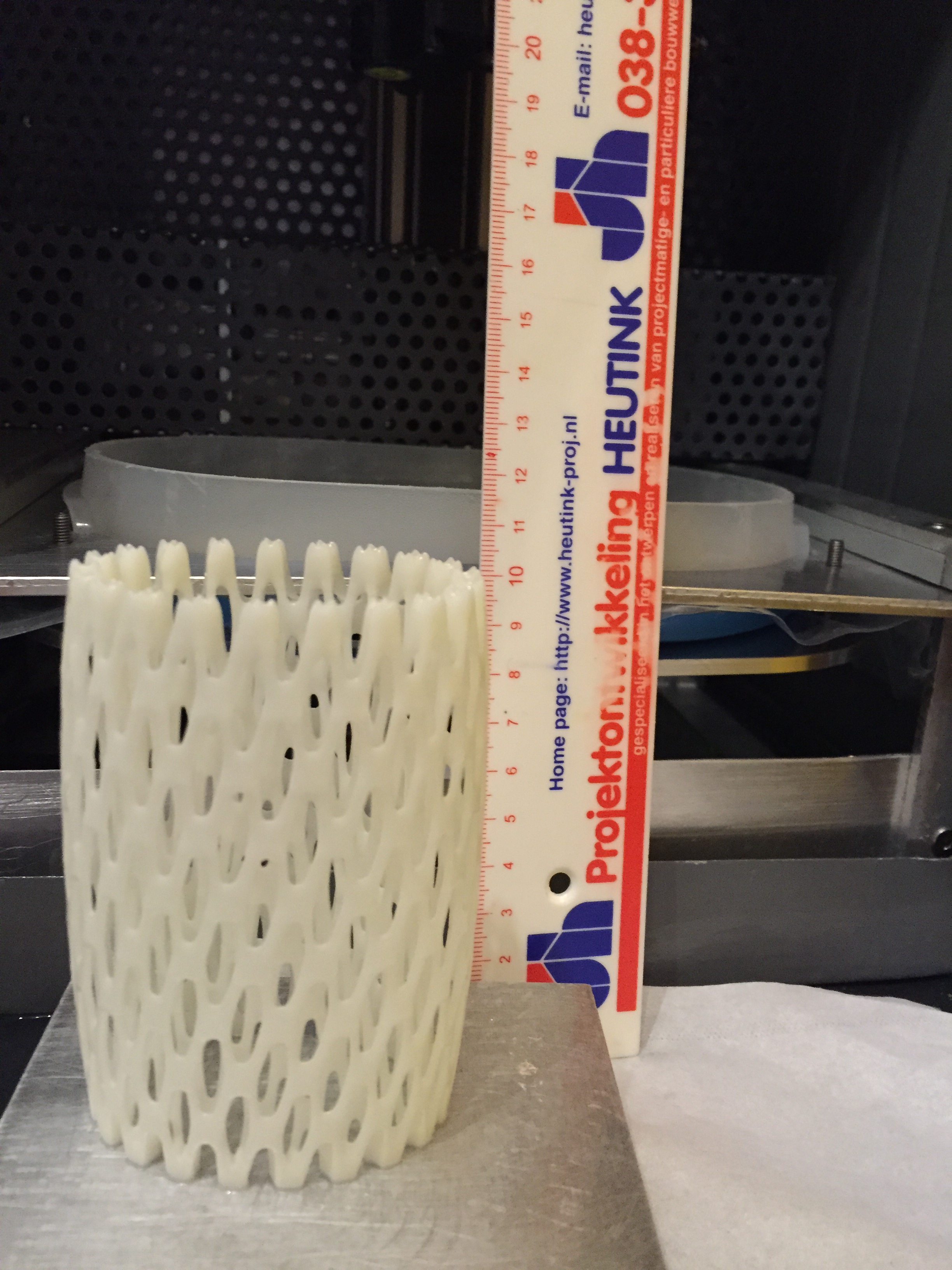

next print started.. one that is 10cm heigh
Stretched bracelet
