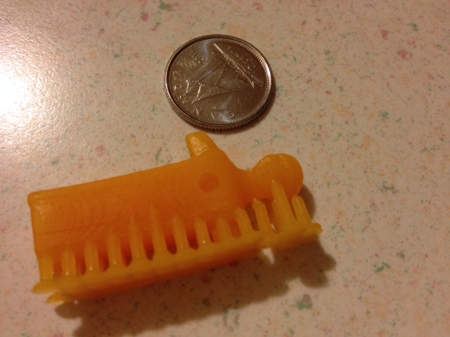

I have had some success with top-down printing. Trying to avoid the whole vat coating issue.

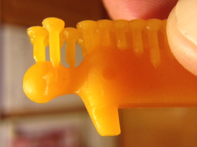

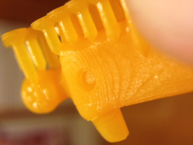

This part took about 20 minutes to build at 0.1mm layer height, using MakerJuice Sub G+. I am very pleased with the resolution but I made the supports a little too big - I can't break them off without damaging the part. I'm now working on settling the resin more quickly between layers.
