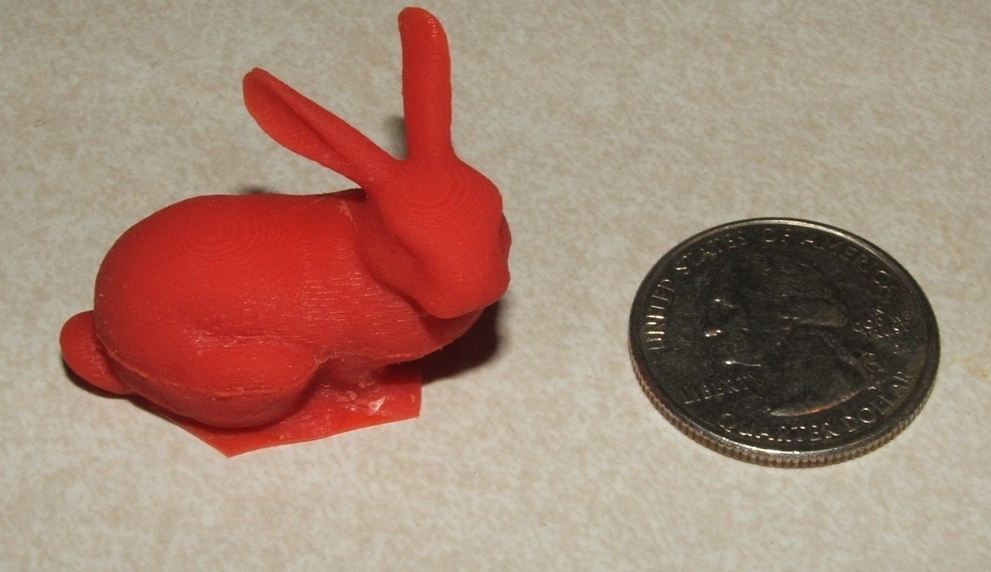

Well, I finally had a chance to test my printer.
I ran it at .1mm resolution on the Z stage, I still have to adjust the XY resolution since the rabbit came somewhat flat.
The computer video card send the monitor to sleep right in the middle of run, which caused the projector to run at full intensity and creating a diaphragm of cured resin right in the middle of the wabbit.
I used Makerjuice's newest SubSF resin.

It looks like a very successful print! I think once you adjust your settings to not sleep it should be fine. Post more when you can.

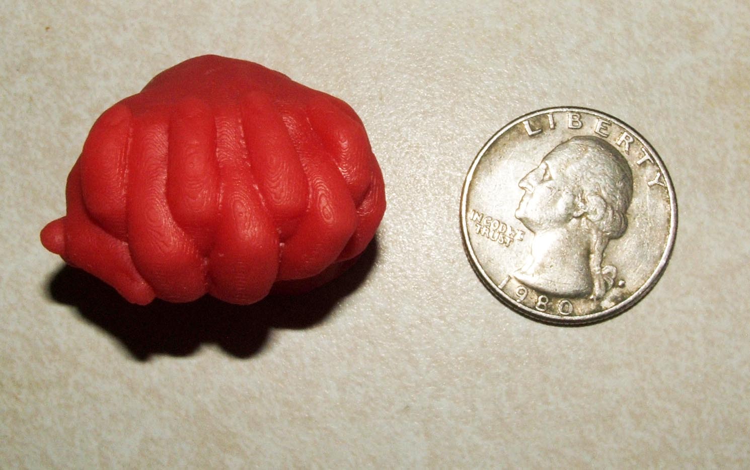

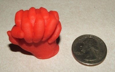

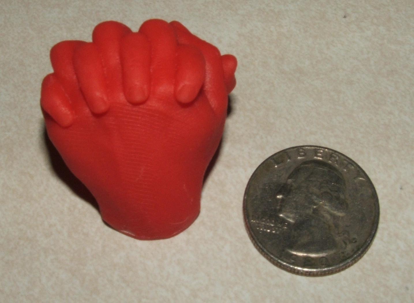

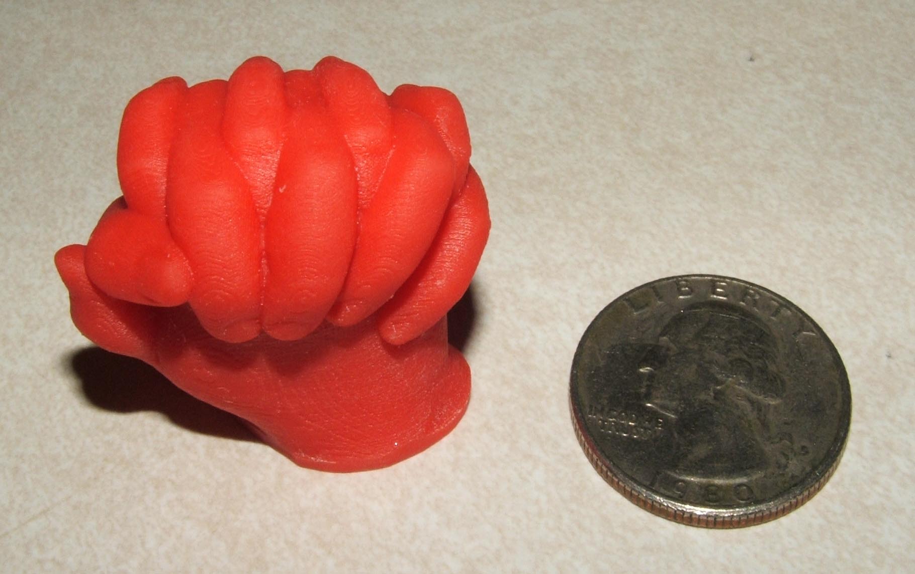

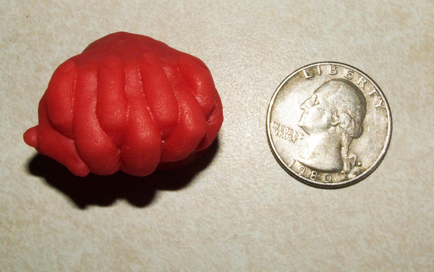

Here's another print from a 3D scan I made of me and my wife holding hands and using Agisoft Photoscan to capture it.
I am only scratching the surface on the capabilities of my machine, the combination of FEP with passive tilt and the fused quartz vat bottom are working as I expected.
I will be increasing the resolution little by little and use oversampling to get the highest possible quality.
There was a problem with the projector I was using, out of the blue it started overheating and shutting down in the middle of runs. So right now I am converting it to LED and the production of prints will be suspended until I'm done with it.
I want to thank everybody in this forum for their help and support. For providing ideas and always pushing all members toward successful builds.
