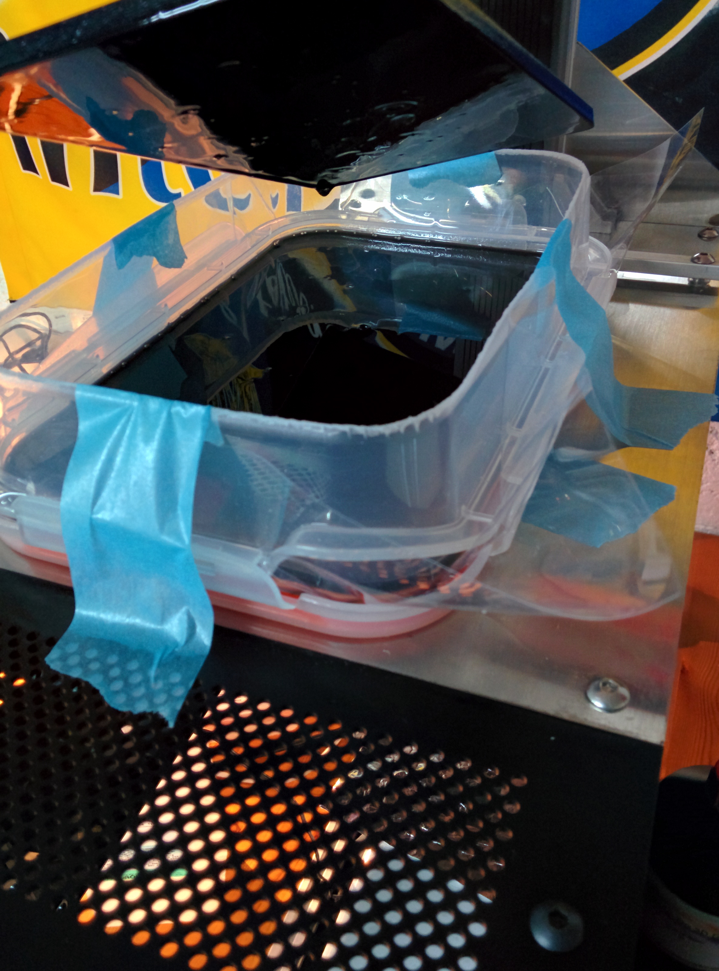

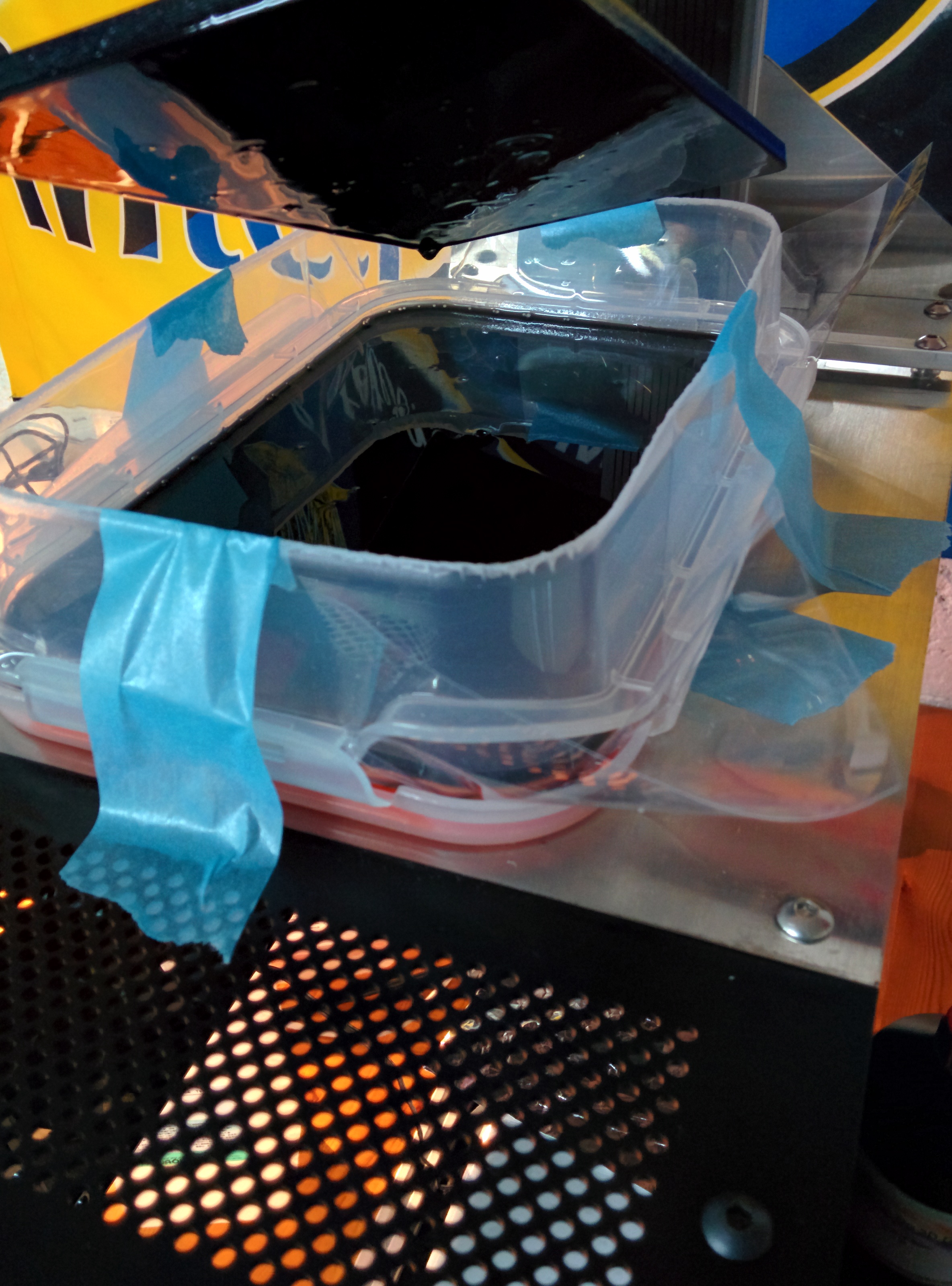

Hi guys,
tried the "Ikea" vat tonight, 0.05 FEP stretched firmly but not very very tight.
-After a few seconds of exposing the first layer (just a square about 3x3cm) , the FEP film started to bulge, a little bit like plastic becoming too hot. I was just 10 seconds into the first layer, projector is 20 to 30 cm away from the FEP, i placed my hand and cannot feel any heat.

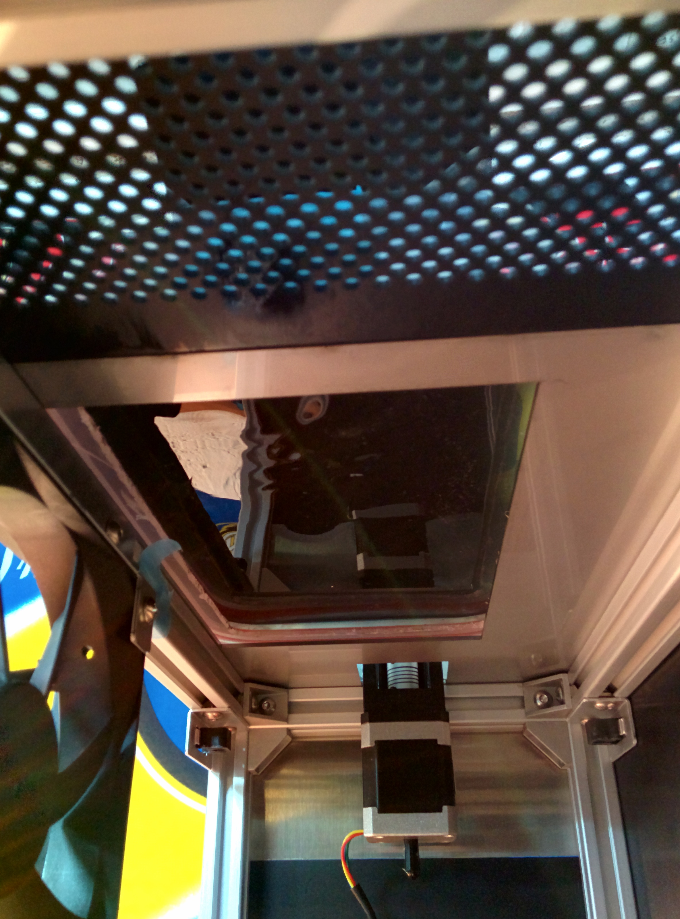

You can see in the picture attached, from underneath the vat, the reflection of the vertical extruded alu profile is not straight where the film has bulged. I removed the resin and released the FEP, it seems permanently deformed.
I'm using maker juice G+ black.
I'm not sure what can cause the FEP to deform like this. Bought the FEP here:
http://projectsinterestsandetcetera.com/store/
Do I need to place a glass underneath the FEP so it cannot deform ? Or do i need to stretch it very hard ?
Puzzled.

If your FEP is not under a good amount of tension it is not going to be flat and you are going to get sagging in the middle of the vat floor. BTW you got the FEP from me and it works flawlessly on my rig but I have the film under tension ( http://projectsinterestsandetcetera.com ... iagram.jpg - http://projectsinterestsandetcetera.com ... p-flexvat/ - http://projectsinterestsandetcetera.com ... oing-work/ )

Tension is the key to this type of vat. .005" FEP is a tough material it will not split under tension unless it is stretched 300 or 400 % or more. Tension makes the vat floor "rigid" just like a piece of glass, this tension combined with a sufficient "squeeze out" time between exposures (giving the resin time to flatten between the build plate and vat floor) has given me 100% successful printouts 100% of the time since I built my vat (this was no way near true before). If you can find a way to tension your vat the return will be have hassle free printing long term.
Note: the "squeeze out" time I mentioned, depending on the tautness if the FEP is the same or slightly longer than your normal layer cycle time (my cycle time with squeeze out is 3 - 3.5 sec. exposure + 7 sec. combined vat tilt/build plate rise fall/squeeze out time for 75 - 200 micron layer thicknesses, 67.5mmY X 120mmX ).

I second the need to have a tension device. I too use .005" FEP and it will easily 'sag' without tension. I tension mine until it sounds like a drum. I've become pretty good at sensing the correct 'pitch' of the sound it makes when strummed making sure it is equal across the entire surface. I once had big issues with not sticking to my build plate and it was due to not tensioning enough.
