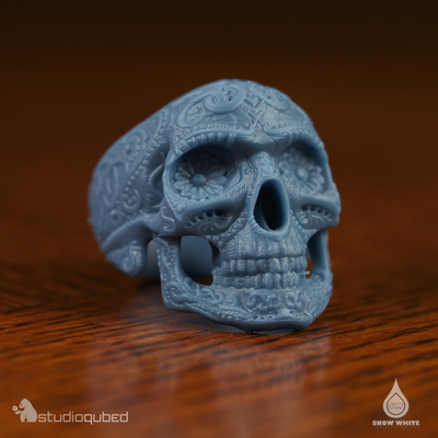

It's been too long since I posted any images. Here is a sampling of images using a new blend of the Fun To Do resins - The new variety will be available keep an eye on the Fun To Do web site: http://www.funtodo.net and http://www.studioqubed.com
Feedback please....Thanks!

@Dan - new being a completely new formula. The prints were run on the B9 and the Titan with cure times of ~2-3 secs/layer. The material is strong/hard and surface quality is excellent. True white and true grey and any other color you care to have

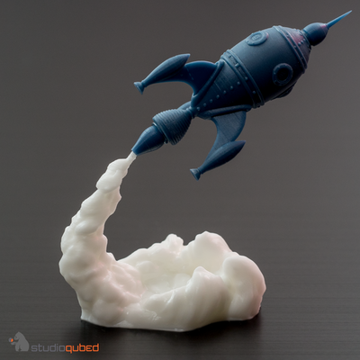

Hi everyone, soon to be released Fun To Do Snowwhite! Couple more images to share.

i hear this new white resin has no bleed. it will be as strong like IB ?
