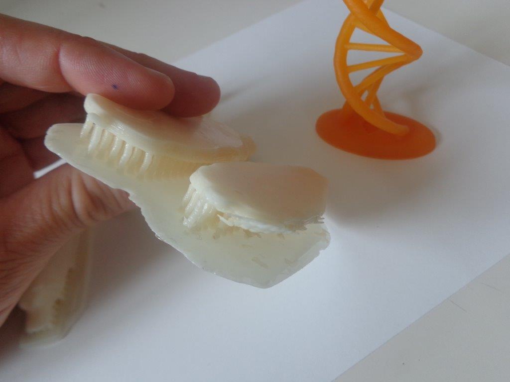

Below some prints I made with my self designed SLA printer- BUT: so far I'm not satisfied with the quality so I hope someone can assist

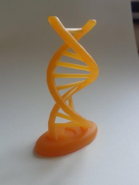

1.) I've printed the orange helix at 0,05mm so I got my first successful print: the surface is nearly flat but the thickness of the helix poles varies

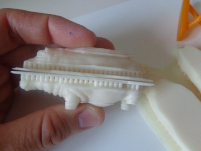

2.) the support nails always fail (white printed with 0,1mm)
I'm sure I do something wrong with exposure time but should I add more or less!?
