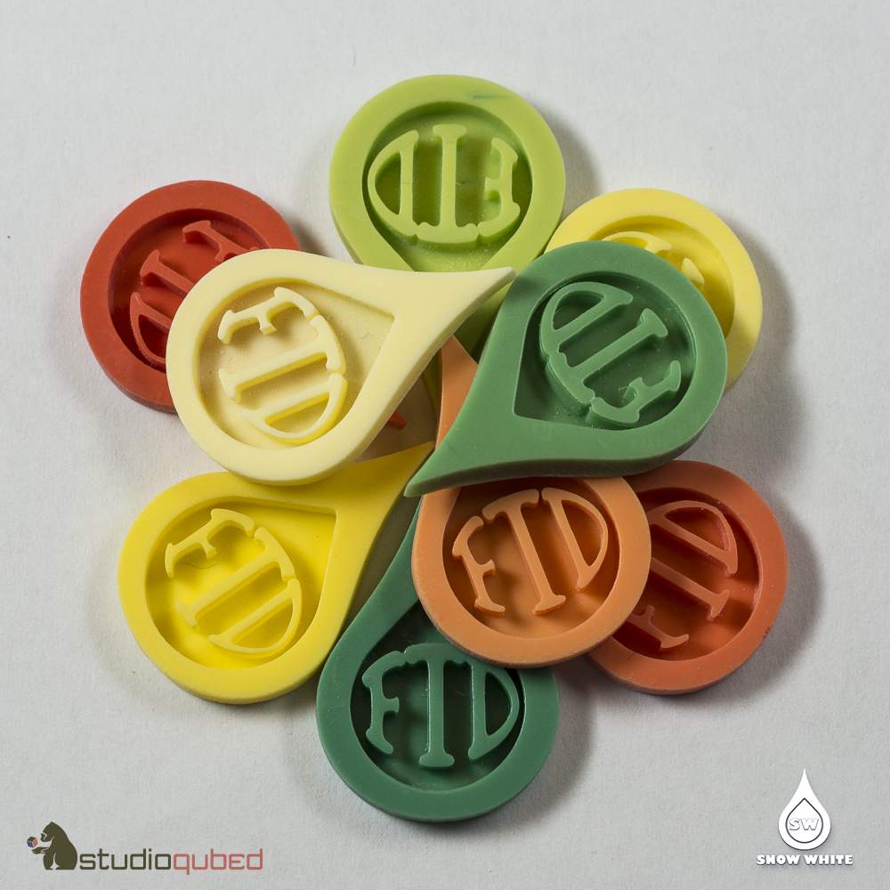

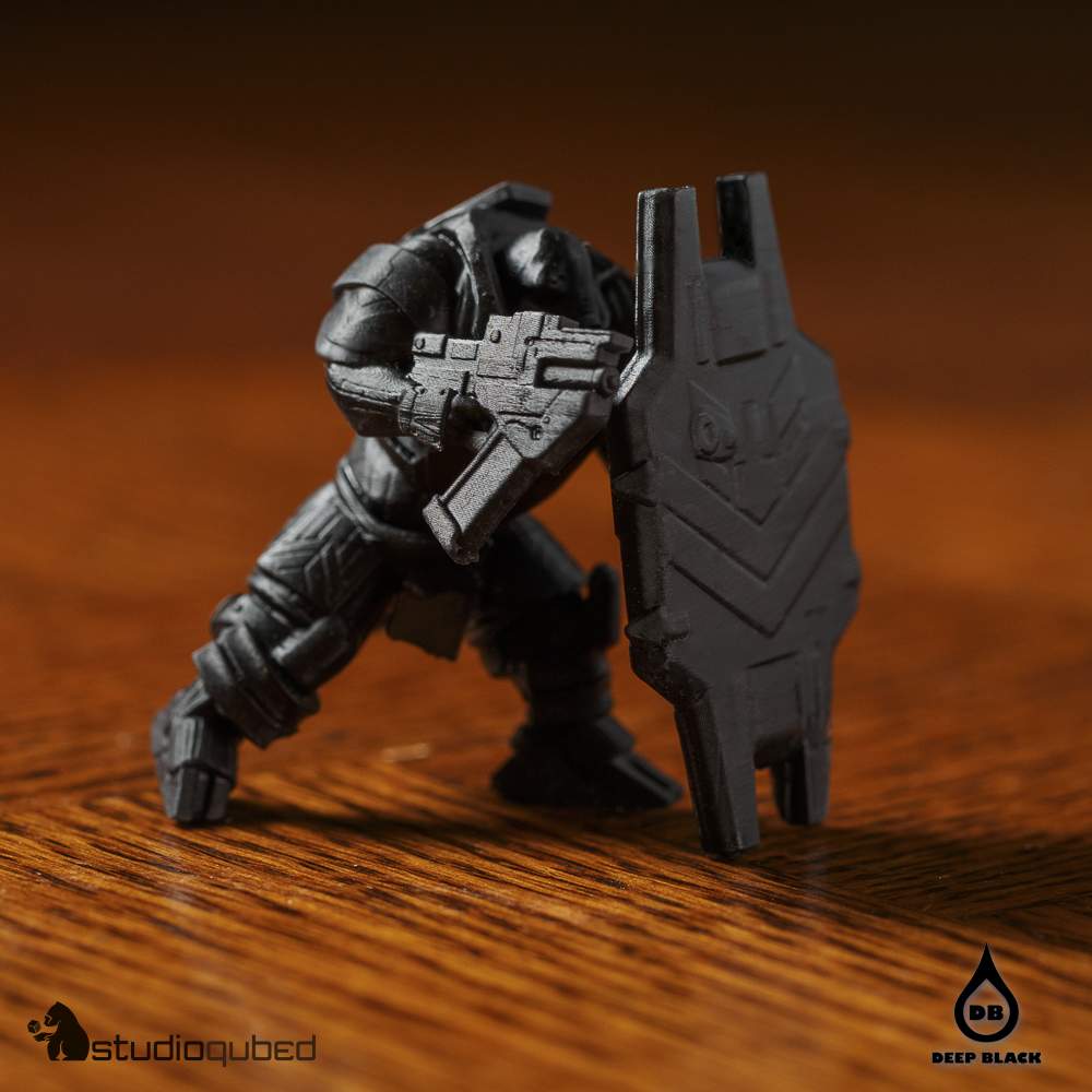

I've been running the print tests of the new Deep Black and Snow White. Both exhibit similar properties to the Industrial Blend with regard to shrink <.5%, heat tolerance and shore D (both have been used for vulcanized molds), cure times from .9 - 3 secs per layer dependent on machine (based on a 240W and 220W dlp bulb) and pigmentation. I'm currently testing laser sla.

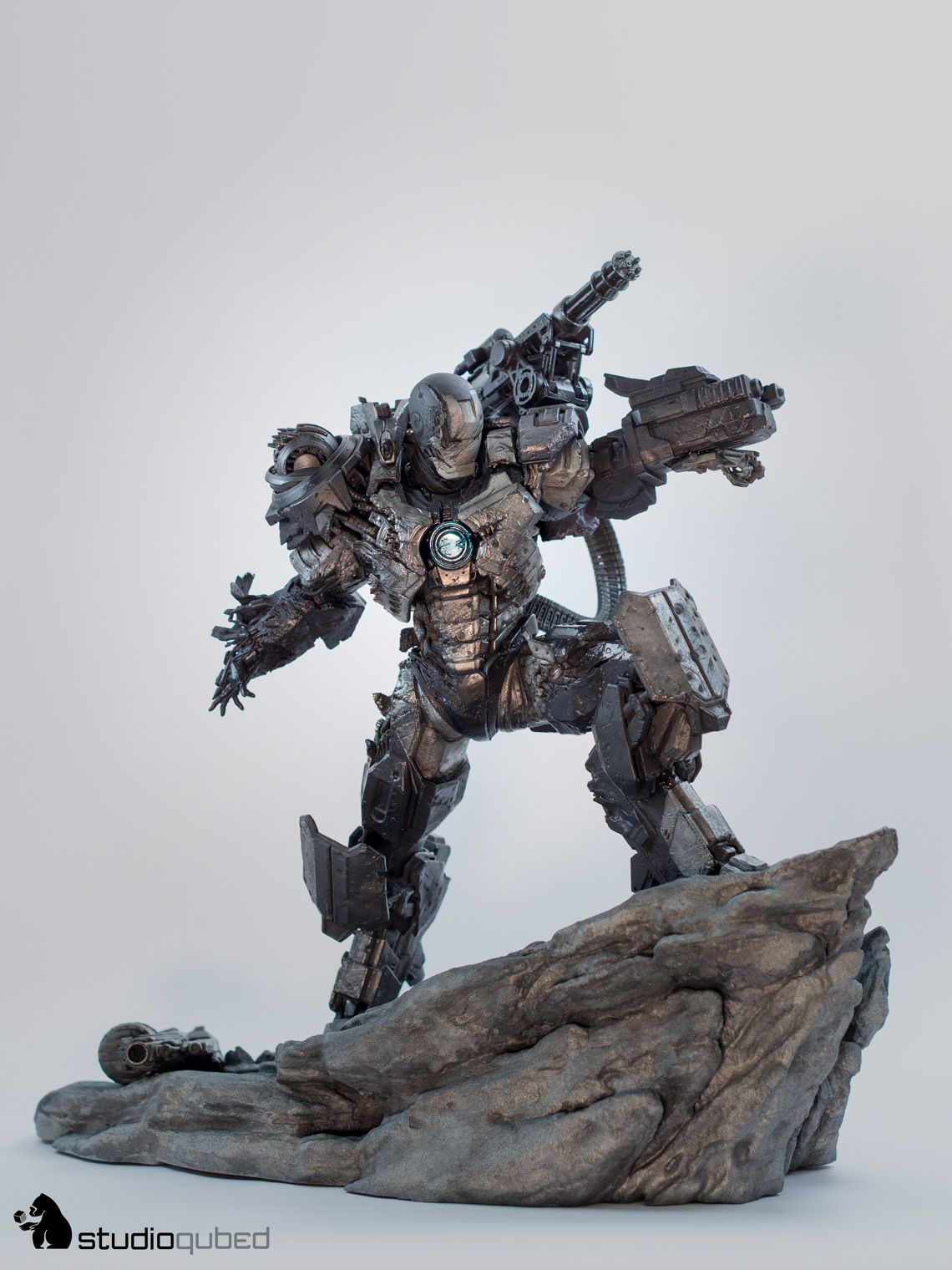

Fun To Do Deep Black - 95% of 34 parts for the War Machine - 5% Snow White - Base 3 pieces printed on a Solidator -
