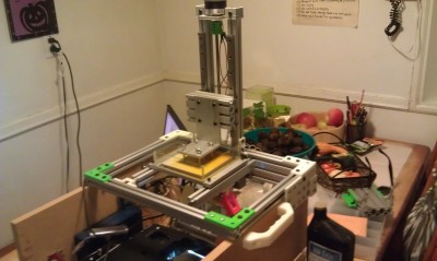

My Bottom-up Machine
Posted: Mon Dec 02, 2013 8:23 pm
I know most of you have seen this before.
I've got a bottom-up machine with an Infocus 2104 projector. Attached is a good overview shot. It can print objects 120x100x250mm in size at a X/Y resolution of 100 micron and 50 micron in the Z Axis.
It took me a while to solve my vat release issues, but now it prints great!
