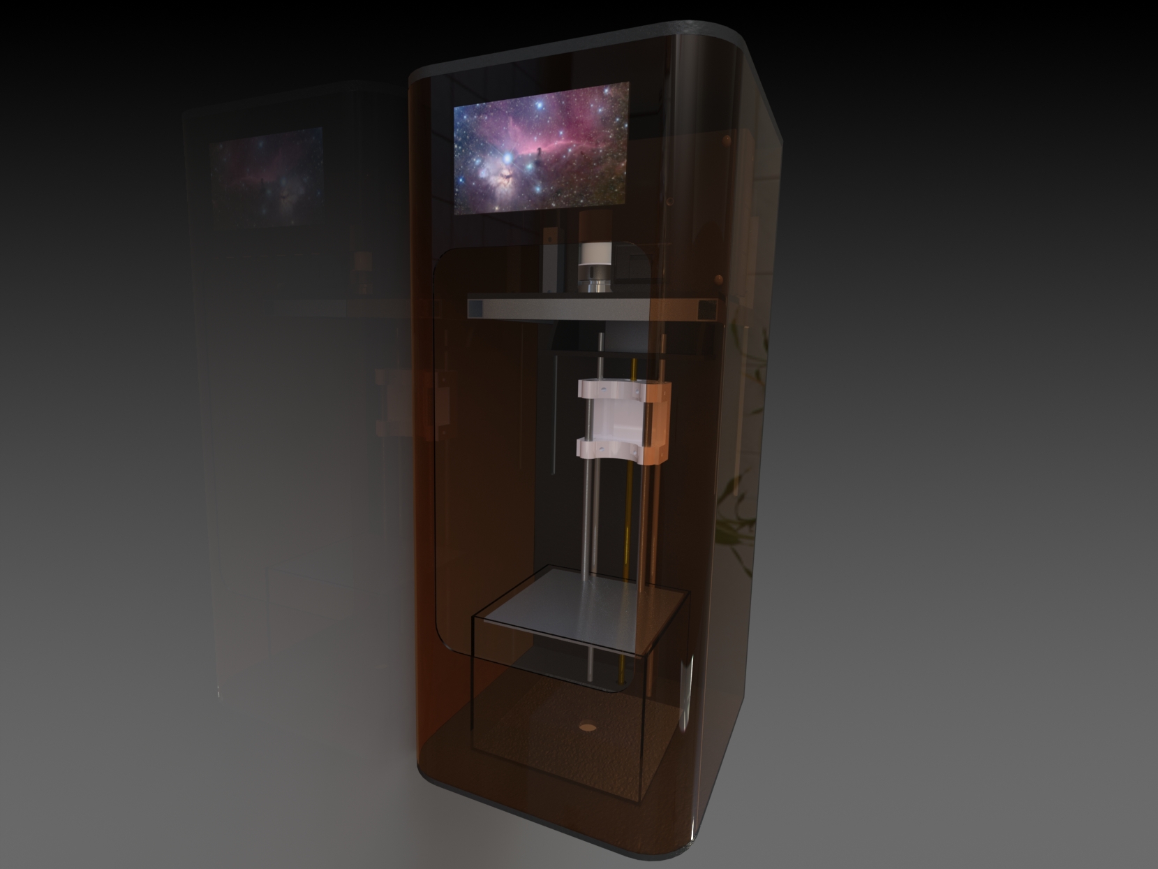

I started with a crude model to a get an idea of how everything would move as I really had no idea what I was doing...

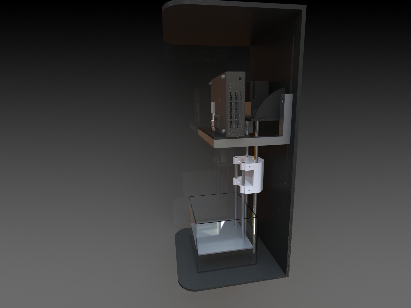

I played around with mounting the projector horizontally with a mirror to cut down on the height of machine, but decided in the end this was too complex initially and would reduce the amount of re-positioning I could do of the projector.
By the end I have this, which I think looks the part, but whether its any good is an entirely different question - but I guess that is what prototypes are for right?
The screen is an extra I 'might' add in the future, to display current layer and replicate the projector output from Nanodlp.

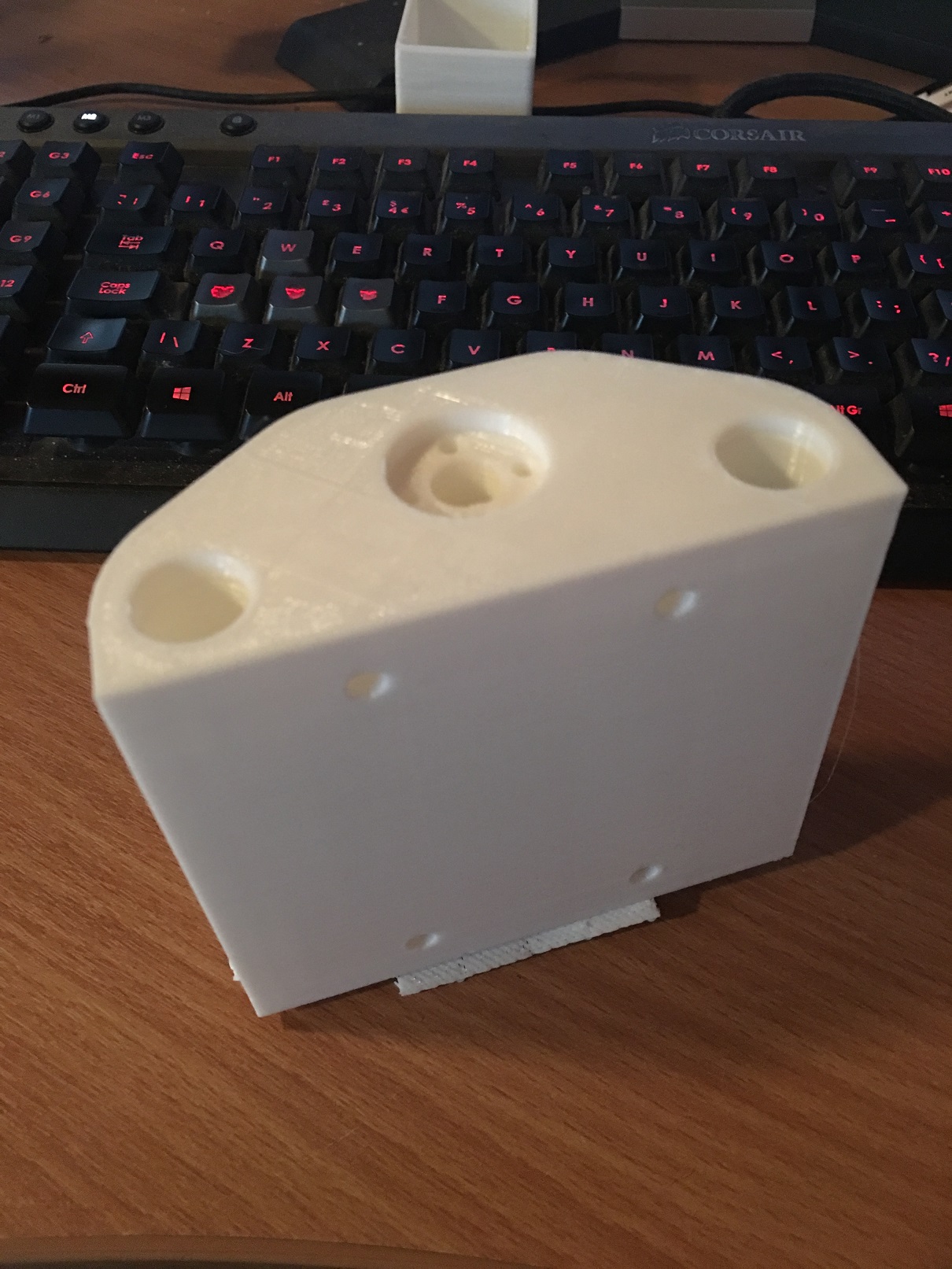

I also had a go at printing the large block that contains the bearings and lead screw nut for the z-axis - its worked quite well. Which is ironic as it seems to be the only good print I have had out of the CTC printer.

Nice build.
That vat you have is HUGE for top down. I hope you will be using salt water in addition to your resin if you plan on using such a big vat. I have also been working on a top/down machine here for some time. I have started very small and intend on extending my build plate if I see success with smaller prints first.
All the best.
