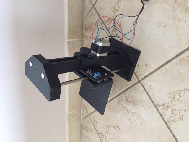

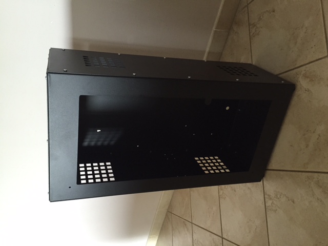

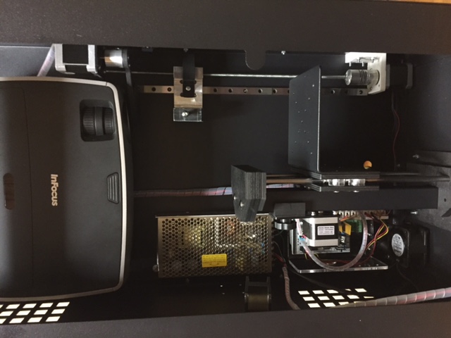

hello everyone I am new to this forum I would like to present my creation in aluminum 1.2mm thick laser cut, internal movements in birch electronic retrieval by printer fmd shutter tilt and vertical height adjustment to change size resin tank. what do you think?
