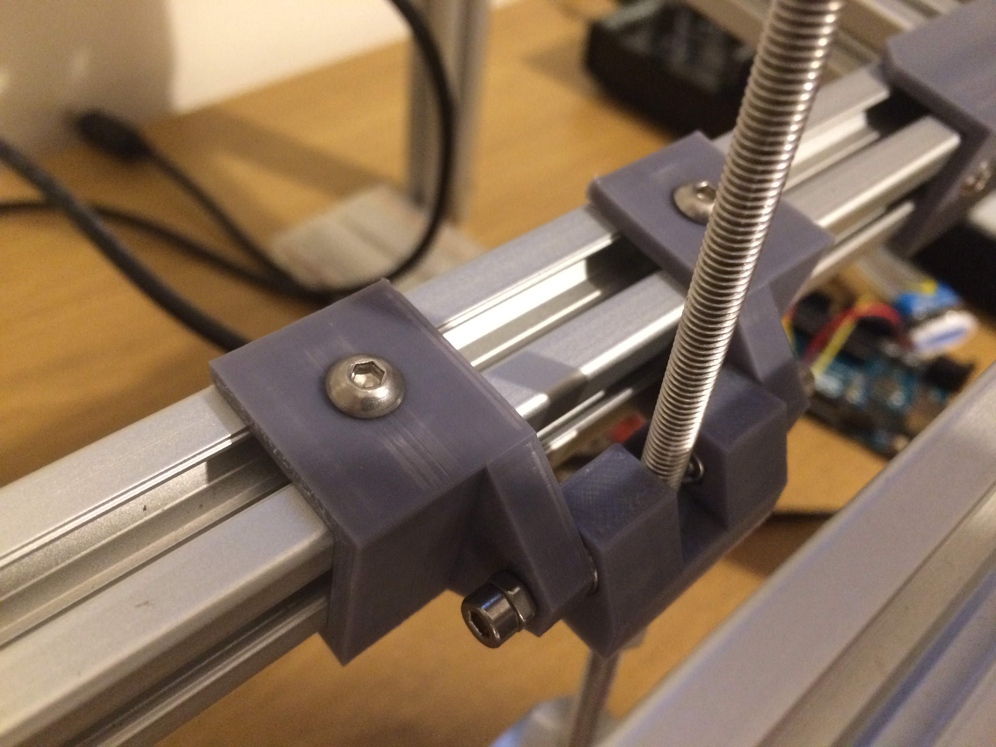

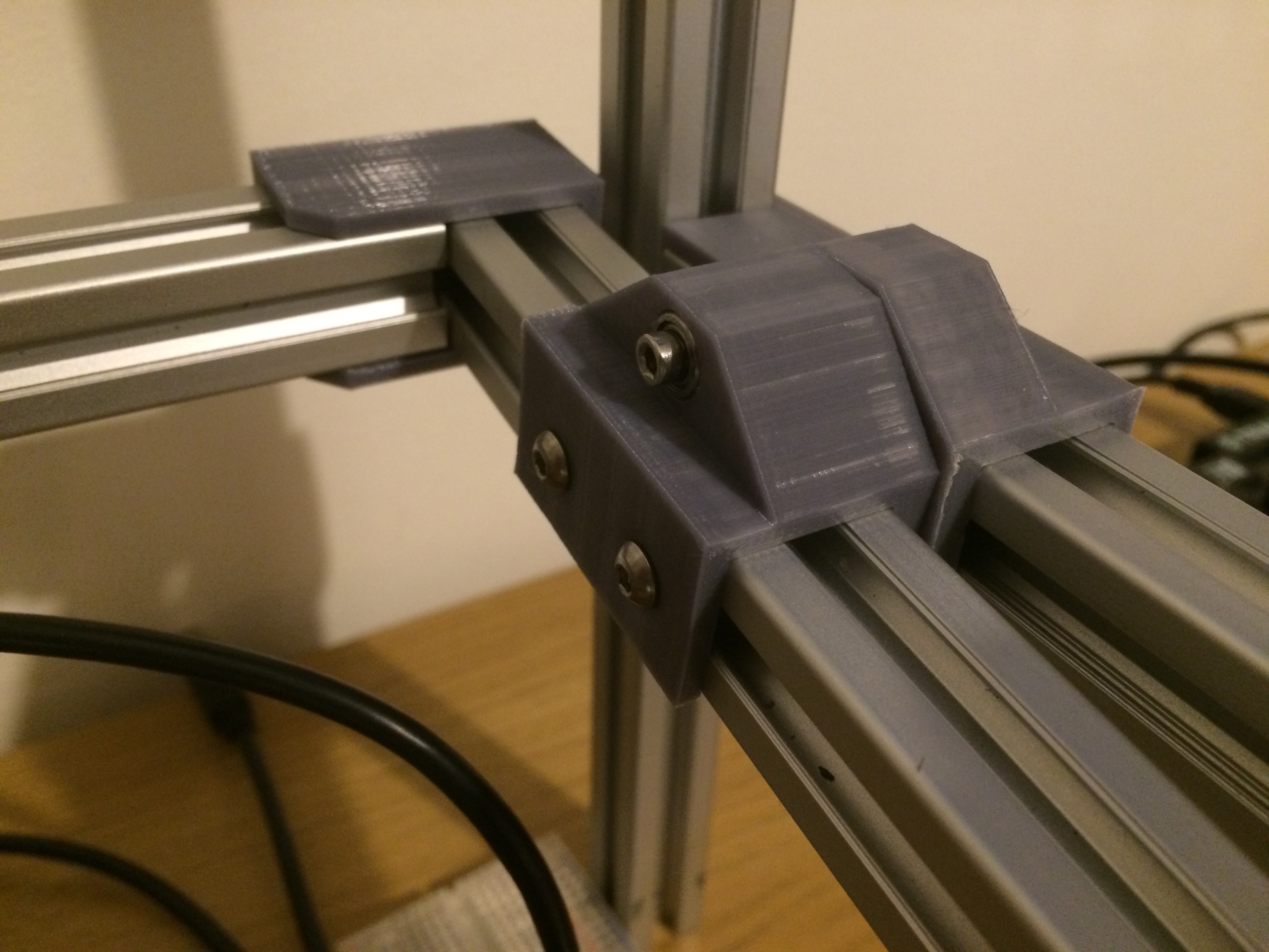

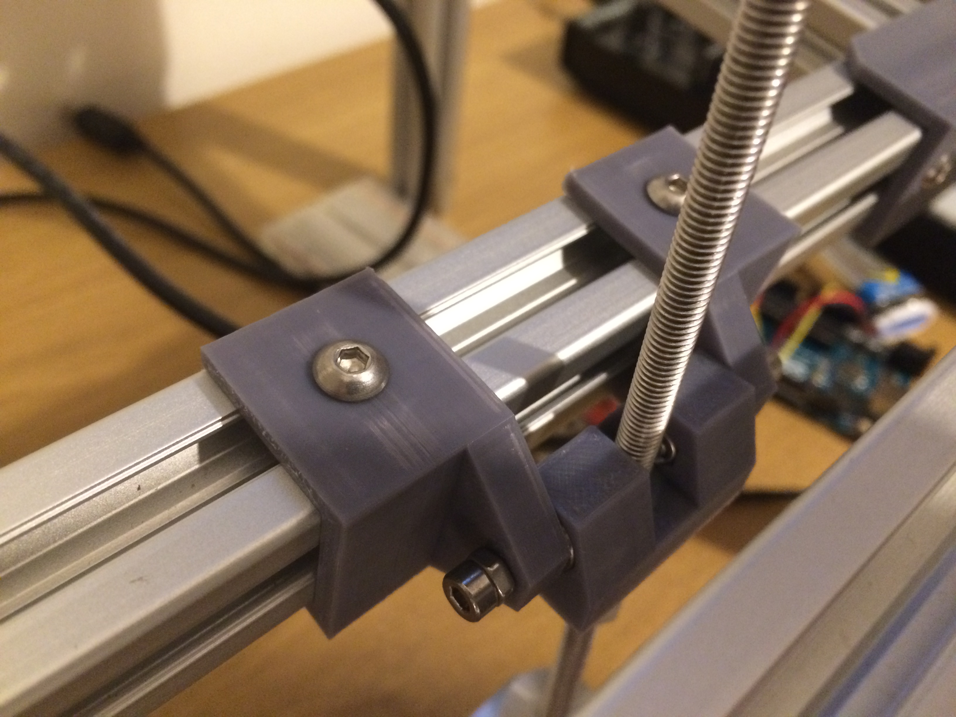

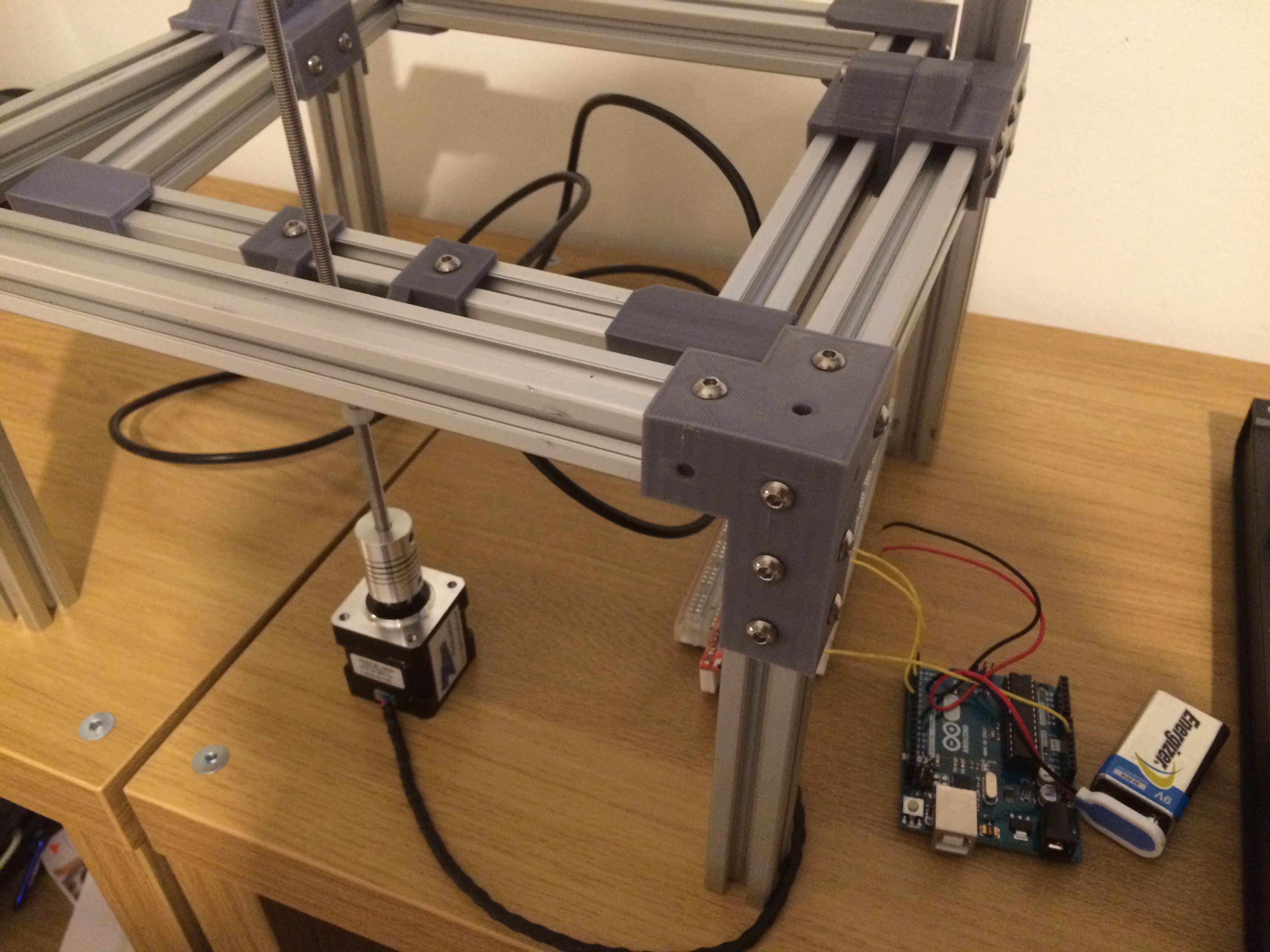

I have decided to base my design on the LittleRP to an extent, but instead of a laser cut enclosure/frame I am going to go for the same style as used in the Foldarap Reprap printer with 3D printed corners and connections. I actually considered using an almost identical design to the Foldarap, utilising the same Z axis mechanism however I dont think it would be as accurate as I would like.
I will use the same type of Z axis mechanism as the LittleRP, using a servo leadscrew and a linear bearing rail/block.
I am in two minds whether to use two mirrors so I can mount the projector behind the z axis facing down, I'm not sure if this is the best idea or not? If the projector is safe enough to put here I will as it will reduce the footprint of the printer.
I haven't thought about the printing vat and build surface yet, I will just have to make sure I make the rest of the design flexible enough to accomodate whatever option I go with.
