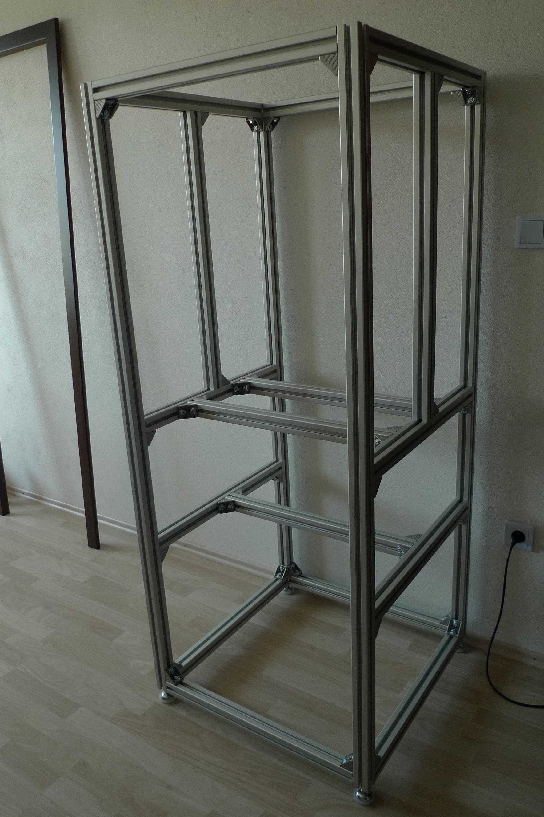

Hi, I wanted to design a 3D printer frame which could host hardware for SLA or SLS manufacturing process, could be completely enclosed if necessary and would allow easy switch between bottom-up and top-down. This is the result I constructed last year:
The frame

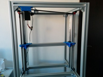

Top section of the frame was equiped with Z-axis linear guides and ball spindles on both left and tight side. It is currently driven by single timing belt, however I am considering to drive both sides with dedicated steppers and perform peel action by independent movement of Z-right and Z-left.

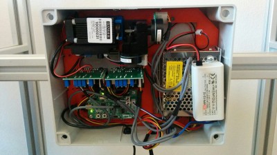

In the bottom section there is Lasershark-based "laser projector" mounted on an extrusion profile:

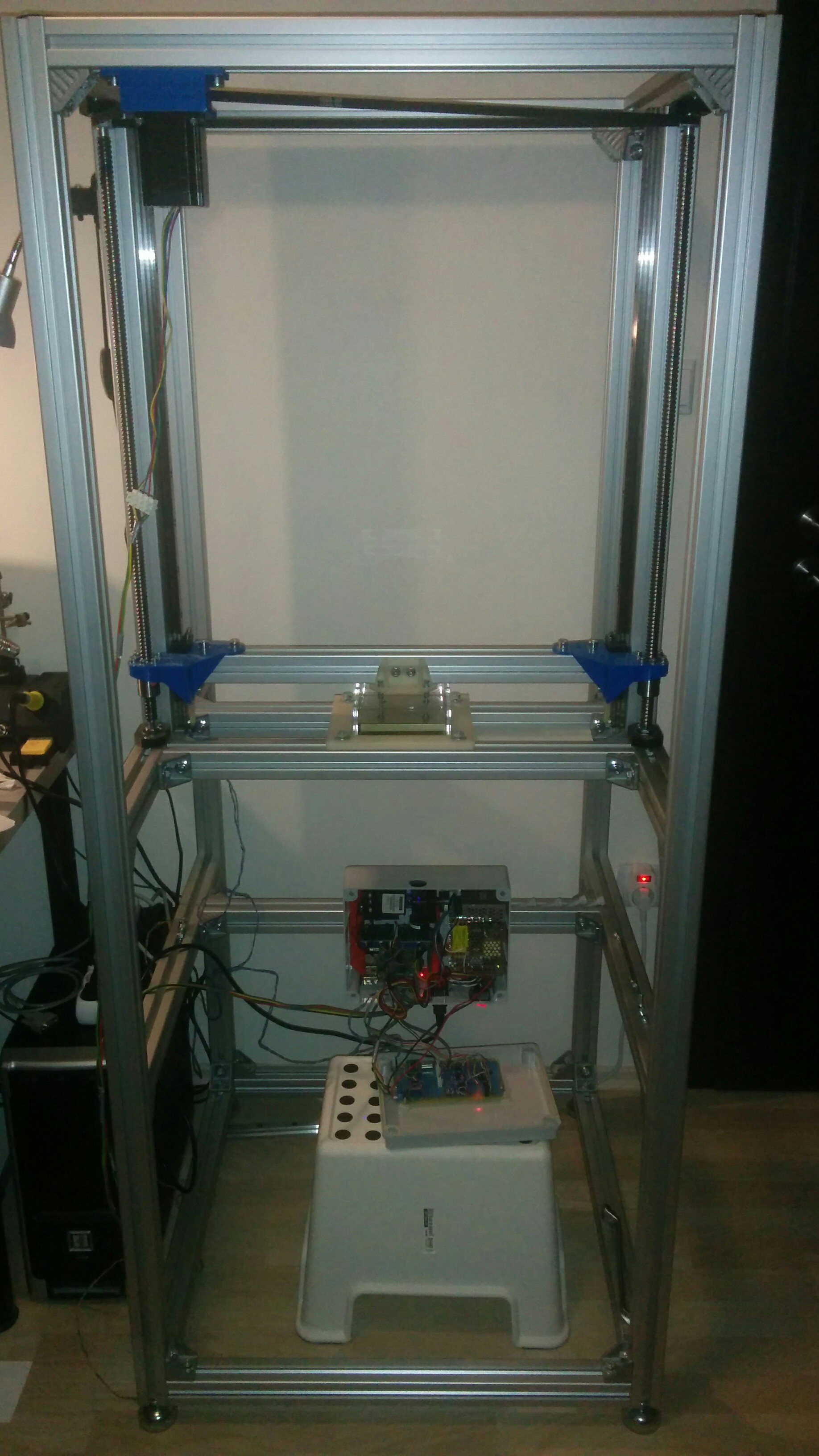

An update after a long time - this is how the frame looks right now. In the bottom part you can see the projector with my own electronics driving the galvos and stepper.
The frame

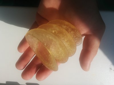

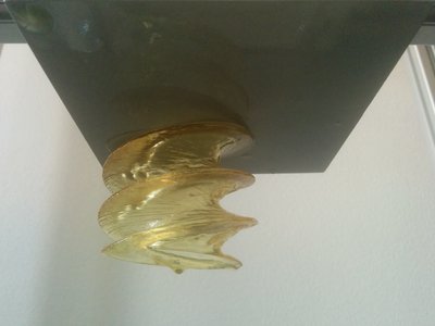

And this is one of first test objects - not very clean, but it works:
Test object
Test object
Next steps are experiments with VAT using Drago's sheet and improvements on the SW side.

HI Daniel,
Good job! I have a question. Why you do not use a mirror to adjust the distortion and to save a space? I think it's better. I use an adjustable mirror and two sliders.
Drago

dragokirov
Posts: 81
Joined: Fri Oct 17, 2014 1:06 am
Re: SLA printer build
Postby dragokirov » Thu Jul 09, 2015 6:49 am
The adjustable mirror allows to tune the laser in correct angle of projection much easier. In this case It is not necessary to move and adjust the box or the galvo. And something else. You can put plano-convex lens on the bottom of your VAT for better accuracy.
