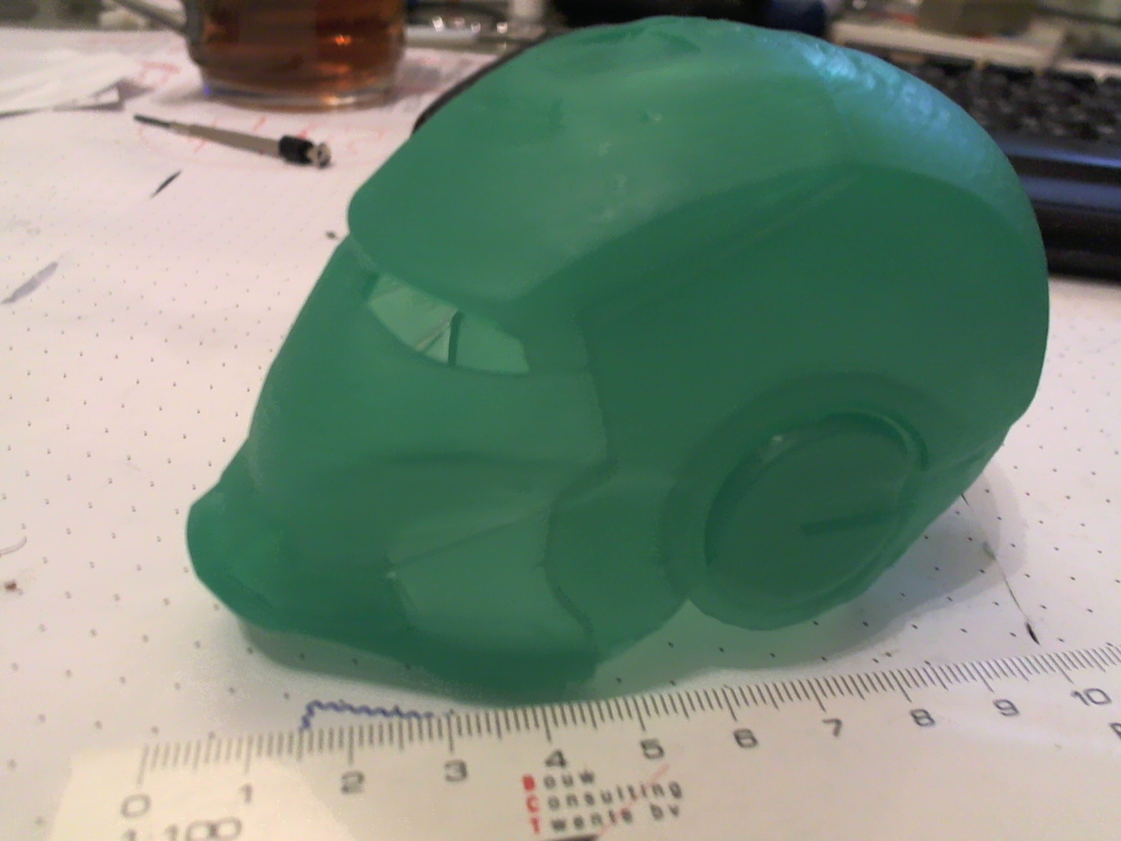

Yesterday i tried to print Ironman.
here is the result:
looks like the top part i did to fast a good learning lesson
the mask part came out really awsome!
my DLP build
Re: my DLP build
and here is the completed print.
~60 micron xy
100 micron in z
z speed: 200
exposure: 1900ms
first 5 layers: 6000ms
print duration: 1:39
resin: makerjuice subg+ mixed with subflex
~60 micron xy
100 micron in z
z speed: 200
exposure: 1900ms

Re: my DLP build
Hi snow, this is all done with an unmodified projector. the aproaximate xy resolution is based on 1920 x 1080 resolution on 192 mm x 108mm = 100 micron - if you project on an area of 48mmx 27mm you would have ~25 micron per xy area.
i think this is probably the maximum resolution.
Re: my DLP build
Very nice print!
What is the average printed wall thickness of the mask?
Re: my DLP build
Hi Edge,
i've measured 1.5mm so i guess average.. 1.5 - 2mm
