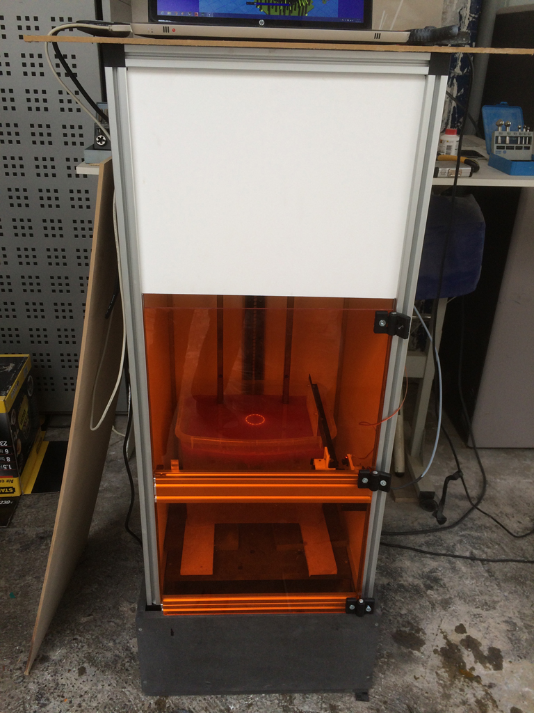

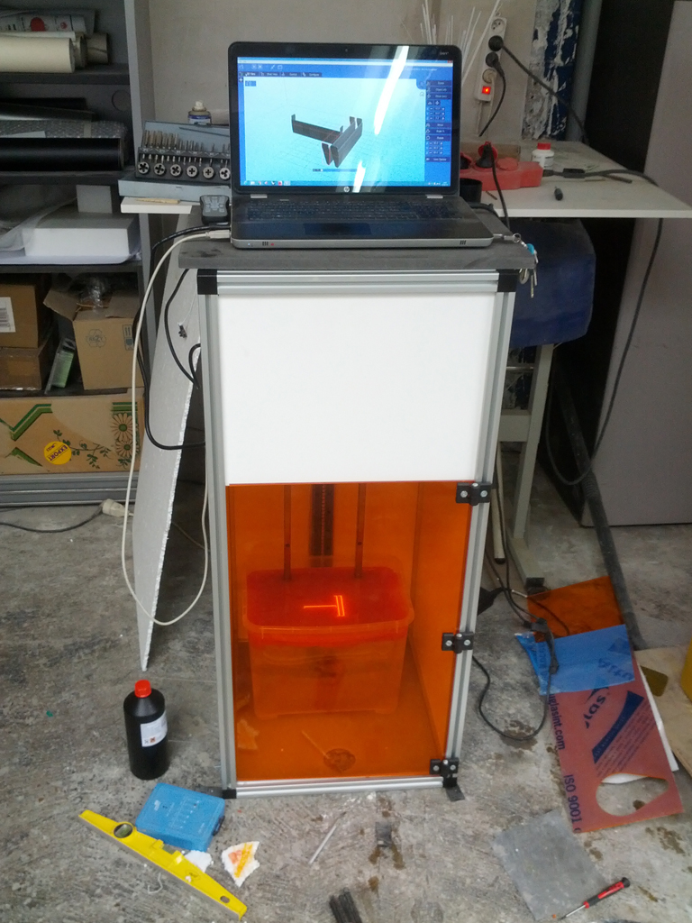

Here's my top down DLP printer.
It's still under progress.
first version
This is the first version without wiper.
The wiper is actually needed because when the printed surface became too big, the resin was forming like a bubble.
Now I'm doing some tests with the wiper but it still needs some tweaks.
second version with wiper
As Z stage I had a THK actuator in stock with a 10mm pitch.
The projector is an optoma HD230X
I'm using red resin from Funtodo
The actual vat is a plastic vat from the supermarket but I ordered a new bigger one in glass.
I will also add a system in the vat so the resin surface allways stays at the same height.
Sorry if my English is weak :roll:

Looks like a very nice and clean build. I like the one arm wiper setup, do you have any videos of it in action?
