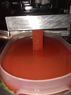

another learning moment today. if the mirror is not absolutly clean.. it will create wierd print effects.. ugh!

hi hp_, i read 3 post ago you tried to print at 25u. have u build a part succesfully at this resolution? i am planing a rig with a 1080p projector with a flex vat to make jellewry parts, so print at 25u will be amazing . nice job!

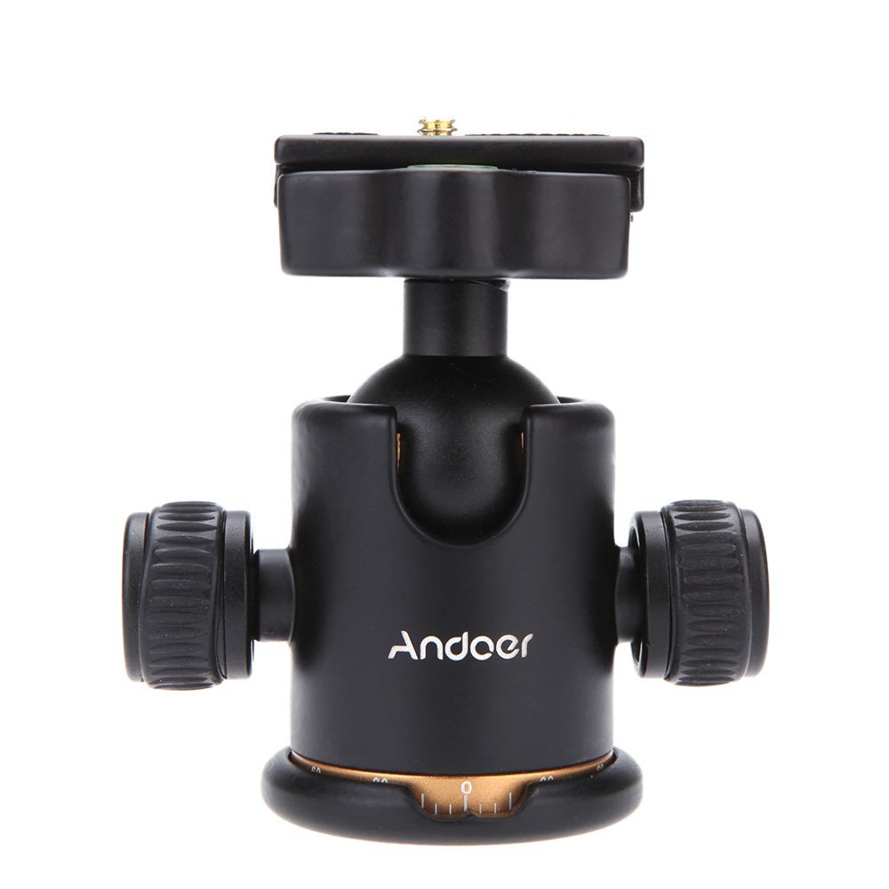

i just notice in another post you are using a camera ballhead to fix and adjust the mount plate. Is easy to adjust?

it is very easy, the thing i was looking for was the load the ball head mount could take.. mine can take up to 8KG of load..

Are the prints above made using the flexvat you sell currently on your webshop ? and does it passive peel or do you have to attach the vat in a way that it can lift on 1 side ?
2nd question: what camera ballhead are you actually using ? I will need to buy one too

the vat is fixed, the flex of he film causes the tilt on micro level.
