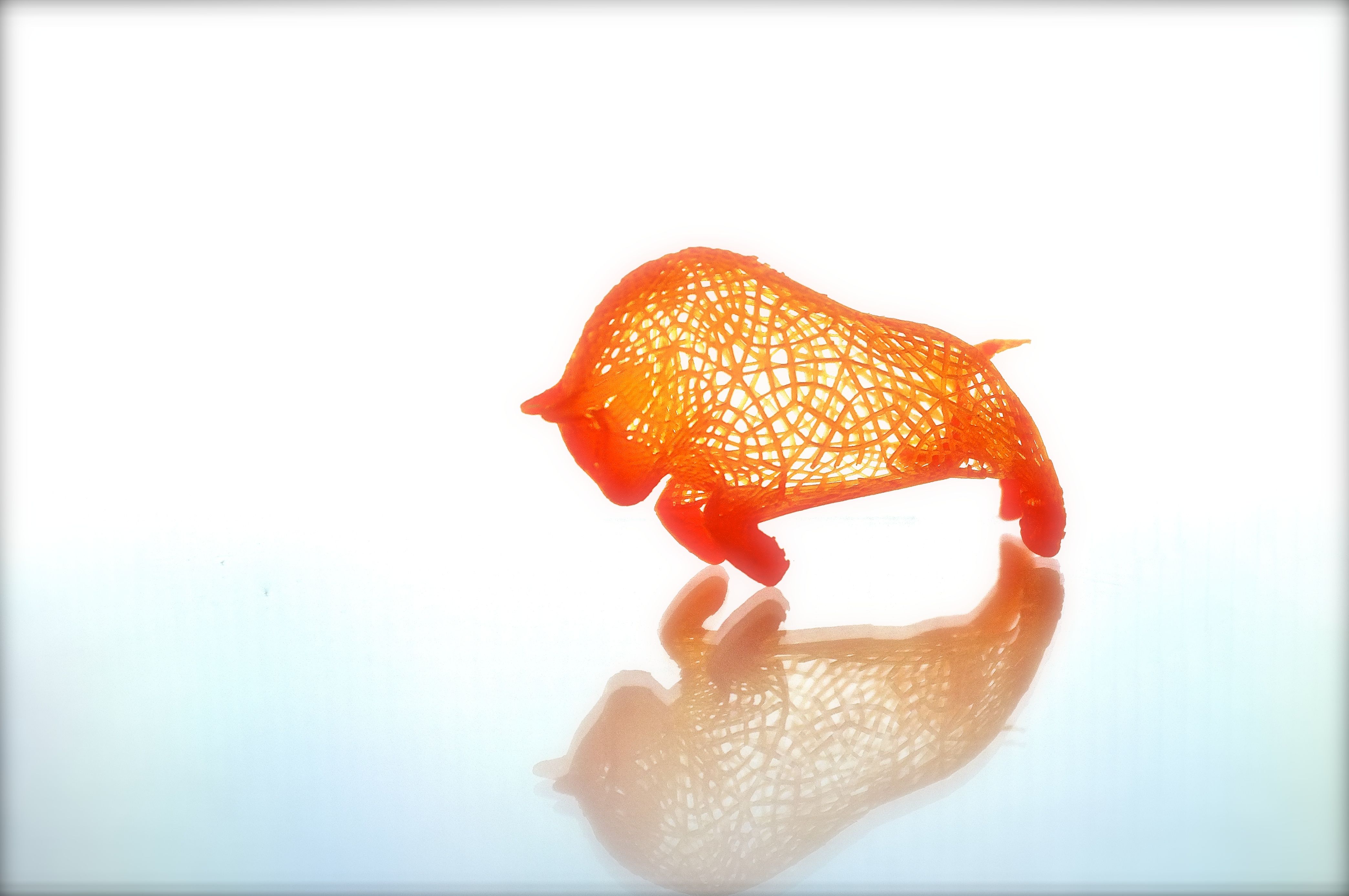

Re: 3D DLP printer greatly improved print quality with flex
Hi Szzer,
checkout the bull we printed ..
also Flex VAT
Cheers,
also Flex VAT
Cheers,
