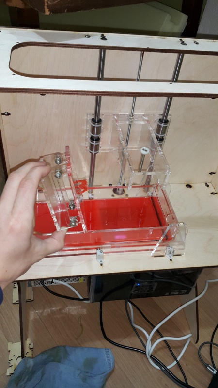

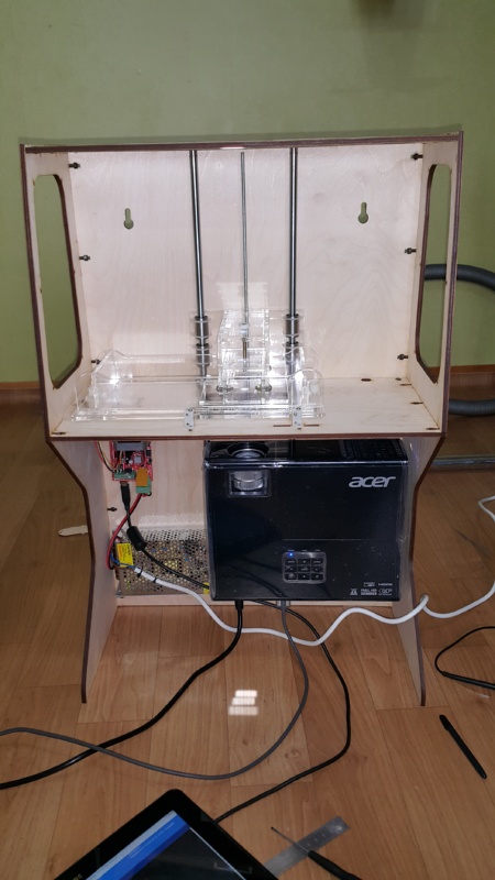

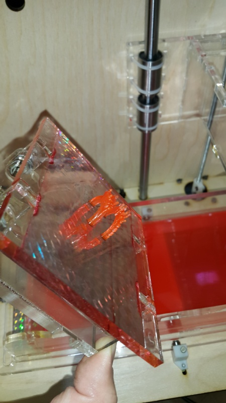

I thought about z wobble. That's why I use 4 lm10uu. Will see. But if something will go wrong I can redesign vat tilting and change only one plywood part - floor of the machine.

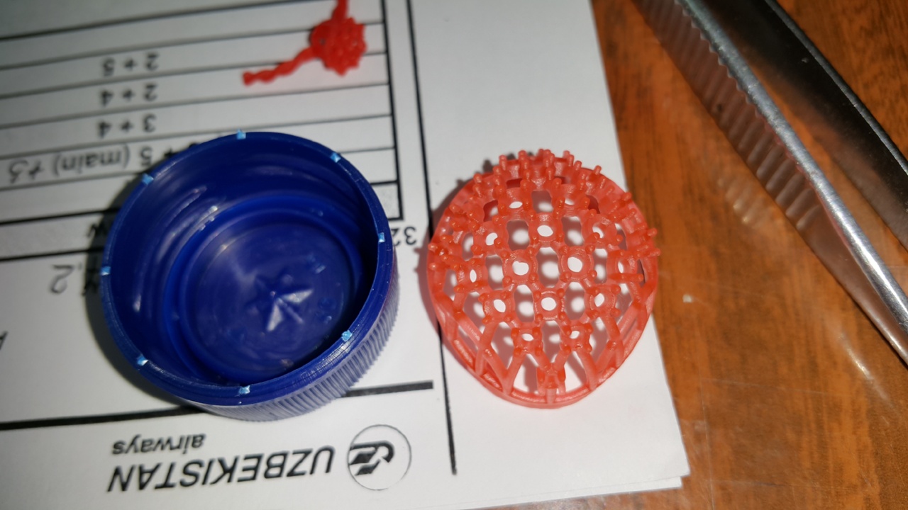

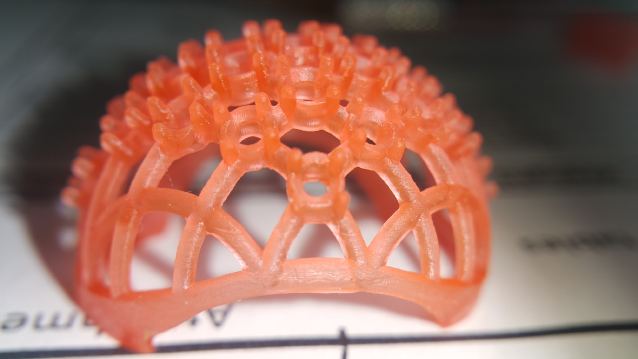

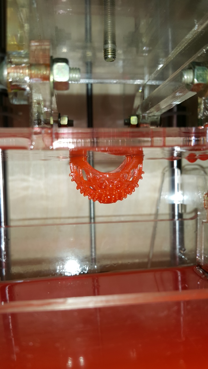

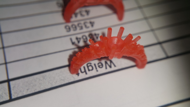

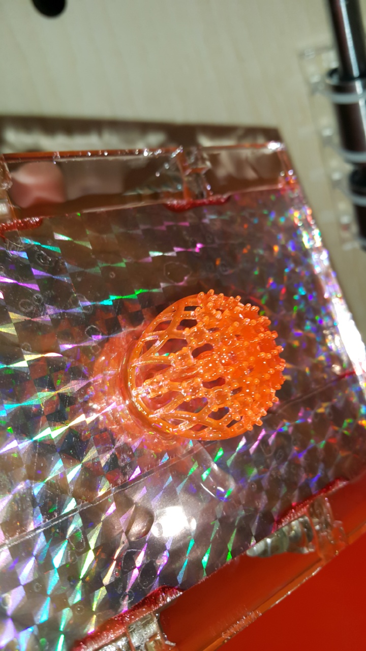

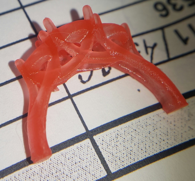

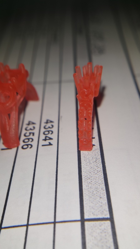

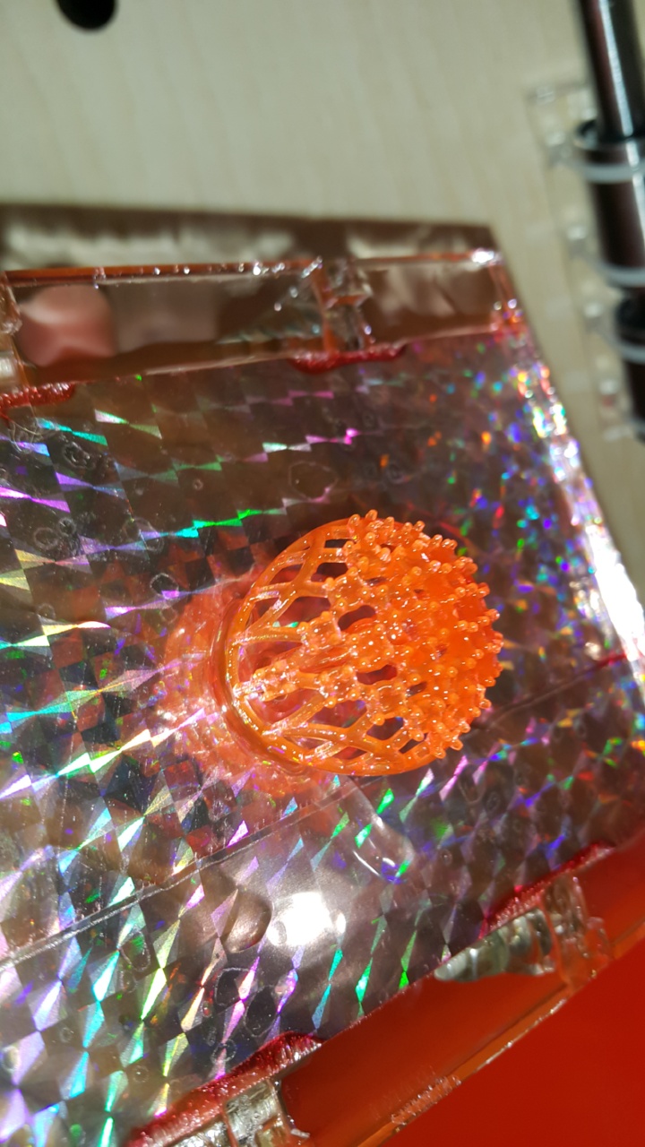

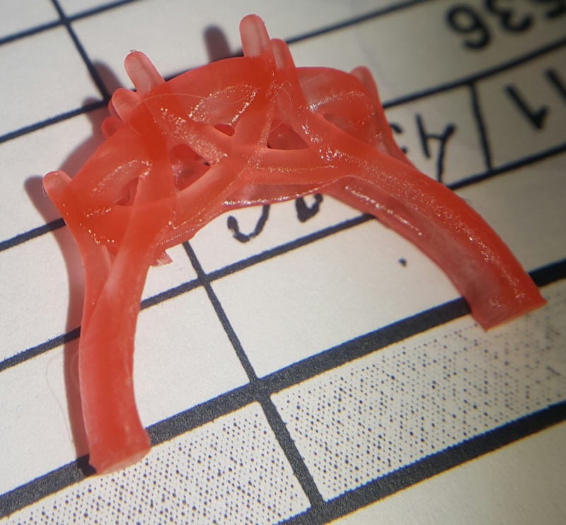

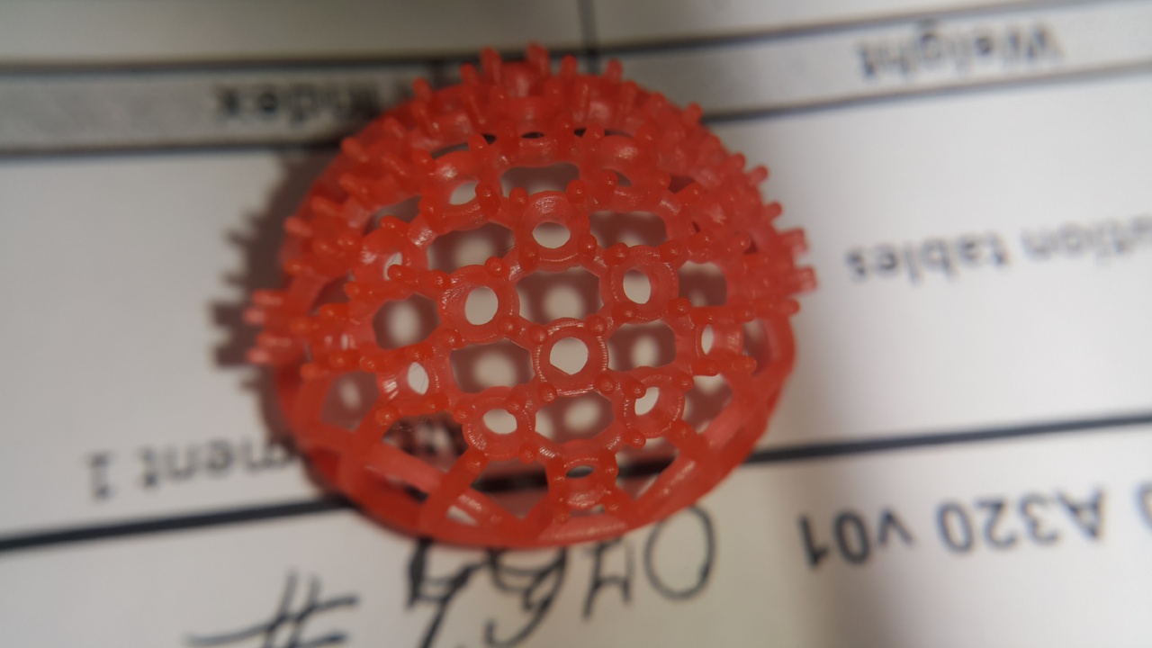

Everything go not so smooth as I want, but it prints very nice.
I need to redesign wiper.

What are you using for your build plate? Looks shiney
