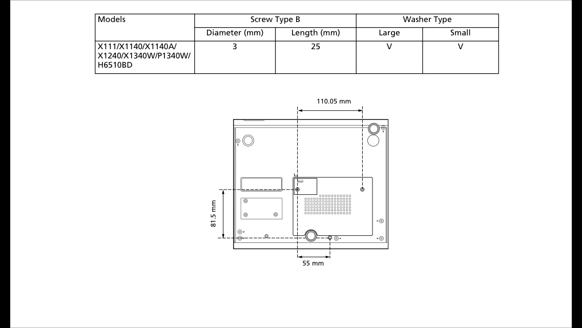

Can you provide the dimensions of the bolt hole pattern for the Acer H6510BD projector?

Edit: I need two more dimensions, as the blueprint is missing the offset distances from the sides.
