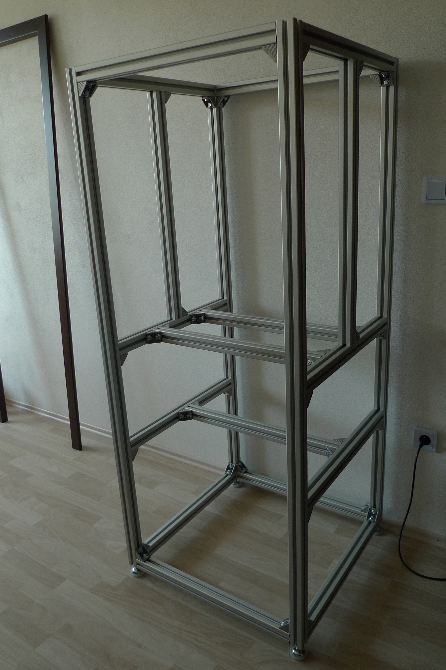

Hi, I wanted to design a 3D printer frame which could host hardware for SLA or SLS manufacturing process, could be completely enclosed if necessary and would allow easy switch between bottom-up and top-down. This is the result I constructed last year:
Top section of the frame was equiped with Z-axis linear guides and ball spindles on both left and tight side. It is currently driven by single timing belt, however I am considering to drive both sides with dedicated steppers and perform peel action by independent movement of Z-right and Z-left.

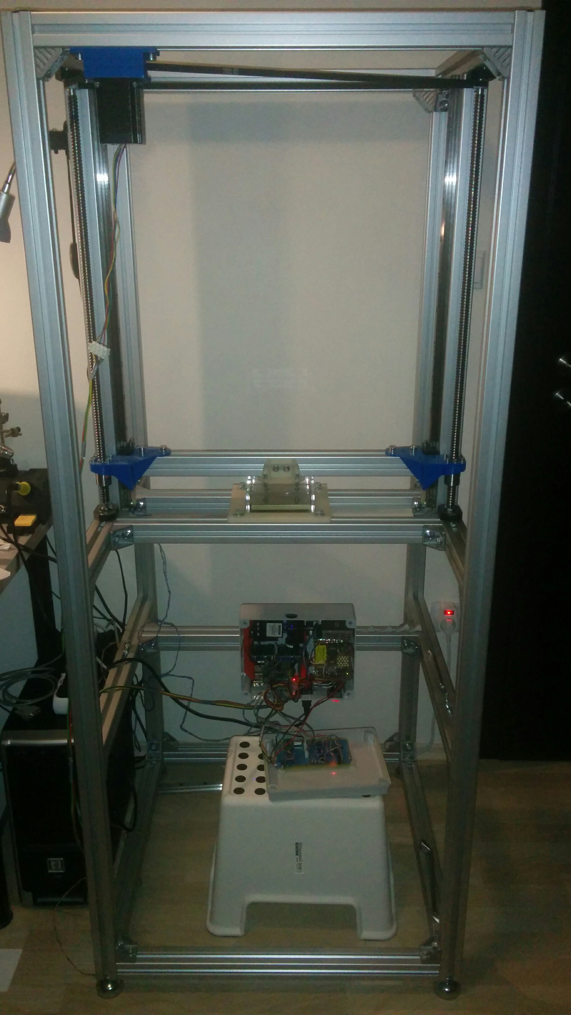

In the bottom section there is Lasershark-based "laser projector" mounted on an extrusion profile:
Z-axis electronics is missing - I have Megatronics v3 prepared on my table.
Build platform is missing as well - it will be mounted on the extrusion connected to linear carriages.
I only have small VAT from Pryntech kit available at the moment: http://pryntech.com/?product=optically- ... crylic-vat
I will build larger VAT later.
What kind of VAT construcion and peeling mechanism would you recommend?

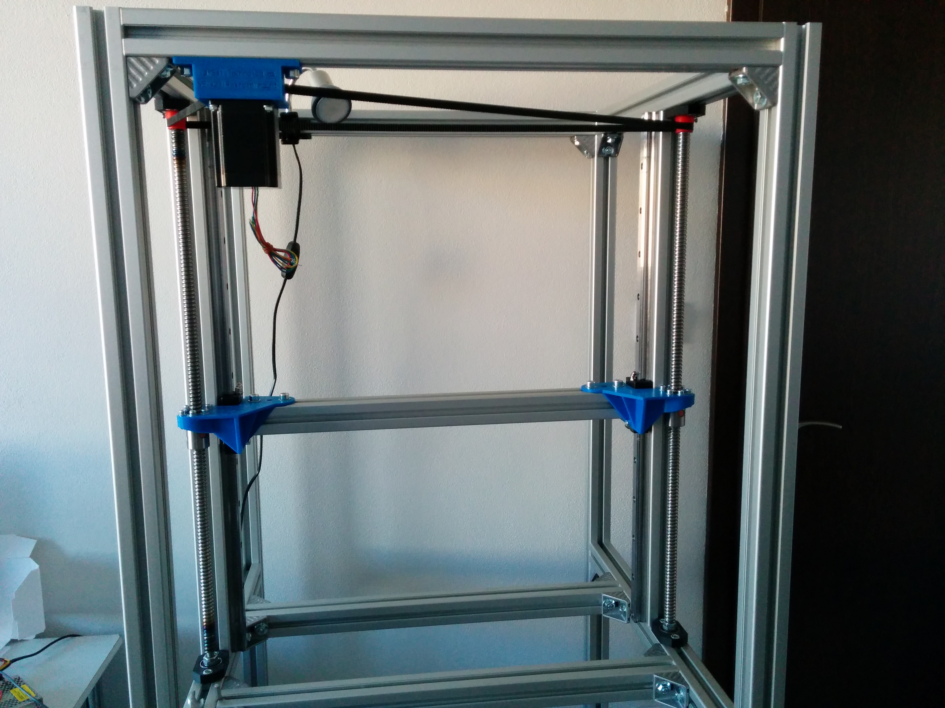

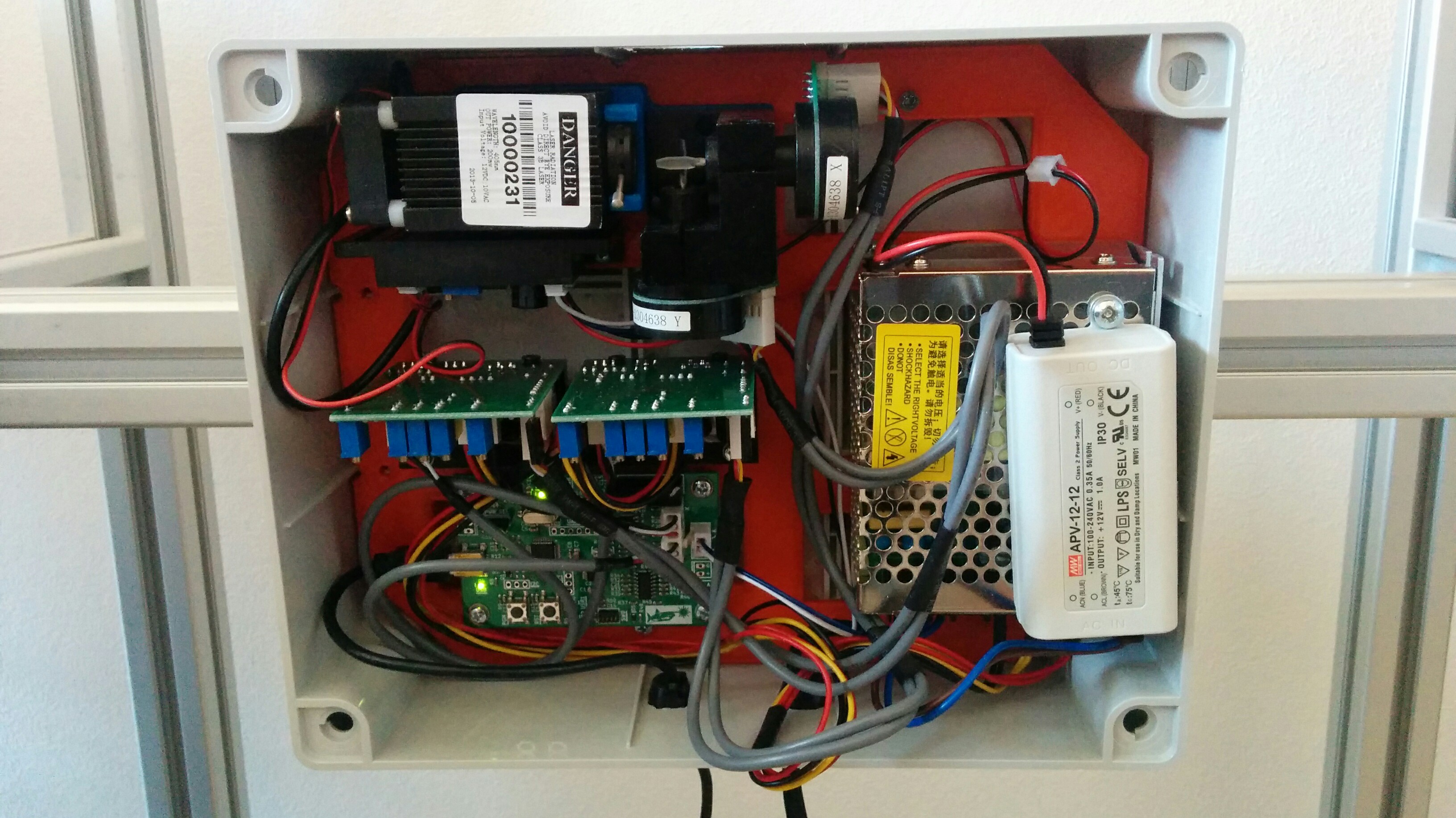

An update after a long time - this is how the frame looks right now. In the bottom part you can see the projector with my own electronics driving the galvos and stepper.

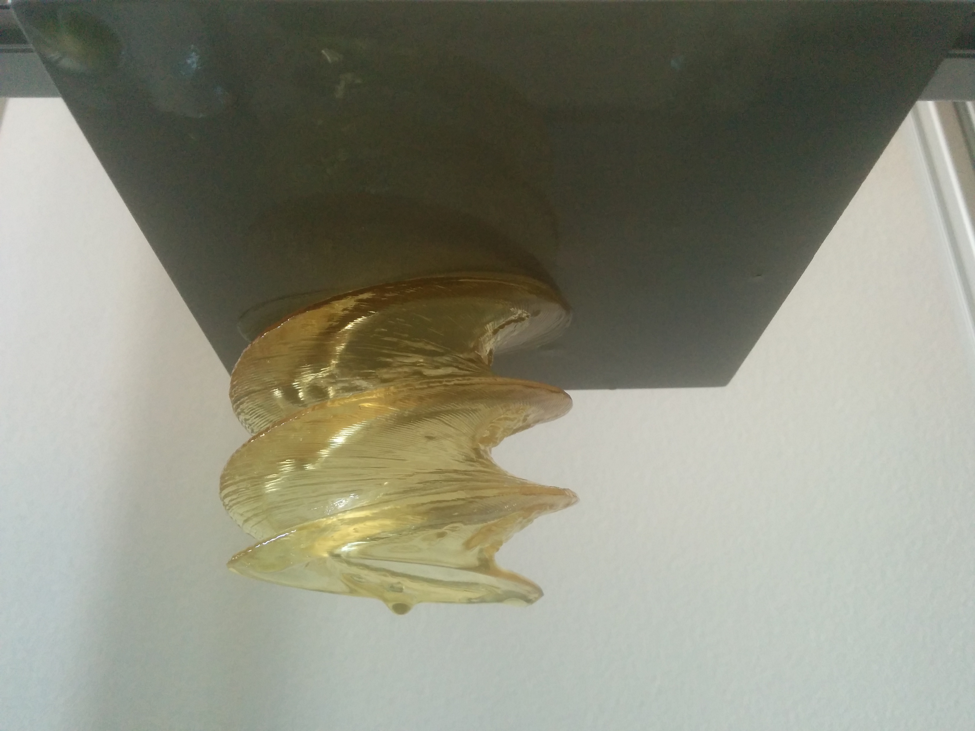

And this is one of first test objects - not very clean, but it works:
Next steps are experiments with VAT using Drago's sheet and improvements on the SW side.

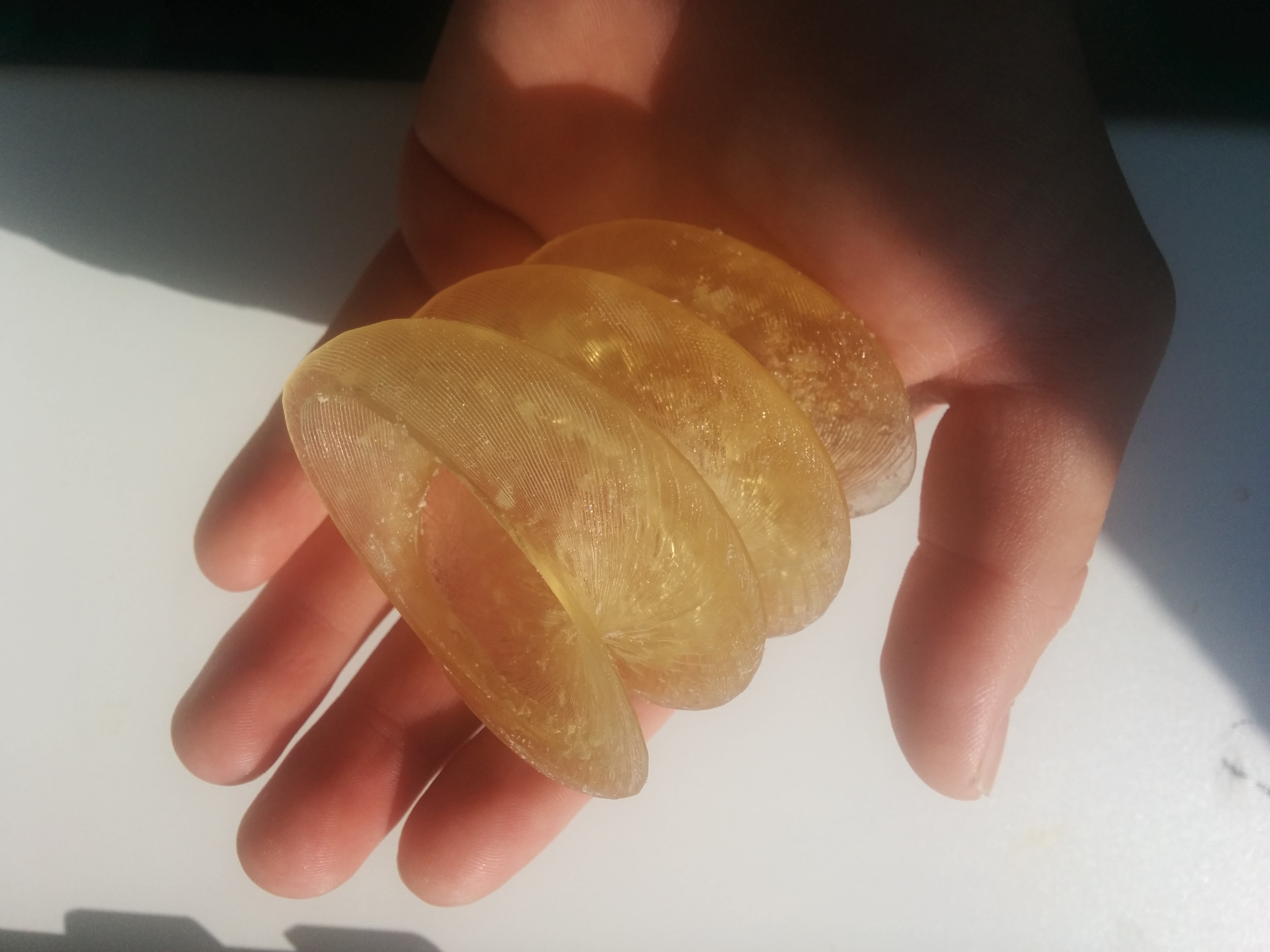

Good job! I have a question. Why you do not use a mirror to adjust the distortion and to save a space? I think it's better. I use an adjustable mirror and two sliders.

Could you please elaborate more on how the mirror can be used to adjust distortion?

The adjustable mirror allows to tune the laser in correct angle of projection much easier. In this case It is not necessary to  move and adjust the  box or the galvo. And something else. You can put plano-convex lens on the bottom of your VAT for better accuracy.
