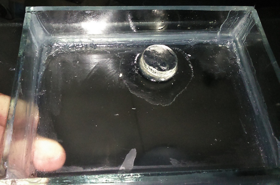

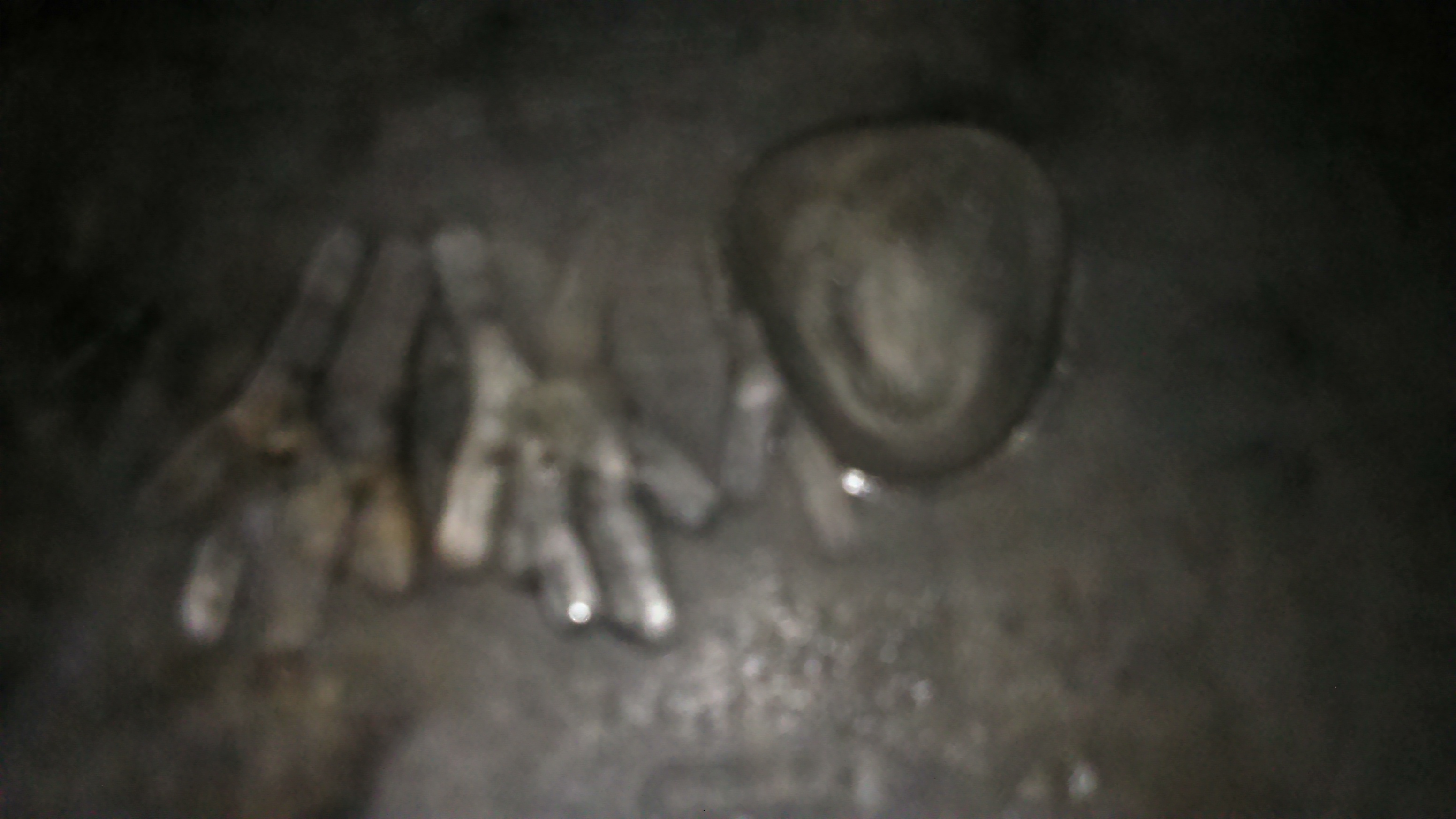

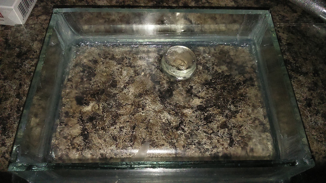

At this moment my printer print inside my reservoir. Is it because i have a glass plate under and a reservoir. Is it possible that it reflects on top to bottom. Any help please. O and the attachment i moved the scope that is why it moved but the problem is the print inside reservoir and not to printbed.

anodizing your buildplate might help with reduction of your problem of reflection

I have even paint the printed for it not to reflect the light back and same story. The part print in the reservoir. Not on bed ??

Why are you trying bottom up?
Try top down with a wiper.

anodizing would definitely solve the issue, but have you tried painting it black ? or perhaps scratching the surface with sand paper ?
