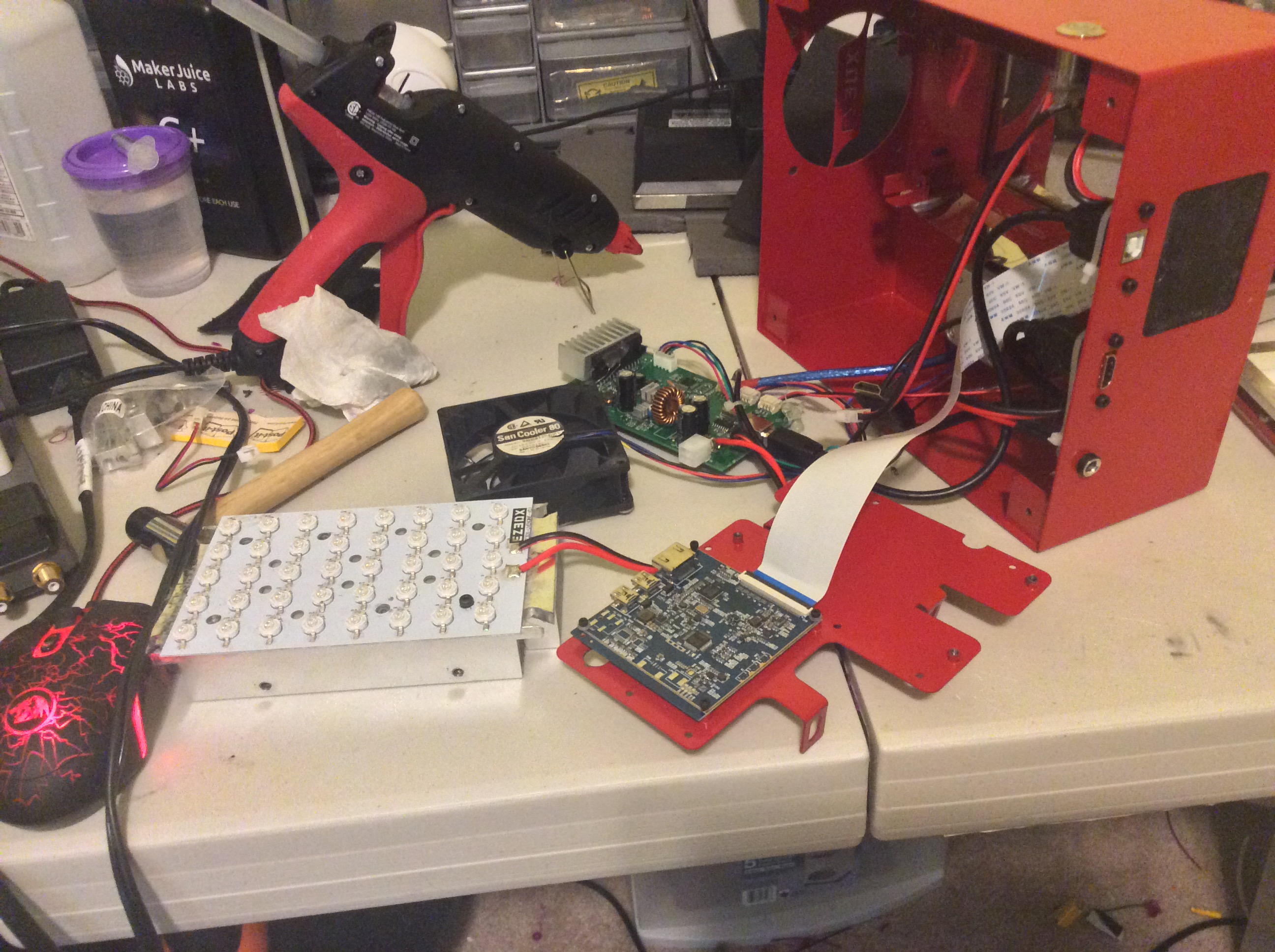

I have been doing a bit of a tear down to see about doing upgrades. First off a bit of background, this printer was advertised as being very similar to the proniks 2k sla printer with a raspberry pi.  As it turned out, it did not have the raspberry and the firmware doesn't even really use gcode so you are such running prints through their software.  It's inconvenient but not all bad.  I still haven't dialed in my exposure times, and I'm a bit new to sla.  I've been working with makerjuice white and have been getting things to set at 15 sec.  My biggest problem is things sticking.

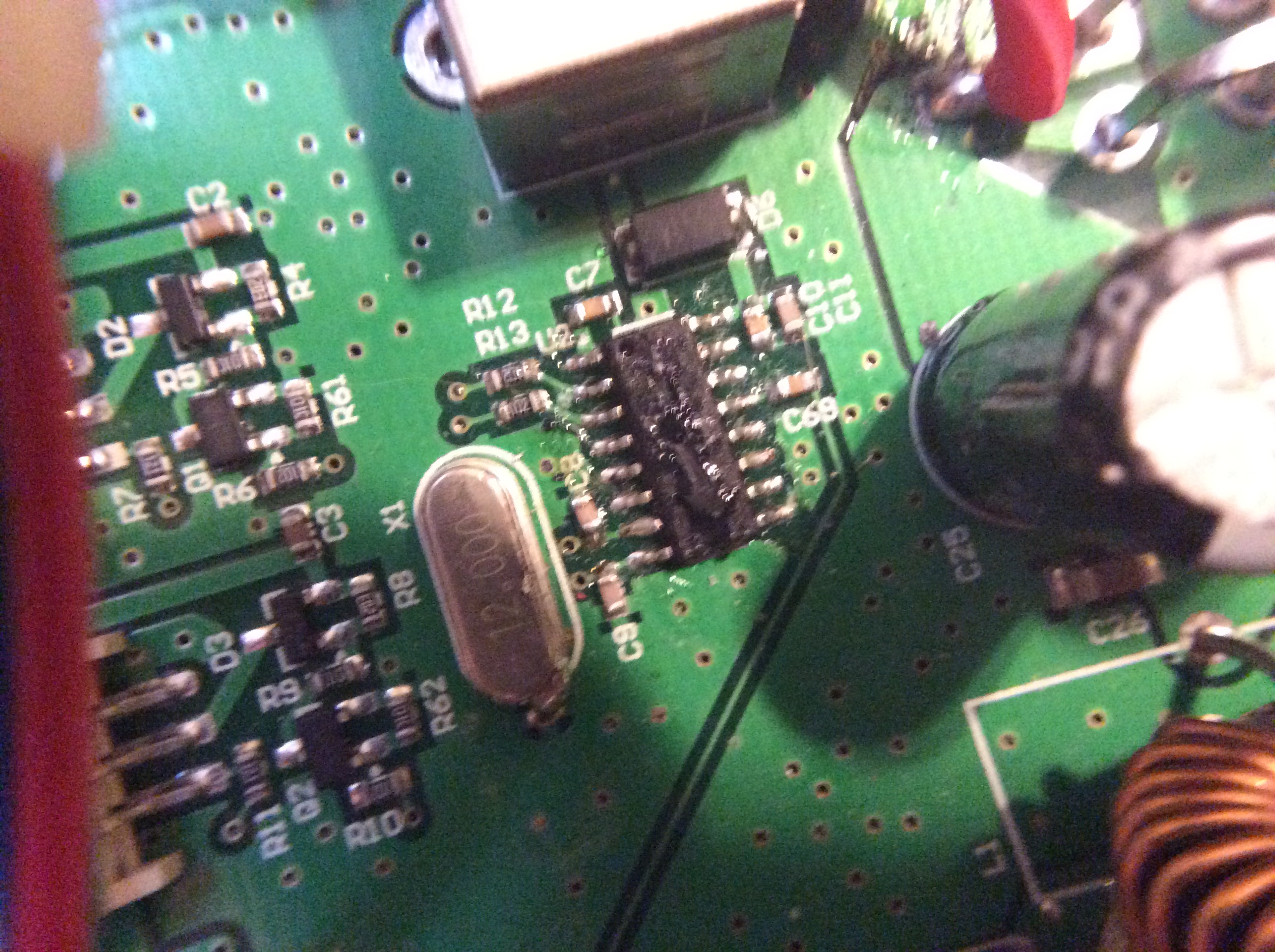

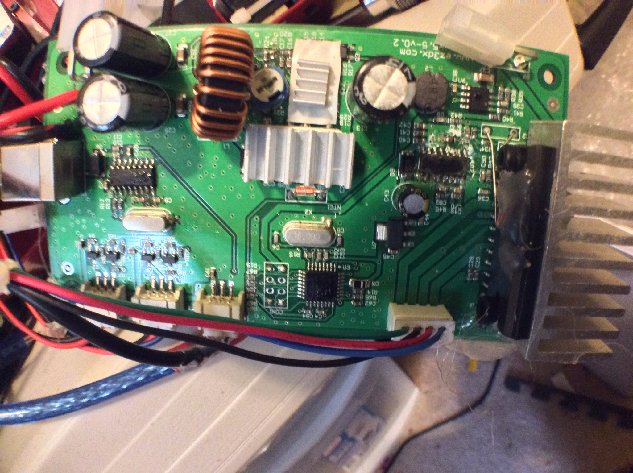

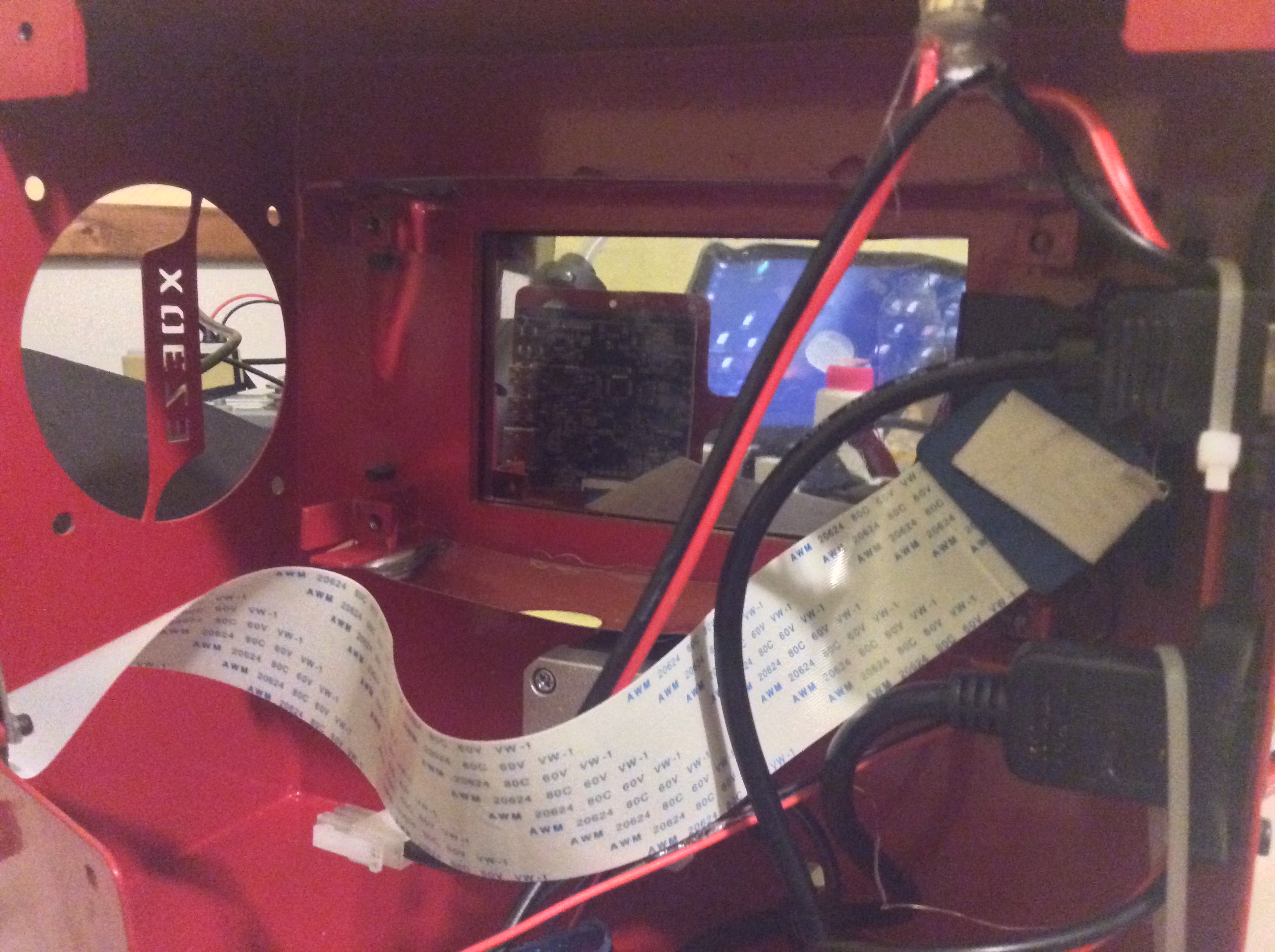

Opening the machine there are to main boards. The typical driver board for 2k 5.5 screen you see beings sold for VR. The other is custom board apparently.
The upper corner the website http://www.ez3dx.com is written and this board is version 0.2.  The site did not exist when I tried it.
The three major surface mount chips all show damage, or chemical residue?, similar to this. This is next to the USB port so I am assuming it's an ch340 chip based on drivers I needed to install.
I'm pretty sure its arduino based but that is about the CPU part.
The 3 headers in the bottom left corner are the fan screen, fan case and optical endstop from left to right.  The upper left is the power to the UV led array. There is a trimpot here, presumably to adjust the sourced current to the led. Upper right is the power input and it has been disconnected. Lower right is the stepper.

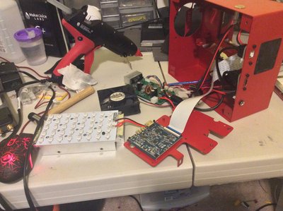

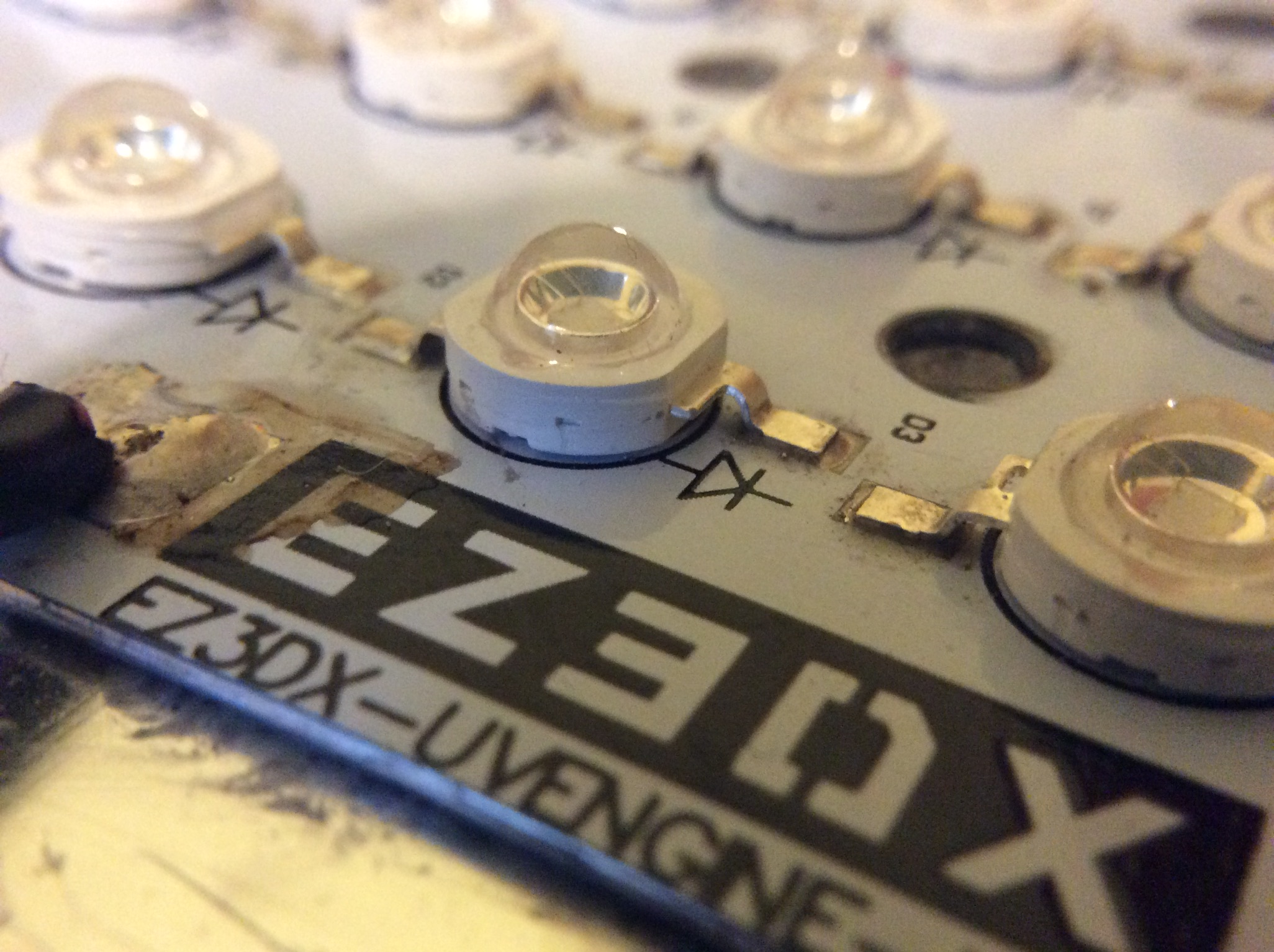

Lastly is this array of leds, it's 5x8 and attached to an aluminum heat sink. Original many where covered in brownish compound I assume was a themal compound.  I don't know anything more.
I'm making a few assumptions here, like the trimpot, and have no documentation.  Any ideas about the leds?  Figure out what wattage they are?  If they where 1 watt led, this would be a 40 watt array.  Is an array like that inefficient compared to a sing COB led?  Would it something else like the leds are PWMed down from their max.
Suggestions on how to proceed?  Anything other pics or that might be need or wanted? Thank you all very kindly in advance.

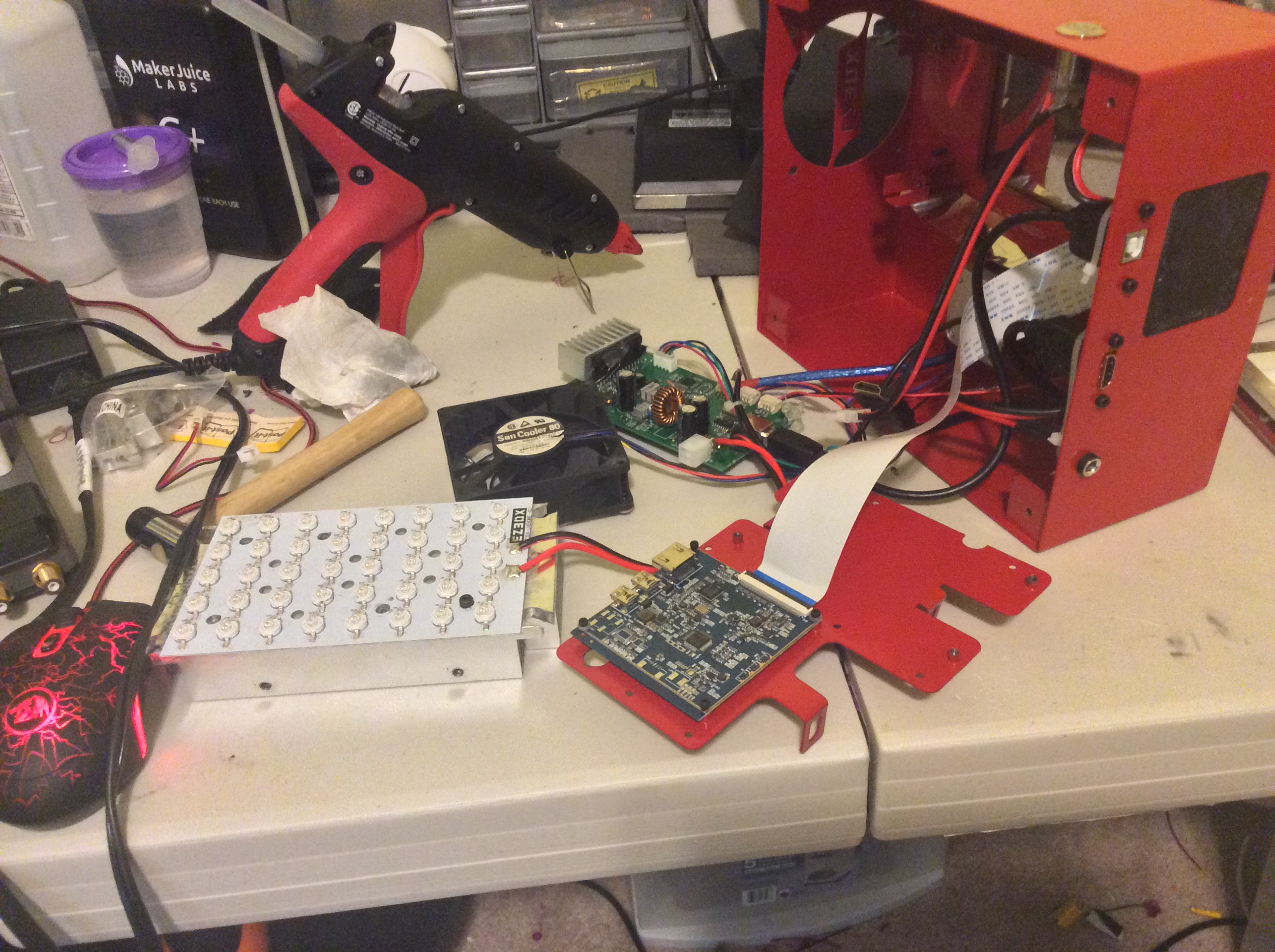

Continuing with the tear down.
The power supply outputs 24volts at 5 amps. I know think the area of the main board where the toroidal inductor and capacitors is a buck converter for the fans and LCD. The LED power is coming off opposite any the large heat sinker part and is grounded to the USB. This seems like bad practice if the leds are above 5volts, from a voltage isolation standpoint, is this a problem? Also discovered so heat sinks held on by double sided duct tape? Is this legit?
Returning to the leds, I took them off the heat sink to see the underside. It is straight aluminum. I don't what the tracings are or how to test it yet. I woder if it's getting a straight 24v and a mosfet is powering it, or whatever is under the heatsinks.

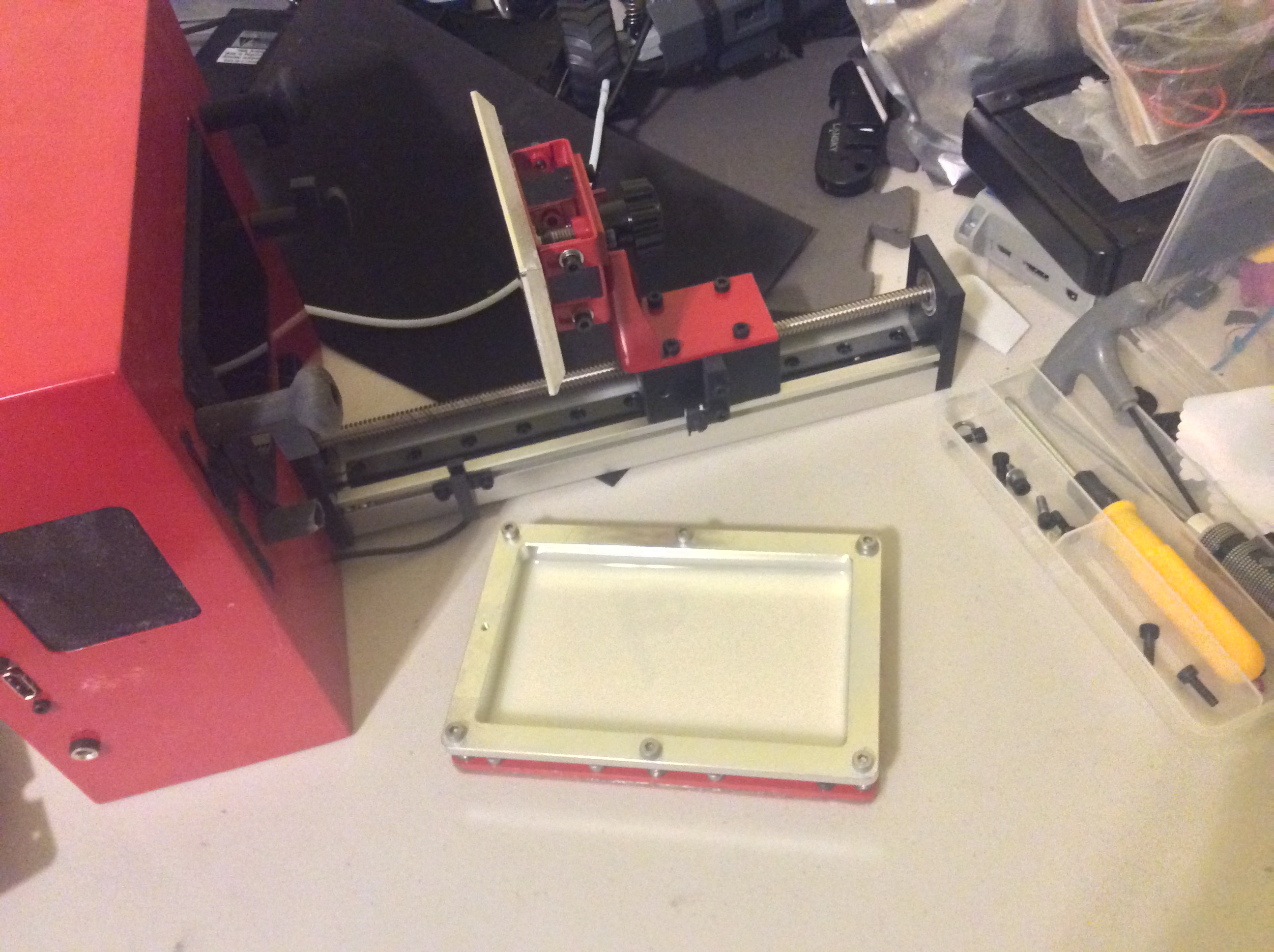

Lastly, a few more pictures of the slain beast. The vat is a flex vat and has dieing resin to trace its life exposed (ok, I just forgot to save it in an amber pump jar).

I know it's been a while, but I've been making slow progress on this machine in my spare time.  I have a FDM printer and laser cutter taking up my time as well.
I don't think this would retrofit to a dlp printer to easily or not easily enough to justify the purchase of this machine. When you consider that you will need new electronics and your dlp project, before we start talking about the upgrades. You would be much better looking elsewhere.
The strongest asset of this machine is that it seems to have an array of 40 1-3watt uv leds that are driven on 15-20 volts (8 rows of 5 leds in series) on a fair large heat sink. They are under powered out of the box. I still need to experiment more to say how serviceable the machine is as an LCD printer.

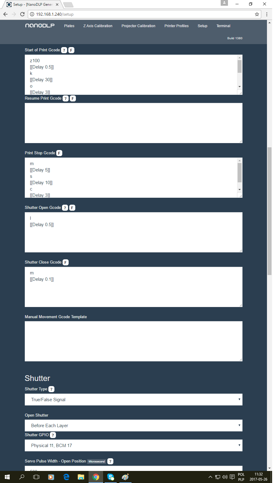

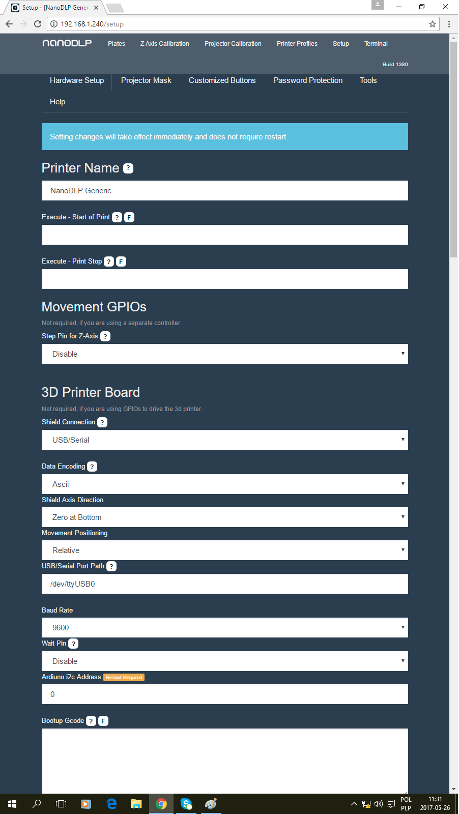

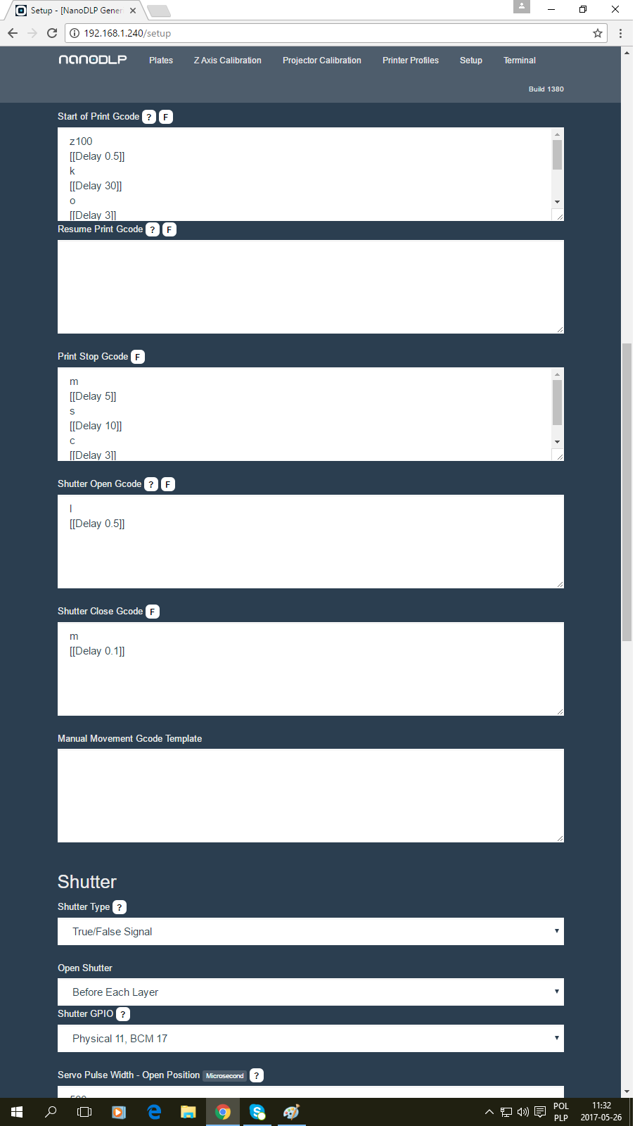

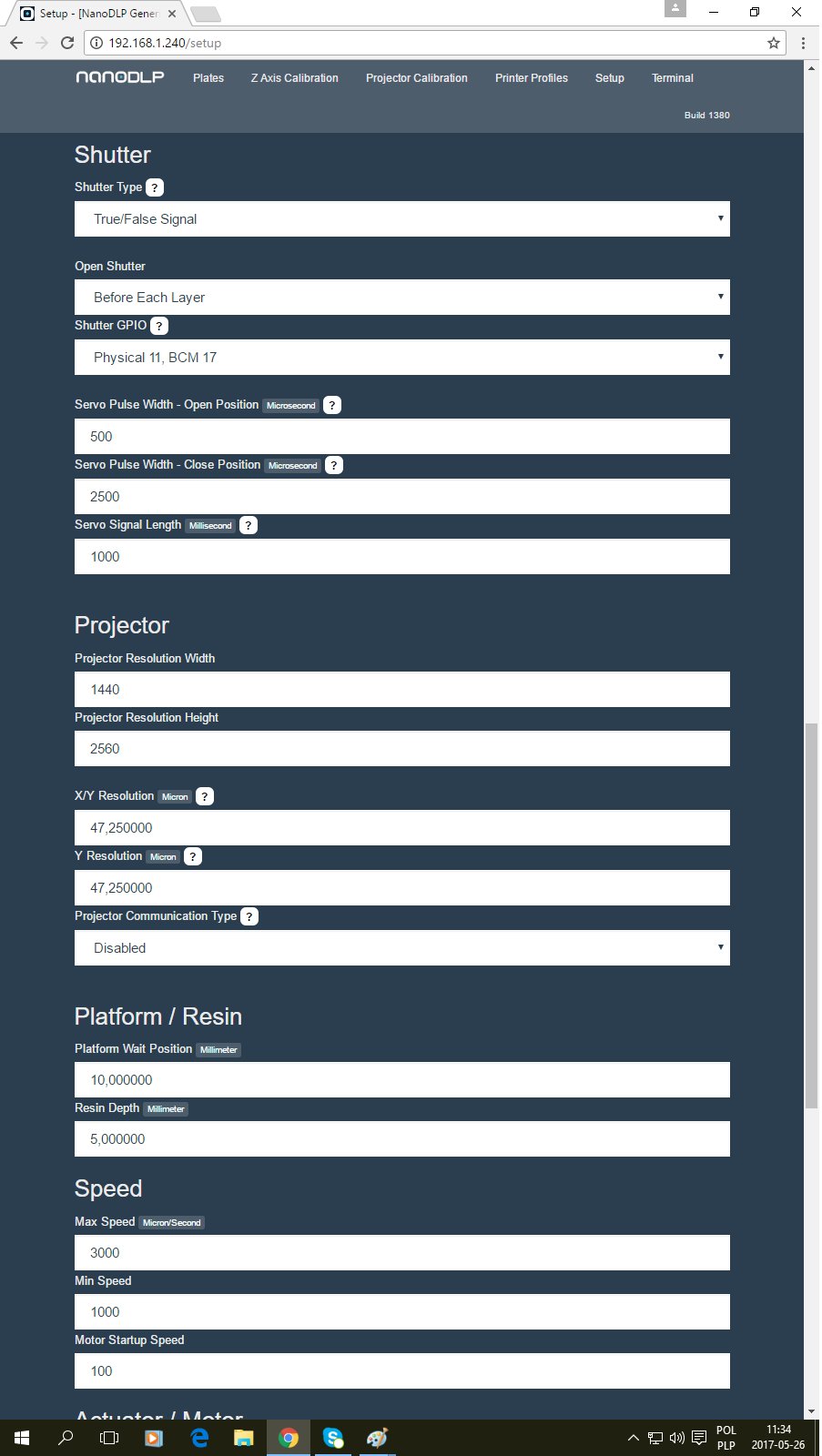

It is a bit tricky for the Chinese driver as it does not use G Codes.
But it is still possible - nanoDlp is very configurable.
The only thing not easilly possible is to get is "end of movement" message, so there are delays instead.

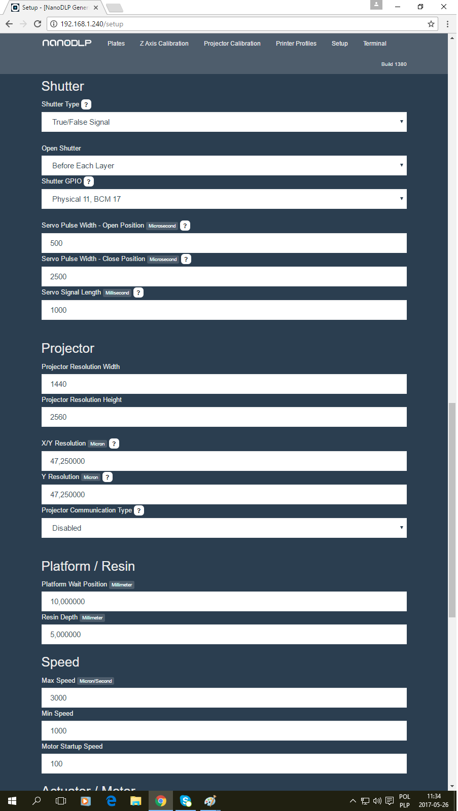

Note that the resolution is 1440 x 2560 , XY resolution 47.5um
I have also fixed motor speed (100% "z100" or homing and 20% for other movements "z20" )
Start of Print Gcode
z100
[[Delay 0.5]]
k
[[Delay 30]]
o
[[Delay 3]]
l
[[Delay 2]]
z20
[[PositionSet 0]]
Print Stop Gcode
m
[[Delay 5]]
s
[[Delay 10]]
c
[[Delay 3]]
g40000
Shutter Open Gcode
l
[[Delay 0.5]]
Shutter Closed Gcode
m
[[Delay 0.1]]
GCODE Before Each Layer
[[Delay 0.11]]
g{floor ( ([[LayerPosition]] - [[CurrentPosition]])*1000)}
[[Delay {abs ( ([[LayerPosition]] - [[CurrentPosition]])*1.5)+0.1}]]
[[PositionSet [[LayerPosition]]]]
[[Delay 0.13]]
GCODE After Each Layer
[[Delay 0.11]]
[[Delay 0.13]]
