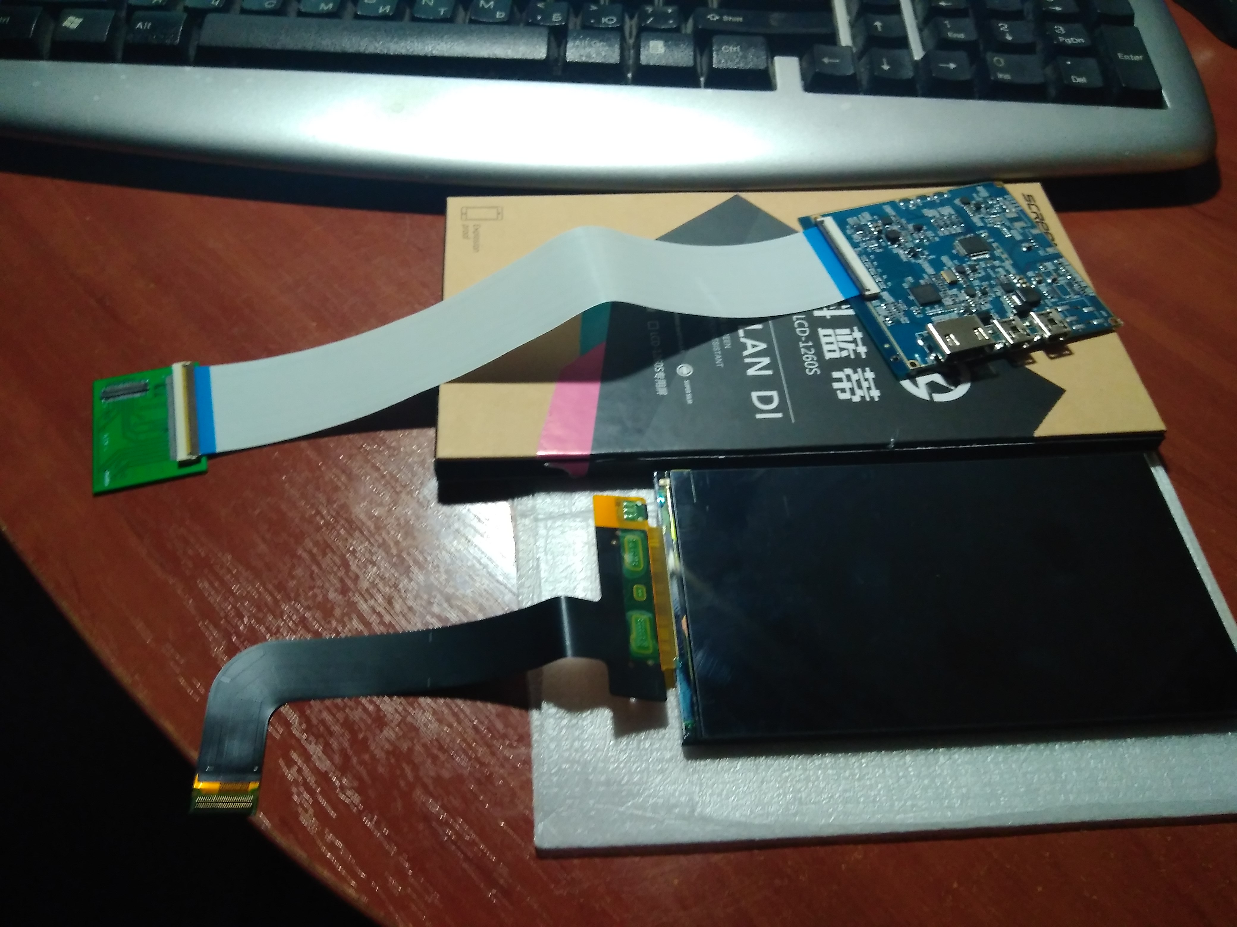

Please, help!
Acquired screen - https://ru.aliexpress.com/item/11-11-Pr ... 010608.0.0. 7ikqoQ
Mipi taken away - https://ru.aliexpress.com/item/5-5-inch ... 17264.html
When the compound is heated and the LED is blinking - the image does not display.
We need to change the firmware?
When connecting the original LSD - everything is OK.
