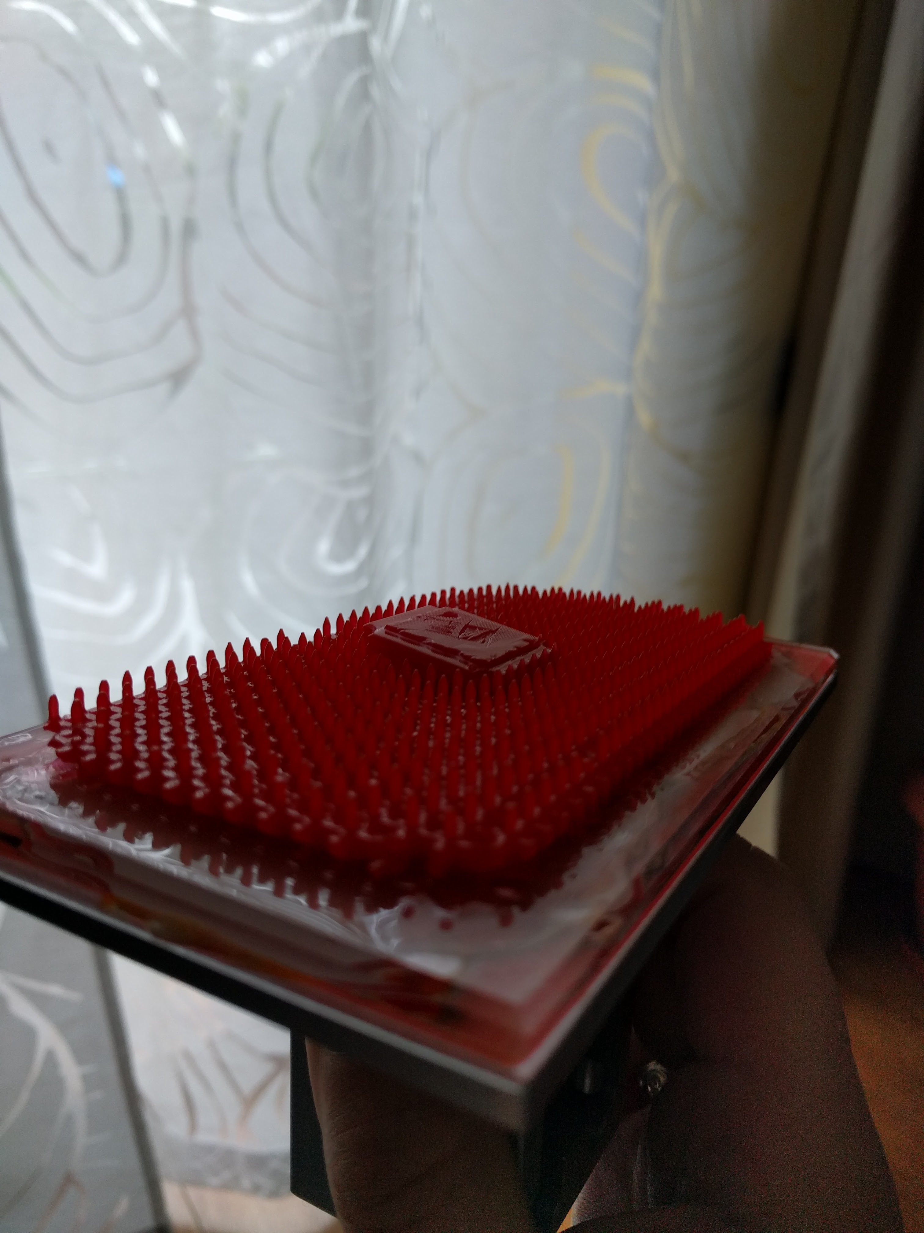

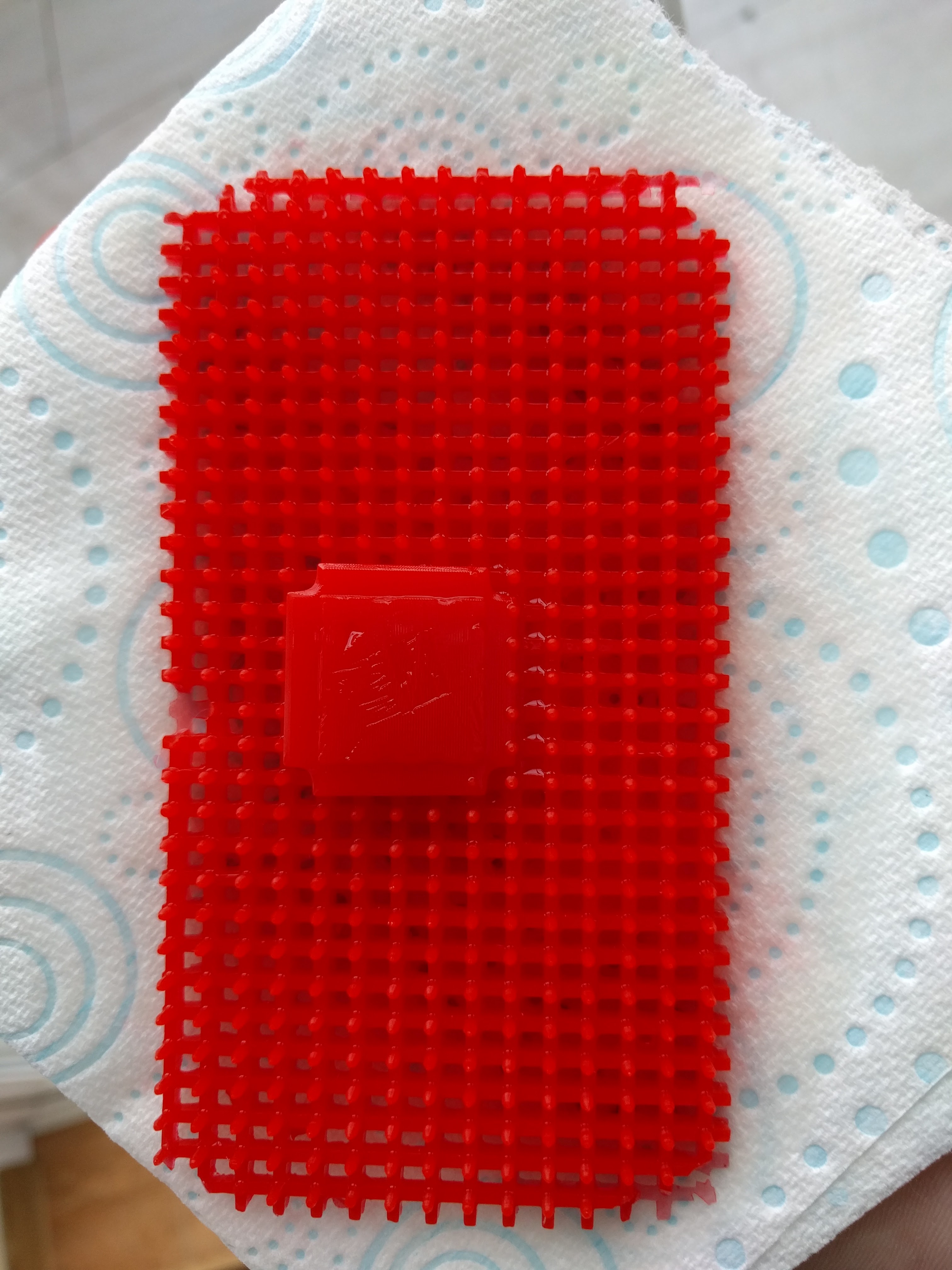

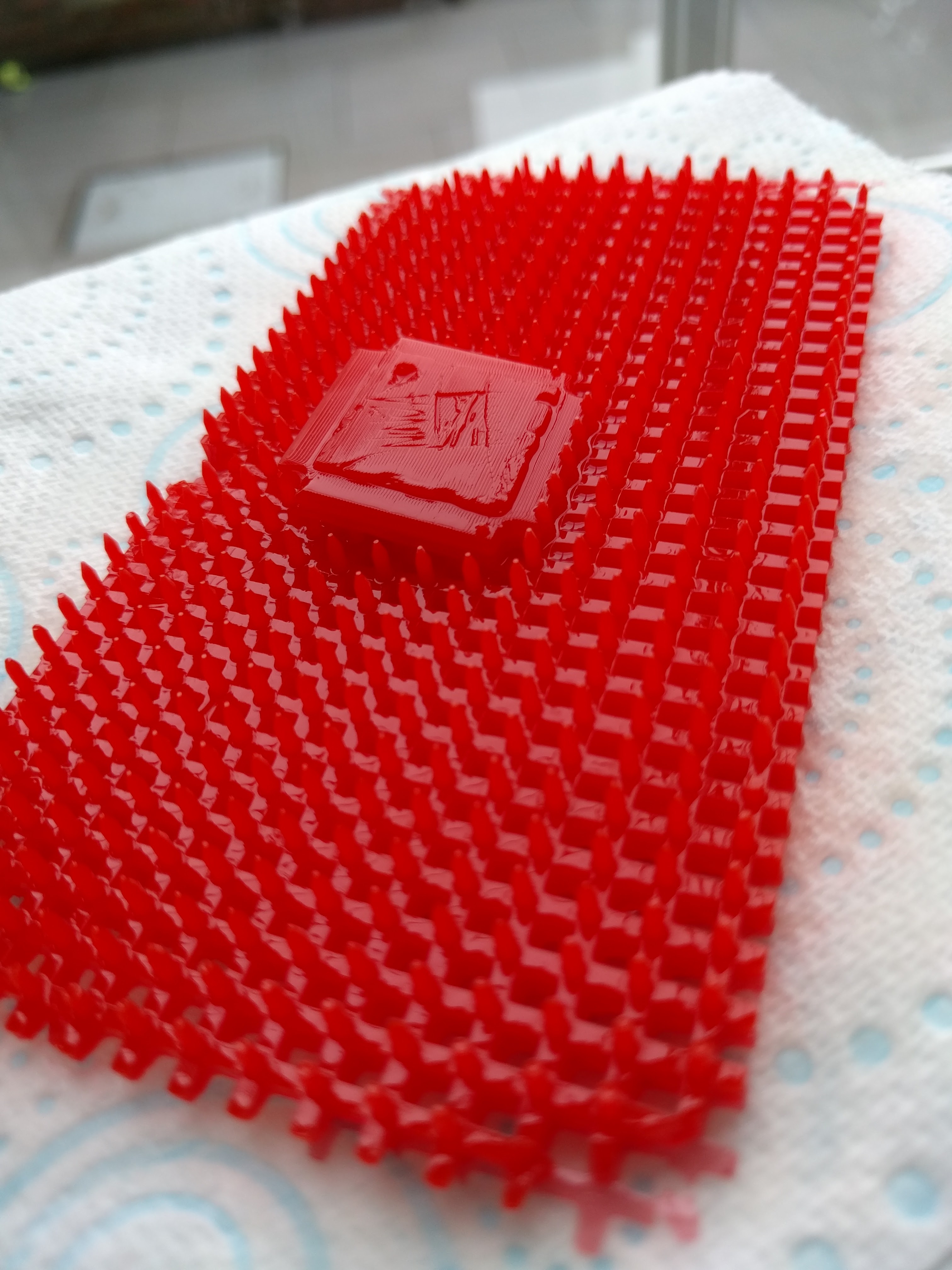

I have tested the heat with leaving it run for 2 mins. I could feel the heat with my hands on the lcd, my guess is that don't go higher than 50W. This is by no means an accurate measurement of the heat, but I think there are no problems with my current setup. Done a print running for a few hours with 5 sec layer times without any issues.
Custom grid printed with the same settings using an image mask. It's nowhere near 100% accurate but the grid is even and I only have problems in the corners which is acceptable for me. The grid has small pins on every crossing and all of them printed fine.

Hi Cabo,
really great to see your experiment, reducing exposure time to 5 seconds per layer is already a great thing!!
cheers,
hp

Hey Cabo,
Great to see the results ! Very encouraging !
..and I agree, unusable corners is expected and do not matter.
