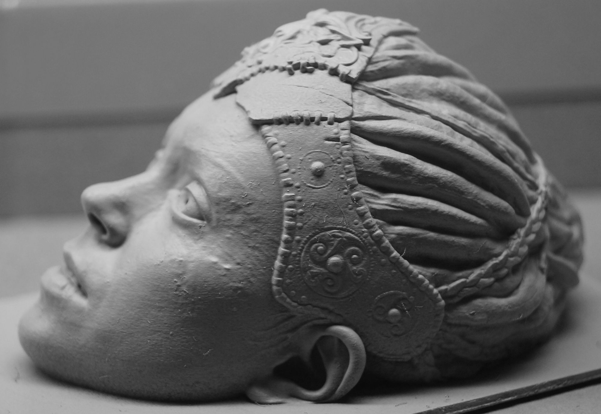

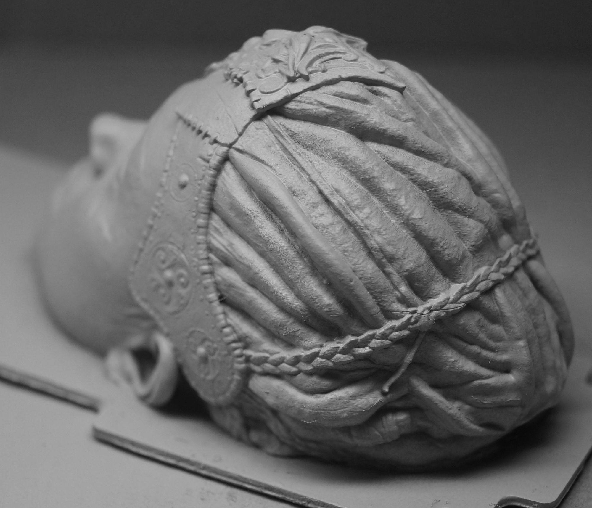

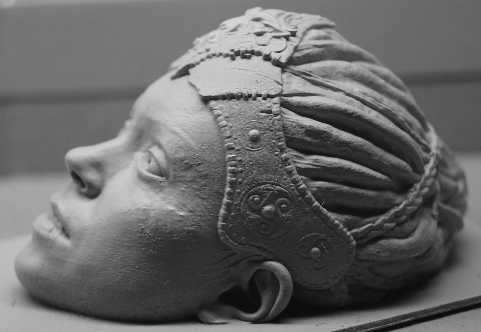

These are my 35 micron printing tests with my modified YHD-101 (50W uv led). Layer time was 4.5sec it was printing for 3 hours.
The base under the head is around 7cm long. Resin is FTD IB primed with a light coat of grey primer.

Great print!!!
Really like the model too...
..is your scan ?
..or a zbrush model ??
//O.

Very nice work

Wow that's a vey nice print Cabo!

Hi Odd, it is a Zbrush model. Made for a game called Hellblade, done by some talented artists at Ninja Theory. I'm working on a bust that hopefully will see the light when the game comes out.
