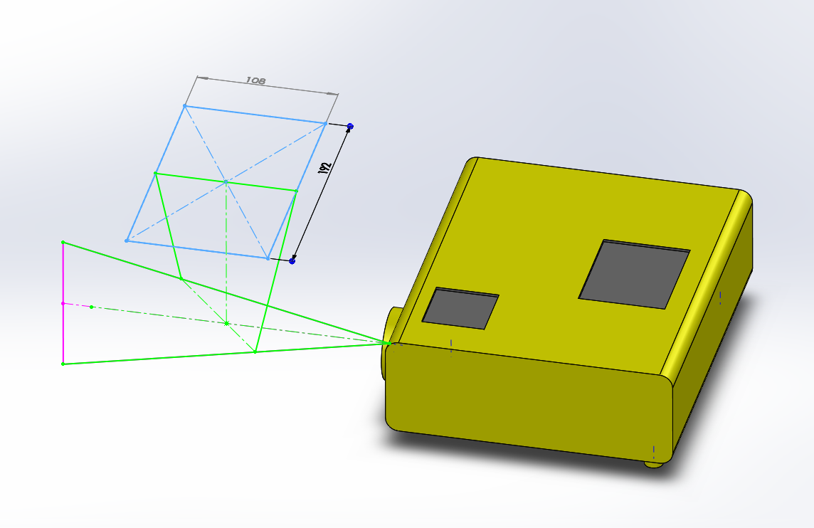

I'm currently on the way to design a rigid machine base and as I want everything perfect on my digital model I got some questions regarding dimension- I don't want to buy a projector before beeing sure that everything is as I want it to be. ;-)
1.) dimension
On this site the focus of the machine at 100x100mm is around 250mm:
http://www.instructables.com/id/DIY-hig ... r/?lang=de
In my eyes I should switch my projector at highest resolution (1920*1080) and measure the distance so that the projected image has 192*108mm: I would to this on both dead centers of the focus to find the mid-position.
To change dimension and focus on the machine hardware I would make the plate hight-adjustable (app +-30mm).

Not sure I understand some of what your asking but since I am building a variation of the printer you have linked to I'll say what I know from my build process.
If your using the Acer H6510BD that is listed on the Instructables the focus for 1:1 (1920X1080) at center on focus and zoom will be approx 225mm from lens to surface.
