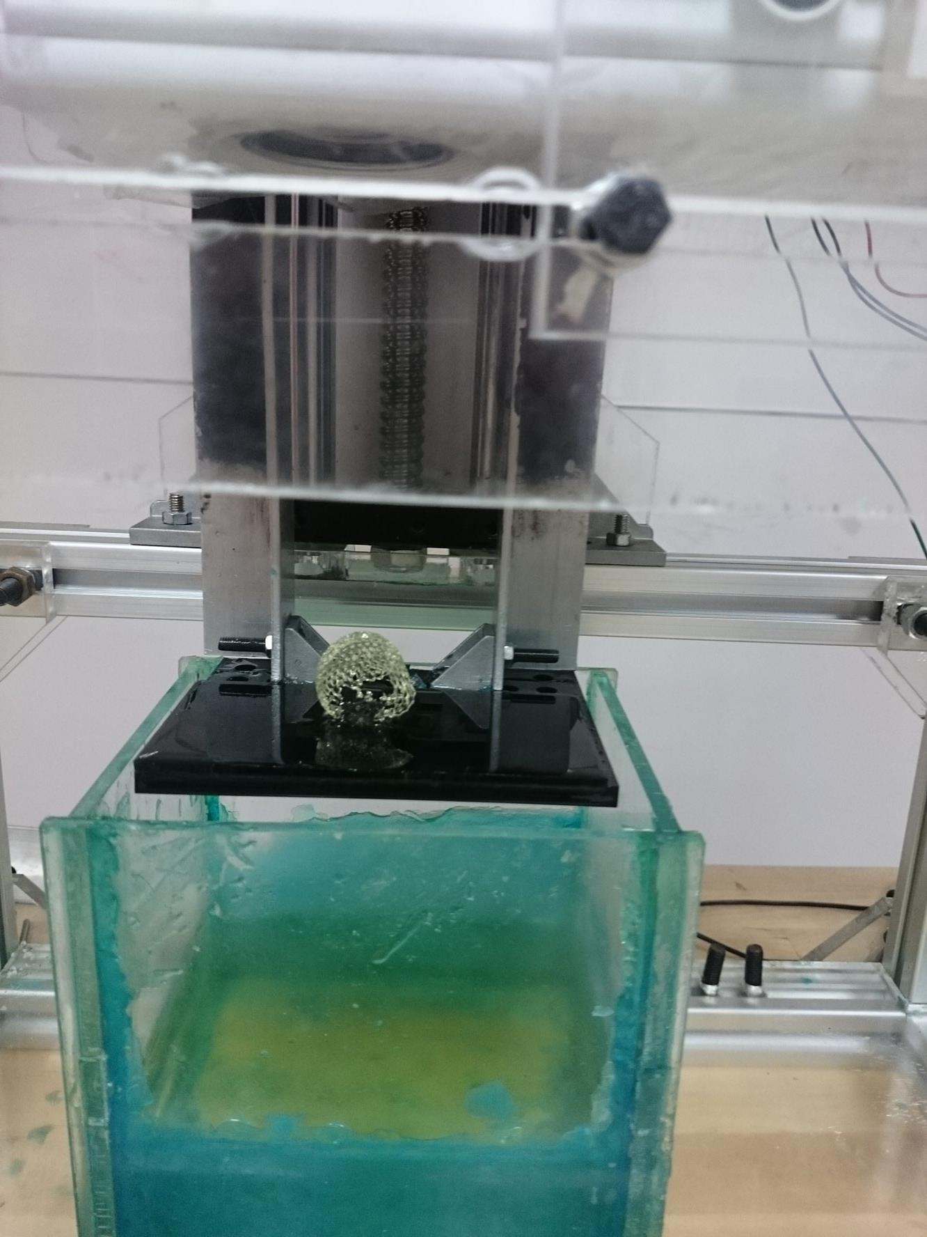

Hi Folks,
i got this failure at my last print as shown in photo.
Resin is LV SpotA
Printing condition:
layer thickness = 0.1
curing time = 8s
bottom =18s
blank = 5s
Z lift = 1
speed = 100
Model: sphere 3x3x3 cm
Top down Failure print

anyone can help to identify this problem ?
SIDRANA
Re: Top down Failure print
It’s Quite clear, that the polymer is contaminated; Or it can be the shelf life of your media and lacks; in exposer, or the subject is out of focus.
