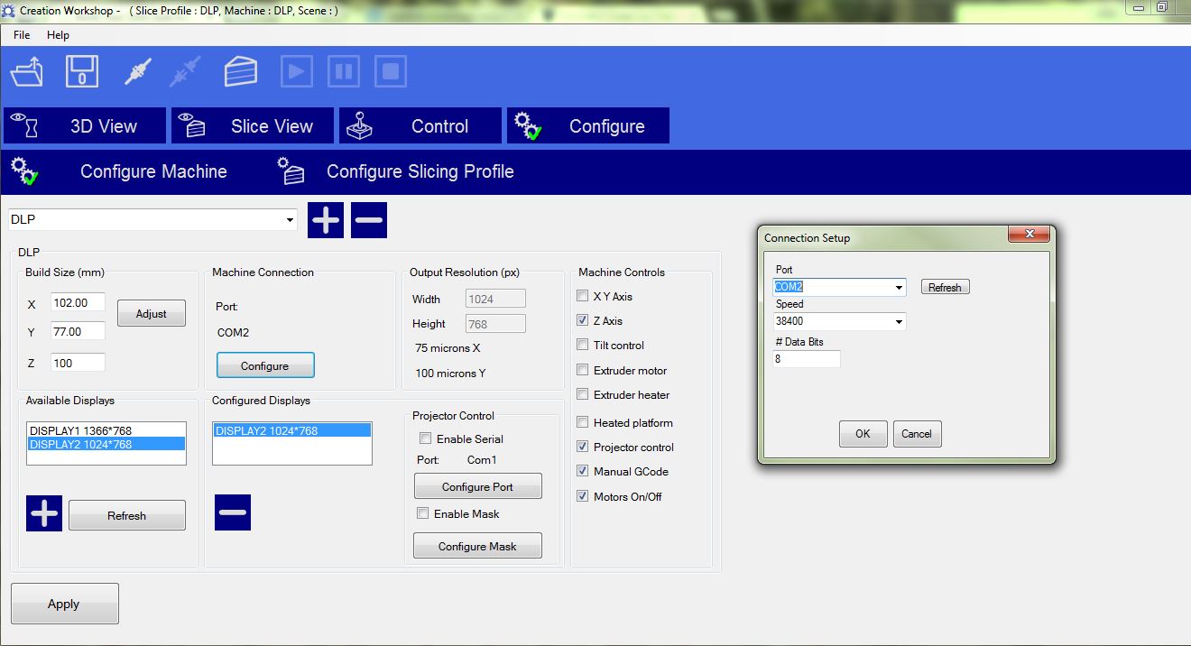

Re: Problems in Projector and Stepper Motor Control
The screen settings for the projector is attached as an image.
I got your point, but why does the projector not project the layer images?
