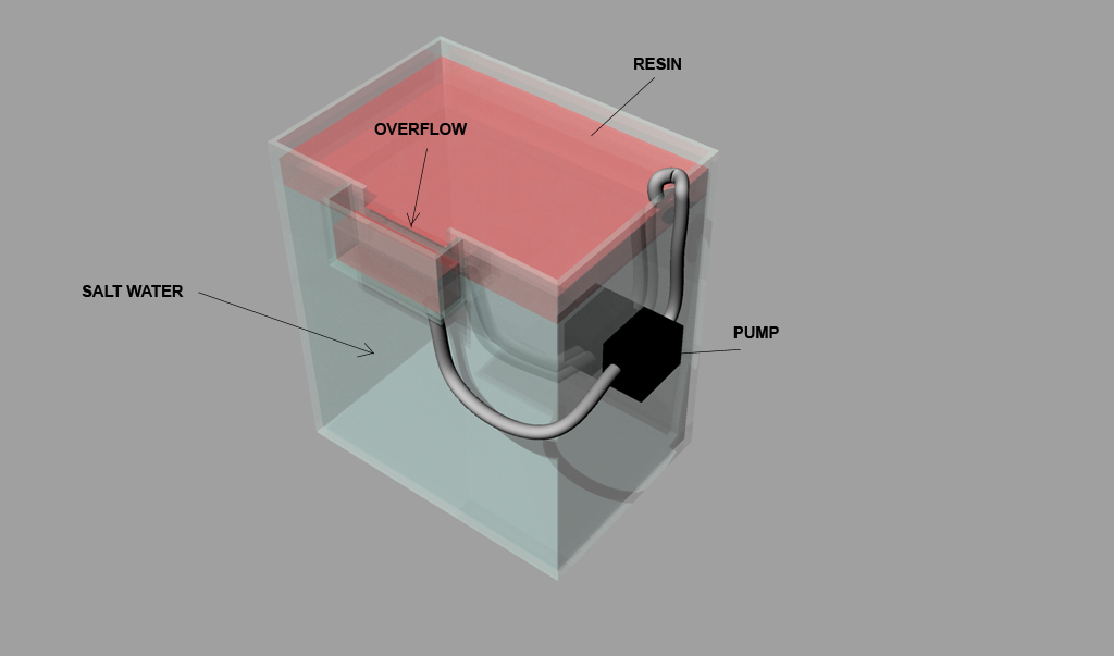

Really bad idea. All you need is cut hole in side wall of VAT and add pump.
Look here.http://roboforum.ru/download/file.php?i ... &mode=view

The pump is a great idea, how come I never stumbled upon it before. But a small issue is raised for all of you who actually tried it, won't the flow of resin from the pump during a print job cause any disruption in the few layers being printed at the time?

You can switch on pump only when z axis moving
