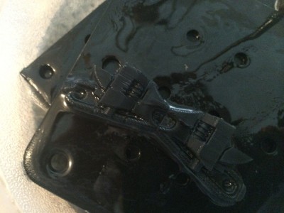

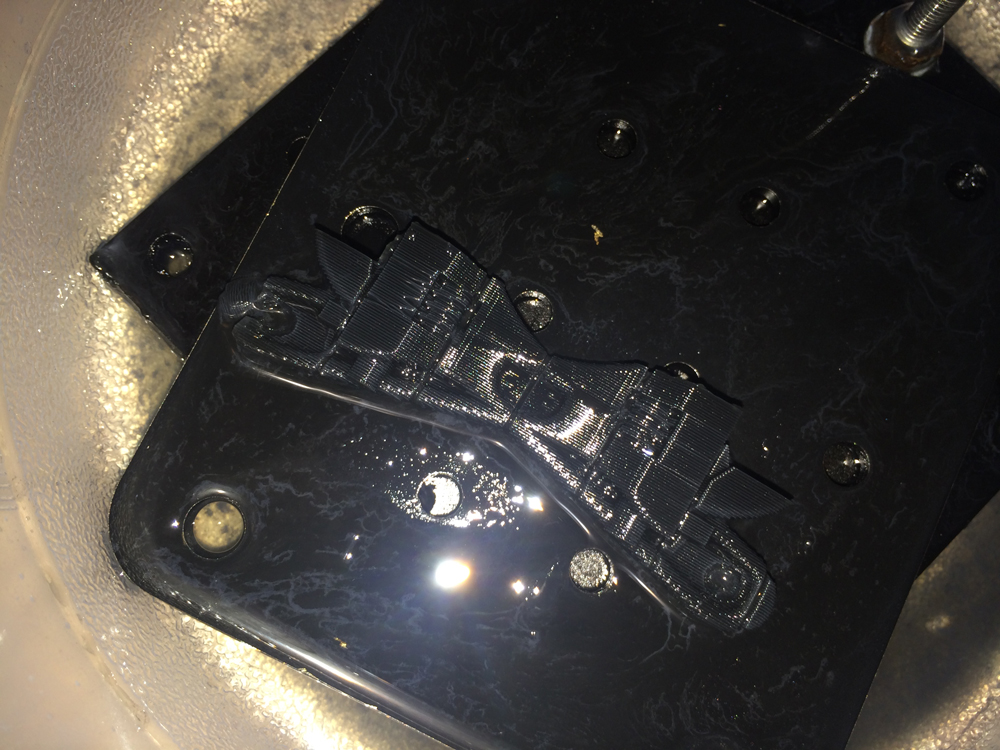

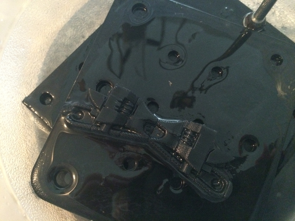

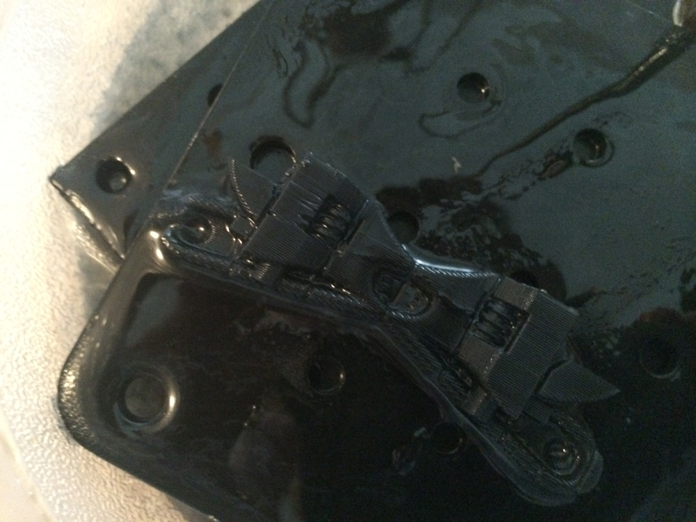

Well... Here's a wrench. LOL
Oddly it printed two wrenches when it should have been one. I'll have to look into that... Also note the lines in the print from the laser scan. Also the z axis went rogue at about 95% and moved down forcing me to shut the system down. This has happened twice on the same stl file. I'll try another to see if it's the file.
Bill

That looks great! The resolution looks really good too. I'd like to figure out what's going on with the second half of the image mirroring on the display.I want to know if this is a hardware problem specific to you, or if it is something caused by my LaserShark plugin.
