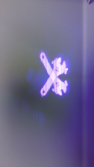

Hey Steve,
Just did a long exposure test with the laser to show the image mirroring issue. Thanks.
Re: LaserShark what i have got working.
Alright, I figured out why the image is being reflected on the X axis. I have a new release for you to test with:
This version has the laser drivers, main CW .38 release, and the LaserShark plugin. This version should fix the X axis reflection.
