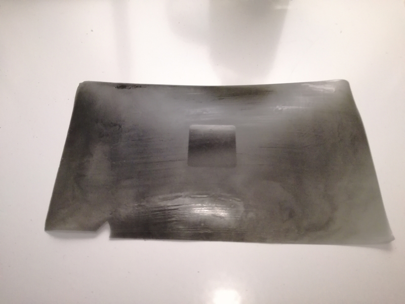

Hello guys.
My first attempt to print was a failure - it seems the entire build plate was cured. Check out the picture. I did a dry run without the tray and no resin and the leds were flickering. Is this normal? I wanted to give it another try but i cannot connect to the printer through the browser anymore.
Thank you in advance!

Have you noticed that platform cannot lift up

i think you shod try to go to the local net on your PC and check out printer.If you cannot find it,allow the net to show you connected devices,And try to launch it from there.If it does not run i will give you the software update wich was given to me by james.By the way,i think they did not connect this board as it requares.There should be 5.5 volt but they give it 12 through resistor
