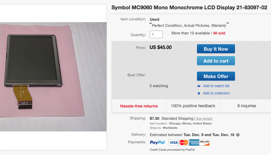

Hi;
I do not know if this stuff is any good, here is an Ebay link, monochrome screen and modulation parts plus cables under different listings, from the same seller.
http://www.ebay.com/itm/Symbol-MC9060-M ... fresh=true
Regards

Nice, though the shipping to me is about as much as the display itself. I'll stick with my $10 colour LCD for now though.

Ah, I see, I forgot about its being reflectively lit rather than from behind. Maybe if there was one which could be dissasembled to remove anything blocking light from passing through it, but that sounds like a goose chase. Thanks, unless my LCD sucks I'm going to stick with it for now until I can get a better one.
