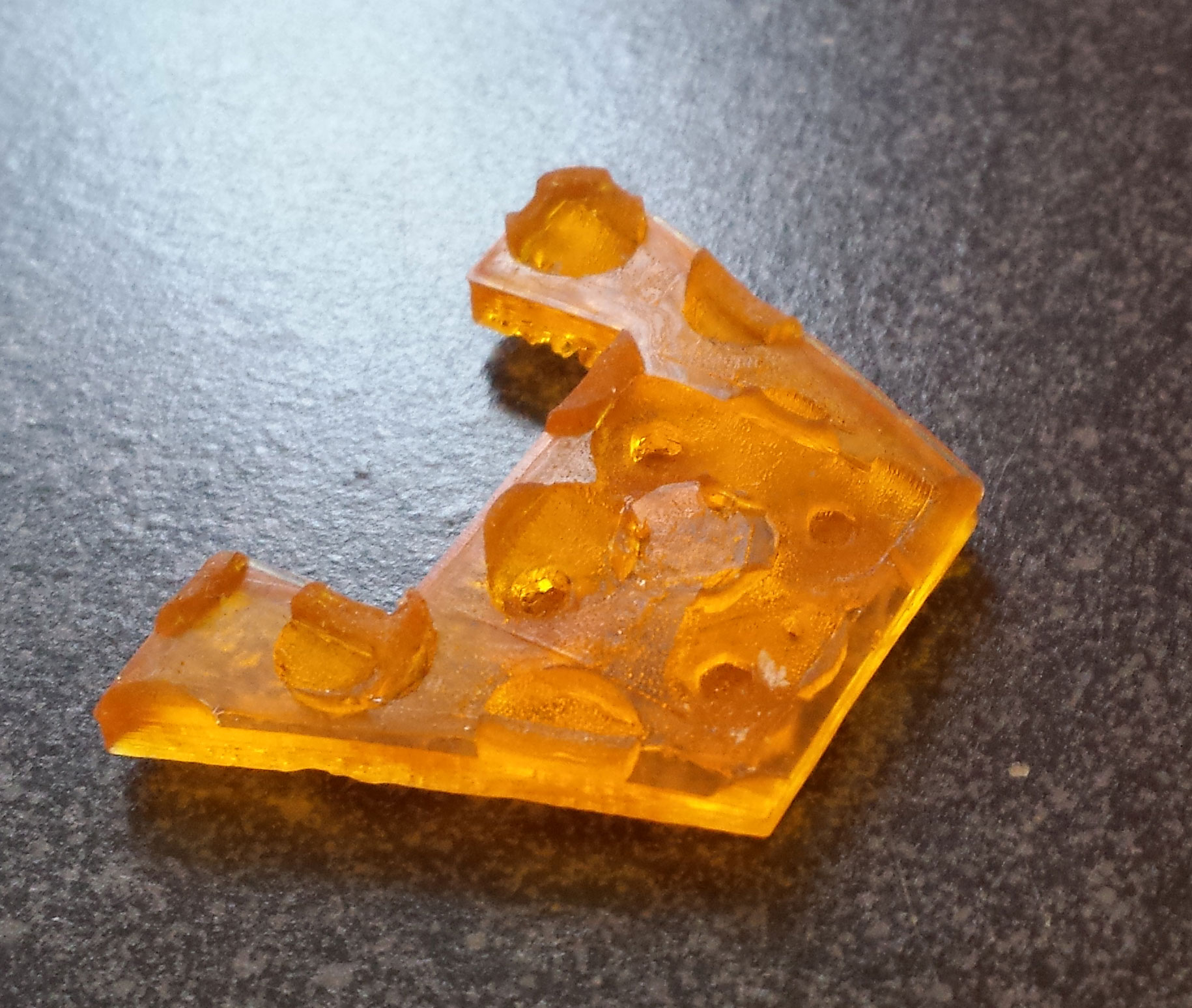

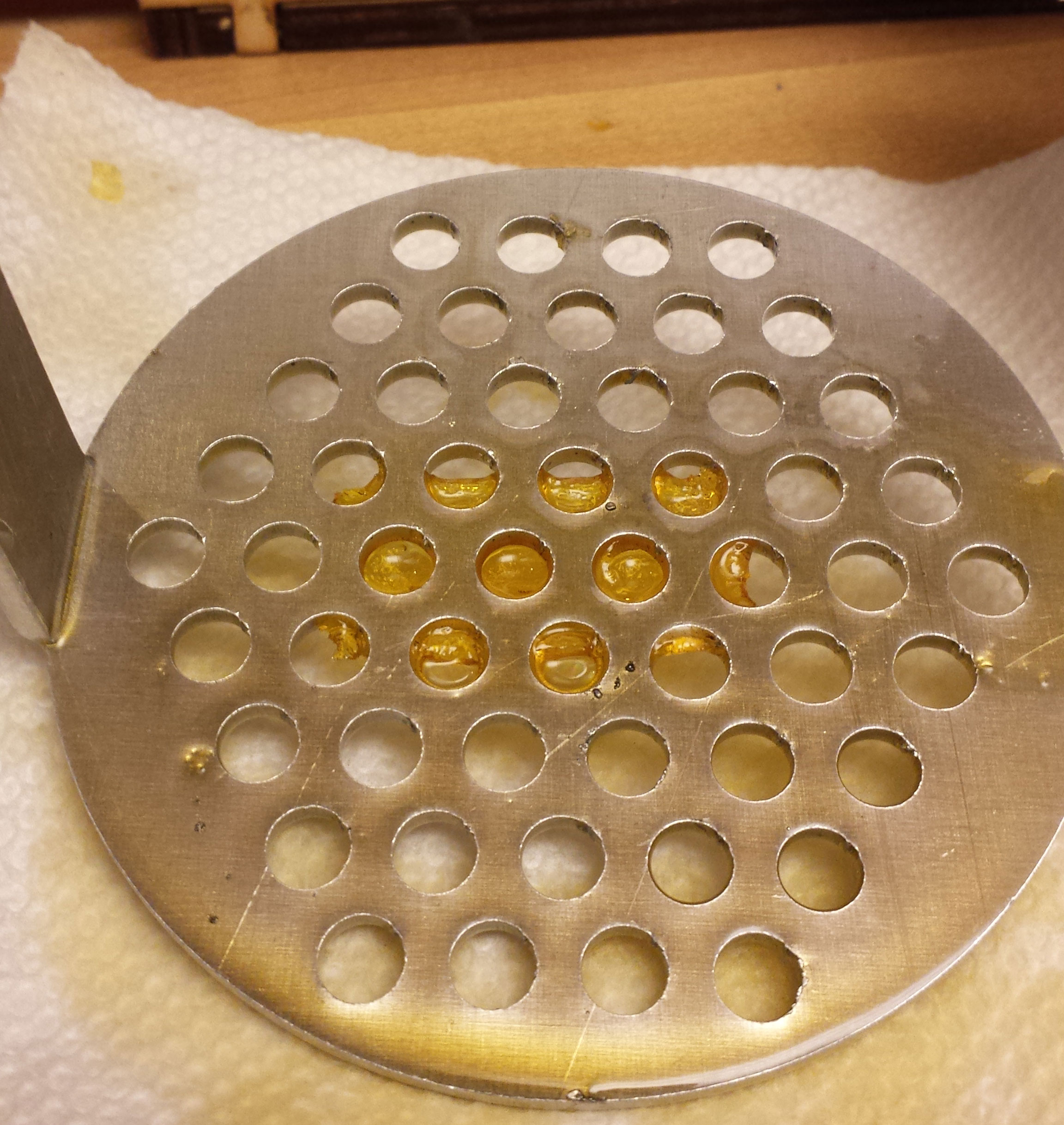

I'm looking for suggestions on how to deal with the holes in the build platform on a top down printer. This image is the bottom of a lego piece that should look a lot different.

I'd suggest floating the object and putting it on a bed of supports w/ a base. Might have some surface defects, but will be better than the large deformations.
