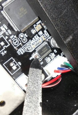

I increased voltage on the step motor... Maybe all your problem is because of this.Or you have problem with LSD(it can flickers)

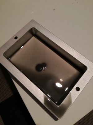

I tried to print the Rook Tower but it got stuck to the FEP. At some point it must have floated away because there are two footprints.
