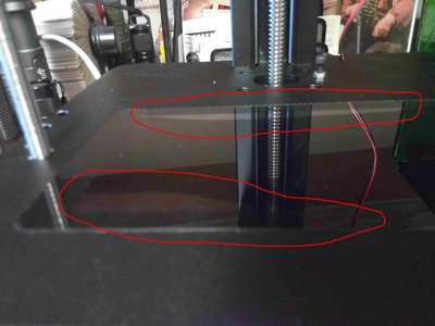

1st. The display is starting to delaminate ? Strange spots appear on the display. Any suggestion, what is the cause?

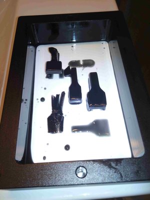

2nd. The printed objects stick to FEP, not to the Build plate Just one object stick to build plate, rest to the FEP.

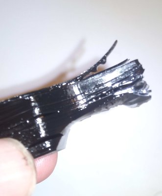

3th. The Objects look like ... Layers not bonded together

 My questions: what is the recommended distance between Build plate and LCD? I set it up to 100 microns (thickness of paper, -  measured). Then inserted the VAT with FEP (FEP has 100 microns too.) So, theoretically the Build plate touches the FEP in VAT.
Any suggestion will help.
