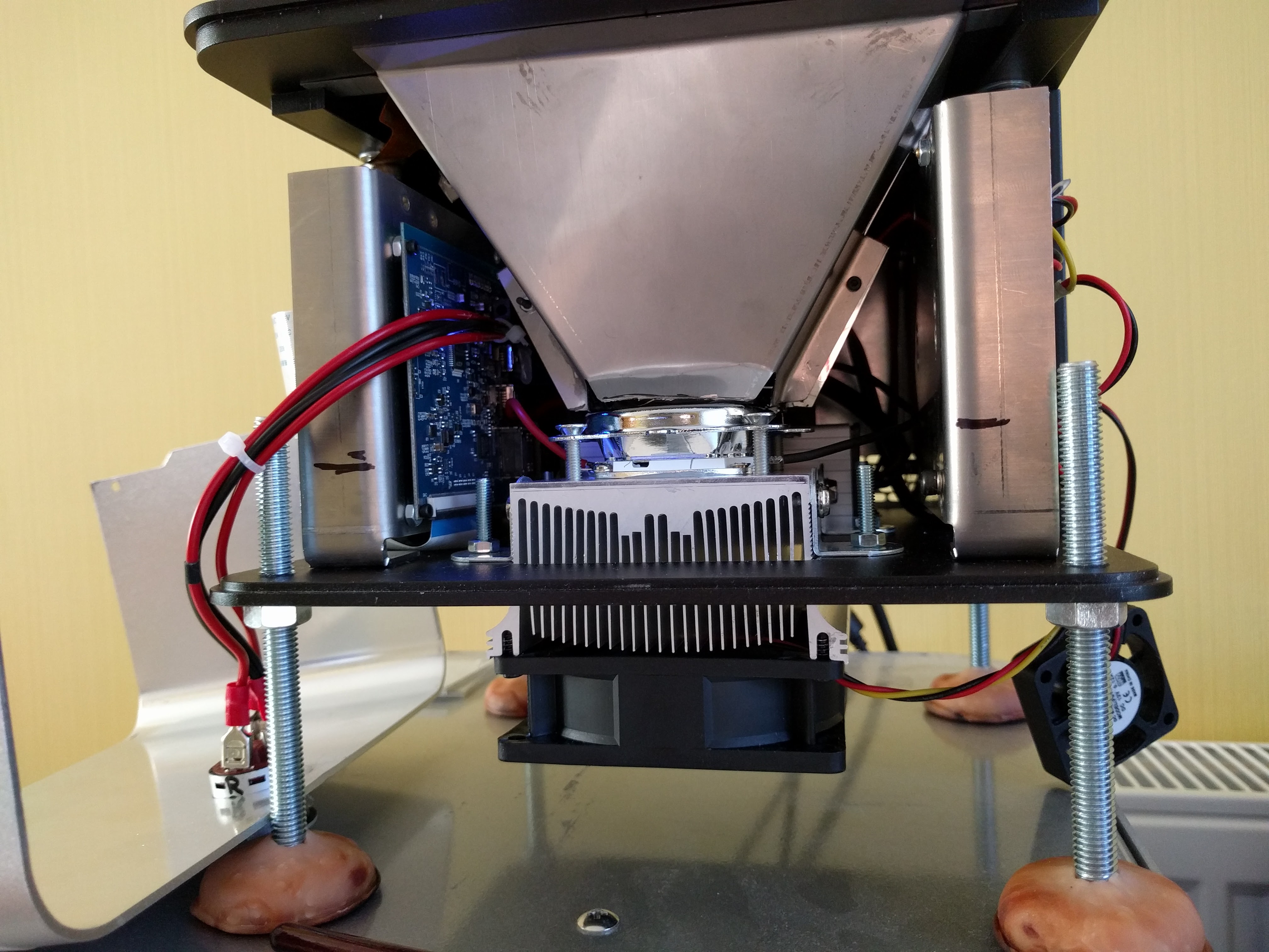

Cabo
- Posts: 16
- Joined: Wed Sep 09, 2015 8:06 am [phpBB Debug] PHP Warning: in file [ROOT]/vendor/twig/twig/lib/Twig/Extension/Core.php on line 1266: count(): Parameter must be an array or an object that implements Countable
This is the fan+lens: http://www.ebay.co.uk/itm/252683611628? ... EBIDX%3AIT
Led driver: https://www.aliexpress.com/item/10W-20W ... 0.0.1hxgpK
50W Led: https://www.aliexpress.com/item/High-Po ... 0.0.1hxgpK
I've cut a bigger hole on the bottom to fit the bigger fan and added taller legs to allow for the extra space needed.
The image is a paper over the LCD, it is a bit uneven, but nothing too extreme.
