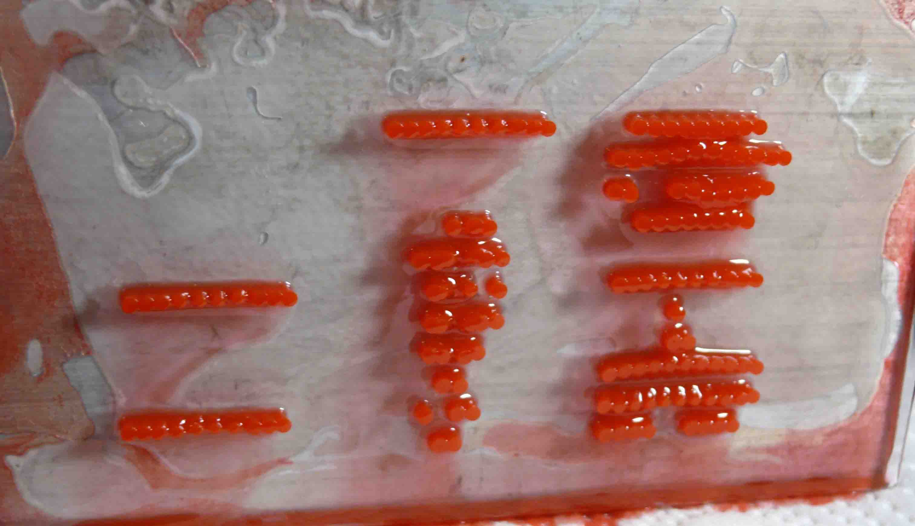

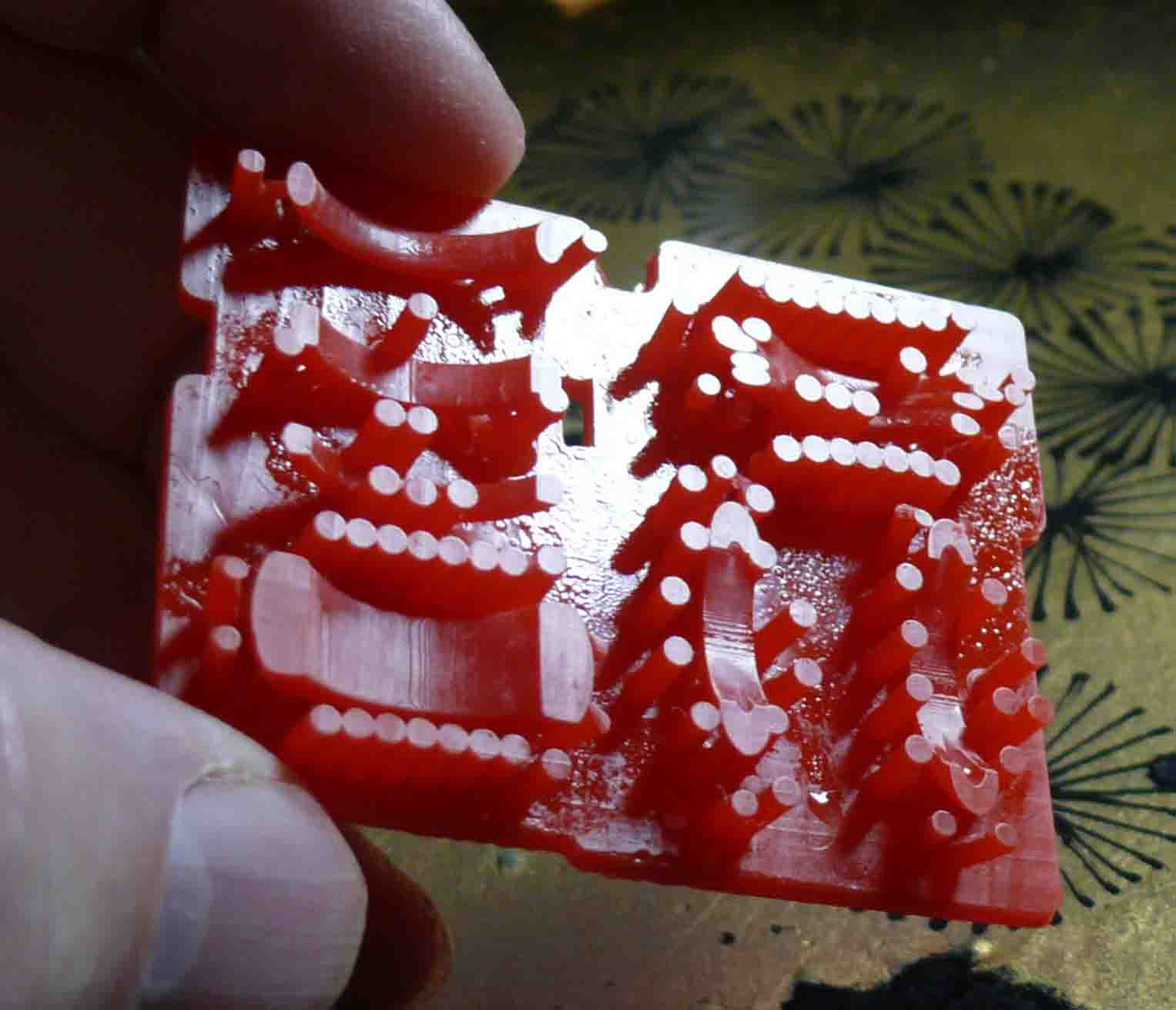

OK folks I need your help with this printer. I've only been able to do one successful print and I posted those photos here. I used the same settings that I did with that first successful print and I've tried to use the same settings and different setting in order to replicate that successful print. I've tried at least 150 times and this is all I get photos below. I've even adjusted the bed settings but ZILCH! And each time I try a print the supports print but it stops there and the rest of the print is at the bottom of resin tray. Now my one and only successful print was done at .025 resolution and 7500 seconds of exp. I did the same settings and nothing, tried higher exp. and lower resolution and nothing! So please if you have any suggestions let me know.
Also I thought the software might be corrupt so I even reloaded that.
It appears that it will just print the 3MM's, and after that the machine continues it cycle until completed but nothing more than the 3MM is actually printed.
OK trying another print I'm raising the bed 6MM from 4MM to give the resin a few extra seconds to flow under the build plate. Hopefully that will fix the problem, print will take six hours let you know then.

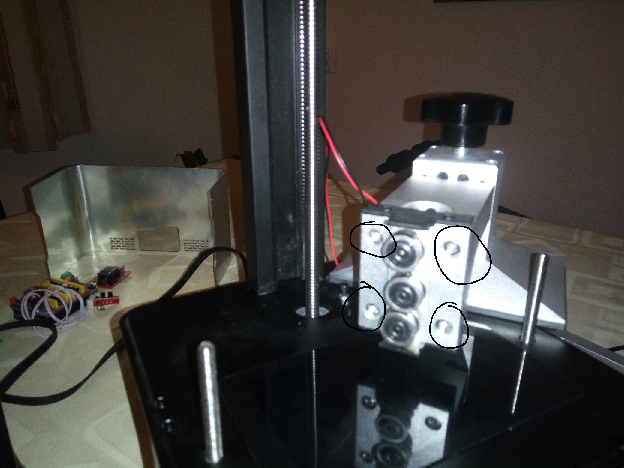

goldi80
- Posts: 56
You need to make smooth Z axis unscrew linear guide and align build plate whit lcd .see photo screws .
You need align LCD and Z axis gold nut( together).
This will fit you will need to make bigger hole.

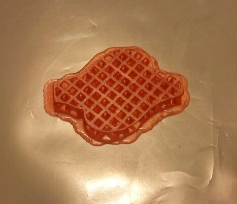

russiangems
- Posts: 46
This is my latest print and as you can tell it stopped at 5/16 of an inch! Or as I should say it stopped attaching itself to the resin at 5/16 of an inch. You will notice the print is very detailed and flat on the top so my 3D printer is set perfect! But again it stops at 5/16 of an build. But the printer continues to print onto the bottom of the resin tray until job is complete. So my guess is the Z-Axis is screwed up at the 5/16 mark, but for some reason it might also be the ramps. Do you all have any ideals? and if I replace the Z-Axis with a Lead screw where would I buy one for this machine?
Let me know your thoughts, and thanks.
Merry Christmas to you all.
Just did another print and its perfect but not complete it stopped at 5/16 of a inch and the rest printed on bottom of resin tray.
Time to upgrade this machine with new parts!
Folks I have come to the conclusion that this 3D Printer is a piece of junk, and it would be a waste of your money to buy one.
I'm going to box mine up and send it back for a refund, 200 hundred hours of my time waisted trying to get this machine working!
