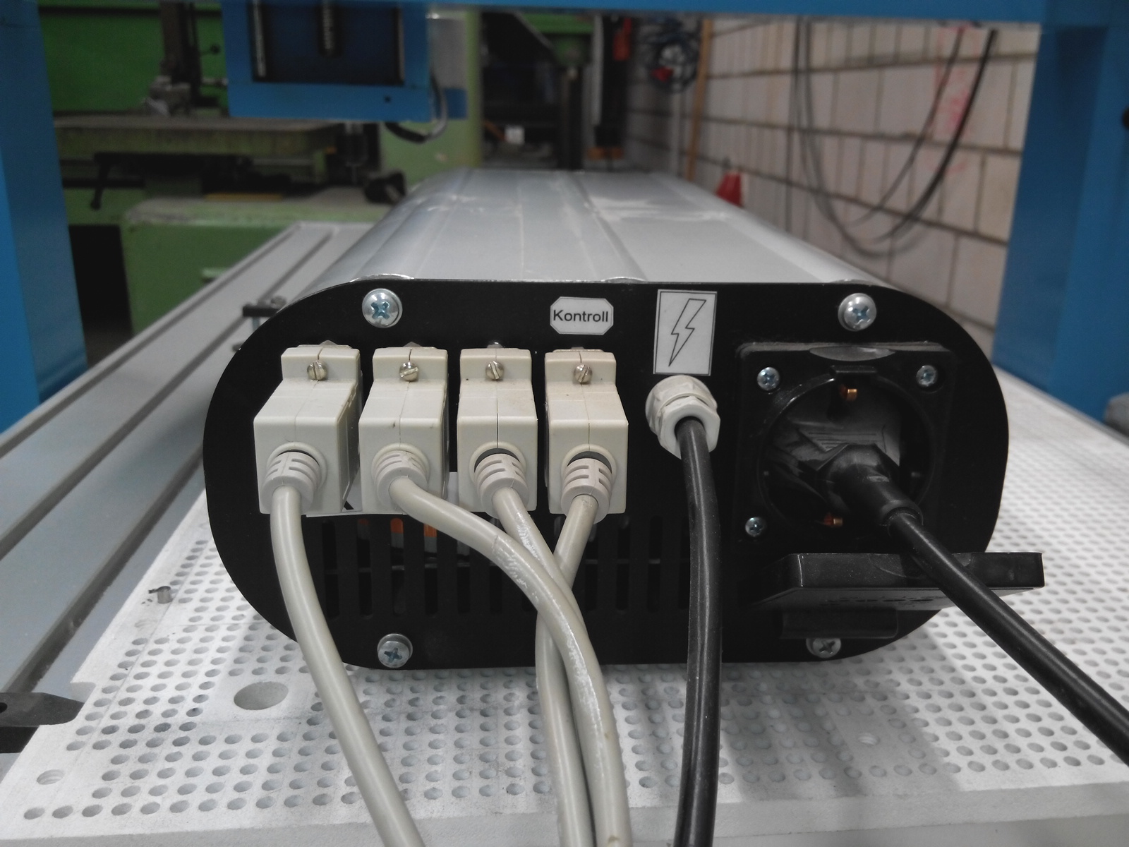

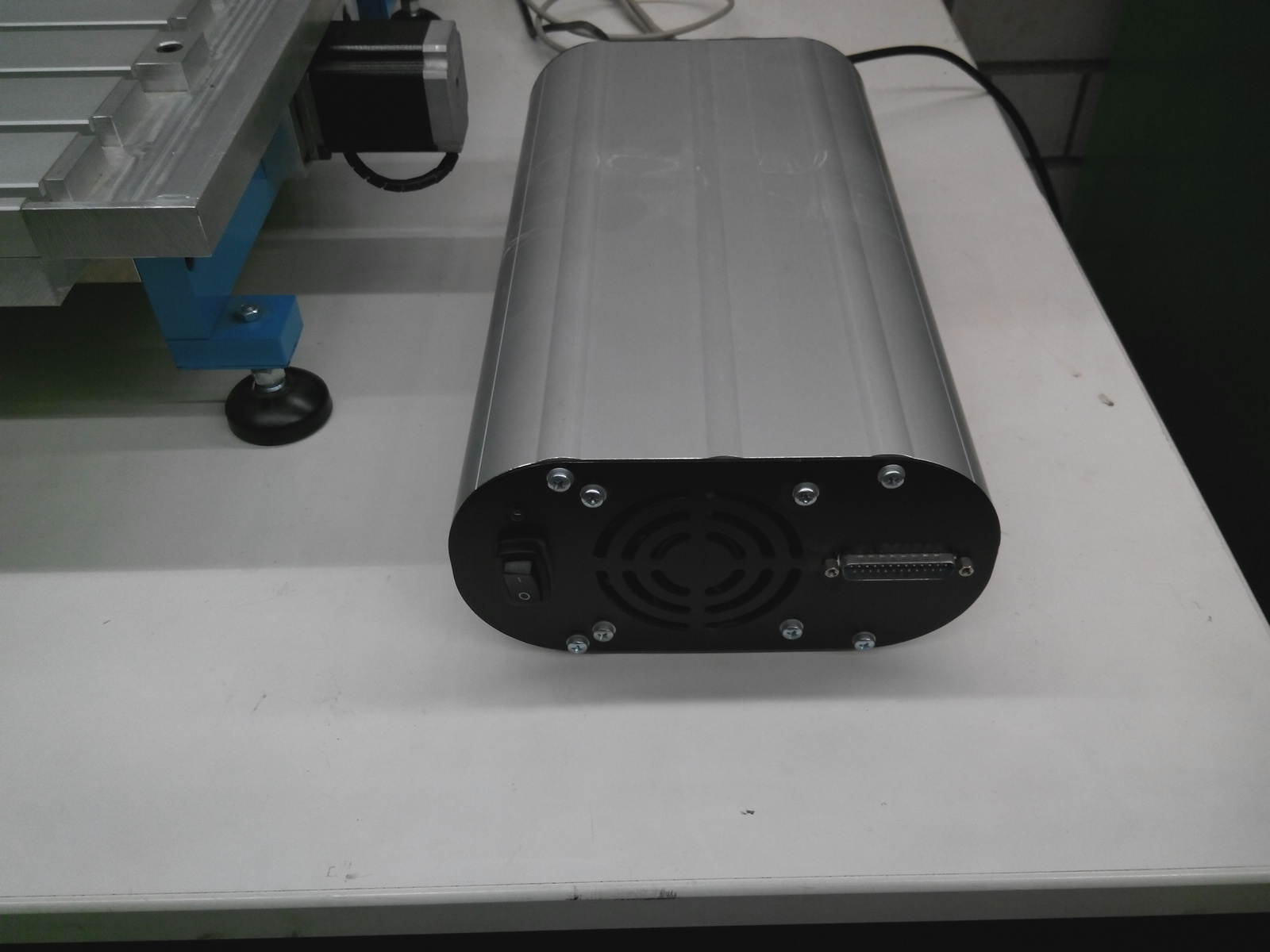

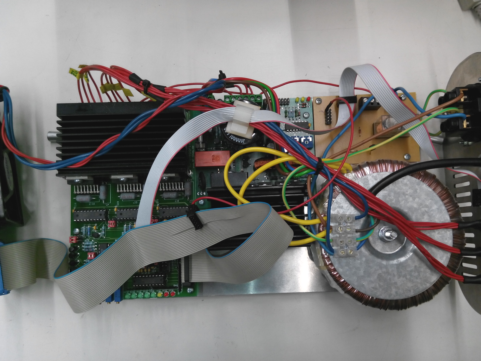

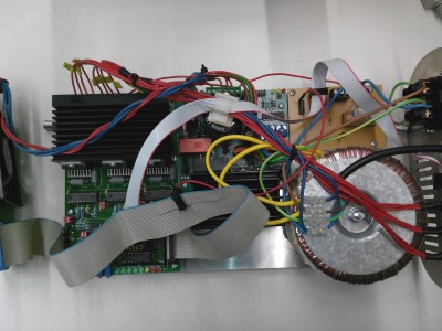

So serial means CW doensn´t support stepper driving via lpt port, it "just" works with usb connection?
I´ll upload some pictures of the control unit. this control unit is connected via the lpt port to a windows pc which runs the software called WinPC-NC. I even have the dongle for the software, my problem is the machine was delivered without software and now the developer wants me to pay 40$ for a CD with the software.
at that point i asked myself if CW could handle such a task

Re: Can CW be used for CNC machining?
I bought Mach3 some years ago, and it is very good, you will need a pc with parallel port, which I think you have already,
the other option is linux cnc, used to be called emc2, I have only dabbled with it because mach3 is available.
I have been building and using cnc's for over 25 years and mach3 is the best I have used for home use, I have no connection
with them, just my opinion.
