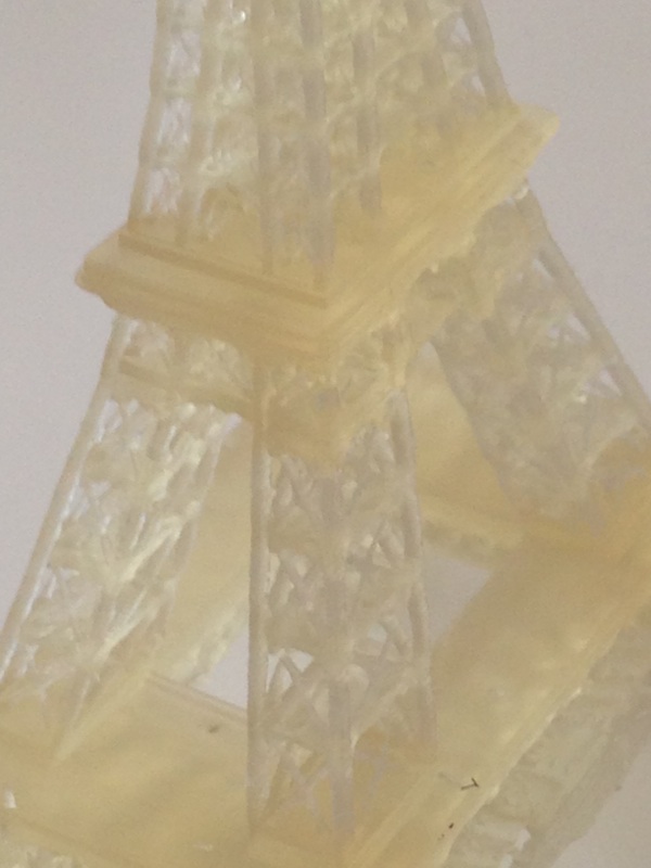

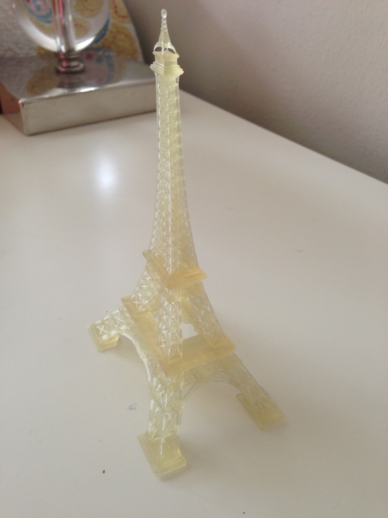

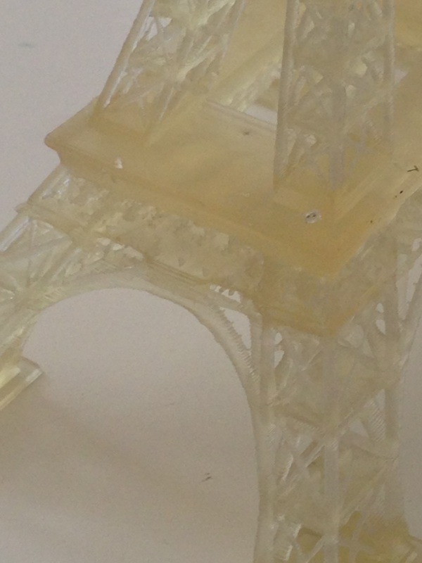

Well I finally we able to get my first print. I didnt do any calibration other than trying to figure the cure thickness. This print was supposed to be square but came out as a rectangle. I am assuming it is from the monitor settings. I thought the software corrected for this? What is needed to make the image square again?
Another issues I have is the quality of the print. There is a fuzzyness to it. And not all the small objects are coming through. The X cross bars are not allways there.
