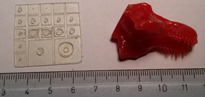

As for the SolidRay, I have to say I'm quite happy with it; here's a pic of a couple of prints with MakerJuice (clear) and FunToDo resins (red):
As you can see, the Makerjuice resin is still a bit wonky but the FunToDo is fine with the kitprinter3d guys settings.

I've allready started printing with the solidray flexvat profiles and my first print came out superb!! My second, third and fourth made me think that I did something "wrong" in the first one... what a mess!! I'm in the 11th test and still thinking that I wan't to start it all over again...
It seems that around the object I print, resin gets also cured in a non uniform way... this happens after printing some layers, the next ones, came out with those surroundings. This made me think that the projector (p1500 acer new), was over exposing the resin... how? well, it sends a strong beam of light with the section shape for some seconds (that seems ok to me) and after it stops. the platform goes up and down... but the thing is that there is still a light coming out from the projector (is this normal?), that could be responsible for the over exposed resin. Do you have any clue about this? does this have to do with profiles?
