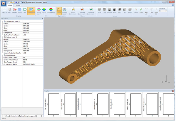

Autodesk’s “Within” Could Generate Industrial Change
Posted Jul 20, 2015 01:00 pm
Autodesk introduced a new product called, “Within” that generates lattice structures within 3D models. It could change...http://www.fabbaloo.com/blog/2015/7/18/ ... -116537121
